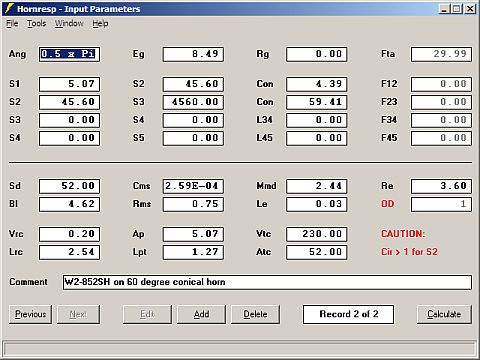

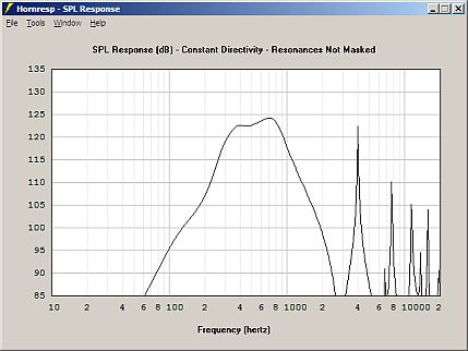

Here's some new (and better) models of my Tang Band mids for a Unity horn.
If you want to build this horn, here's the details:
#1 - This is a sixty degree conical horn. The mouth is 30" in diameter (twice as big as my Summas.)
#2 - The throat has a diameter of one inch.
#3 - There are four midrange holes. Each hole is located two inches forward of the apex, as measure on the EDGE of the waveguide. In other words, just get a ruler, measure out two inches from the side, and DRILL THE HOLE!
#4 - The waveguide holes are half an inch deep and half an inch in diameter. This is a huge deal, seriously. If you change the depth or the width, the whole design will go to hell. Modifying the diameter OR the depth modifies the shape of the midrange response. In other words, modify the holes at your own peril
#5 - The most important parameter of all is the impedance curve. We're dealing with VERY small volumes of air here kids; it's literally impossible to build this thing properly unless you can measure the impedance curve. The impedance curve will show you if you have leaks, it will show you if the volume of your chambers is wrong, and it will show you if the holes are sized properly. Basically I recommend that you modify the air volumes and the hole size until the impedance curve looks correct.
Attached is a pic of the predicted frequency response.

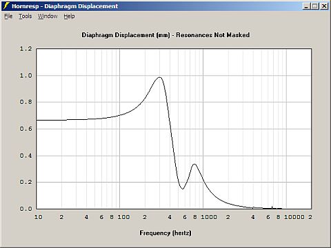

Attached is a pic of the excursion. Unfortunately we run out of excursion with five watts into each driver 🙁

Attached is a pic of the horn response parameters. Note that these values are based on four of the TB woofers in series-parallel. If you built this yourself you'll have to divide the rear chamber and the front chamber volume by four. The model demonstrates that we're using a sixty degree conical horn, and the entrance holes measure 1/2" in diameter by 1/2" in depth (a total of four holes, one for each woofer.)

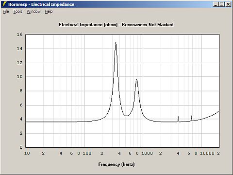

This is the most important graph of all, the graph of electrical impedance. If you build this horn, you MUST modify the front and rear volumes to produce the impedance curve illustrated below. A design like this is SO COMPLEX that you absolutely MUST tweak the variables until they match the model. The most important part of this graph is the trough between the peaks; this trough indicates where the enclosure is resonating.
