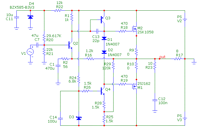

From John:
We need a compromise Nico - a bootstrapped CCS!
You can achieve this, it ain't so difficult.
String a high value resistor from emitter of the CCS device to output. That should do it.... arrange the resistor for a small 5% of current through the VAS.
For an 8ma CCS and 50V rails, choose R = 120K.
This will raise and lower the VAS current with signal level, injecting some H2. It will cost some resolution, of course, but it will have other effects you may like.

AKSA said:
John,
No, not this variant, but I've bench tested it, and it works fine, and I use a variation in the AKSA to power the LTP.
It increases distortion, I won't say more than that.
Hugh
Hi Hugh,
I simulation what you suggested and contrary to popular belief it had the opposite effect, it actually improved THD by a fair margin especially at higher frequencies with almost an order of magnitude at 10kHz.
Feeding back directly on the emitter of the CCS proved a little less effective than feeding back into a split emitter resistor as shown below. At low frequencies <100 Hz there were no improvement.
This modification is sort of localized negative feedback into the CCS which IMPROVED the THD not worsen it.
I think there is merit in Hugh's "bootstrapped" CCS and should be investigated further.
Nice suggestion Hugh :worship:
I would like to make the mods on the actual amp now, but unfortunately things are a bit hectic before the Southern Hemisphere shuts down for their summer holidays. :cheers:
Nico

Hi Hugh,
managed a few moments this afternoon to make the mod to the CCS and only had a few minutes to listen to it before having to do the grocery run with my wife before the holiday makers flock in their thousands to the coast were we live.
No comparison yet, just this amp and it sounds quite fabulous, the slight "tizzyness" is gone completely.

Hugh sorry I did not conclude your 120K suggestion. Adding the resistor reduced the 2H significantly. Well, by about 8 dB, which reduced the overall THD.
However, without the resistor the harmonics raised steadily with increasing frequency, but with the resistor the higher order products increased at a lower rate with higher frequency.
Okay that probably does not make much sense, but if I could explain this in RF terms, it would appear to improve the third order intercept point or maybe reducing the OLG. It is not feasible to measure the OLG of this circuit since the input transistor emitter is derived from the output.
I think one should also bare in mind that harmonics are not treated as individual signals by a non-linear transfer function, but could be a result of sum and difference frequencies (due to mixing).
Adding of this resistor may not have the same results in more complex designs.
Hi Nico and Hugh, this resistor is interesting, for adding this resiter to more complex designs it has the exact same effect. I have about 15 designs which use LTP and just a quick simm showed improvement in all, most notable high frequencies. I first saw this resistor used in a motorolla amp design guide I think it was. I ll have to have closer look at OLG like Nico sugests to see how exactly this effects the amp, in the meantime Im still :scratch1:
