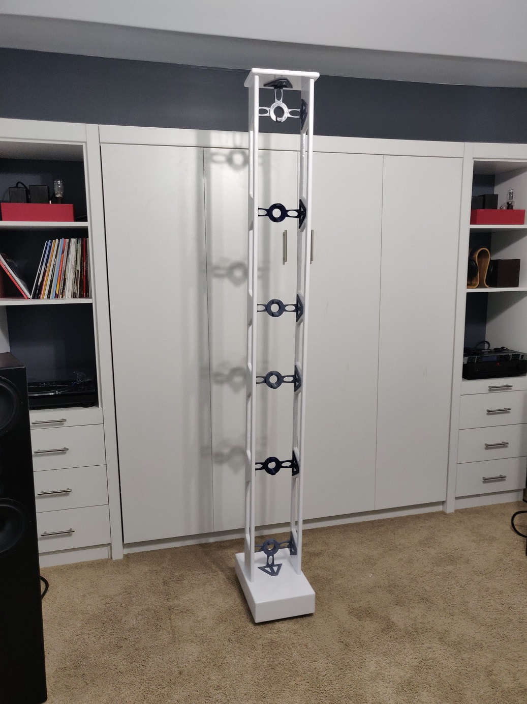

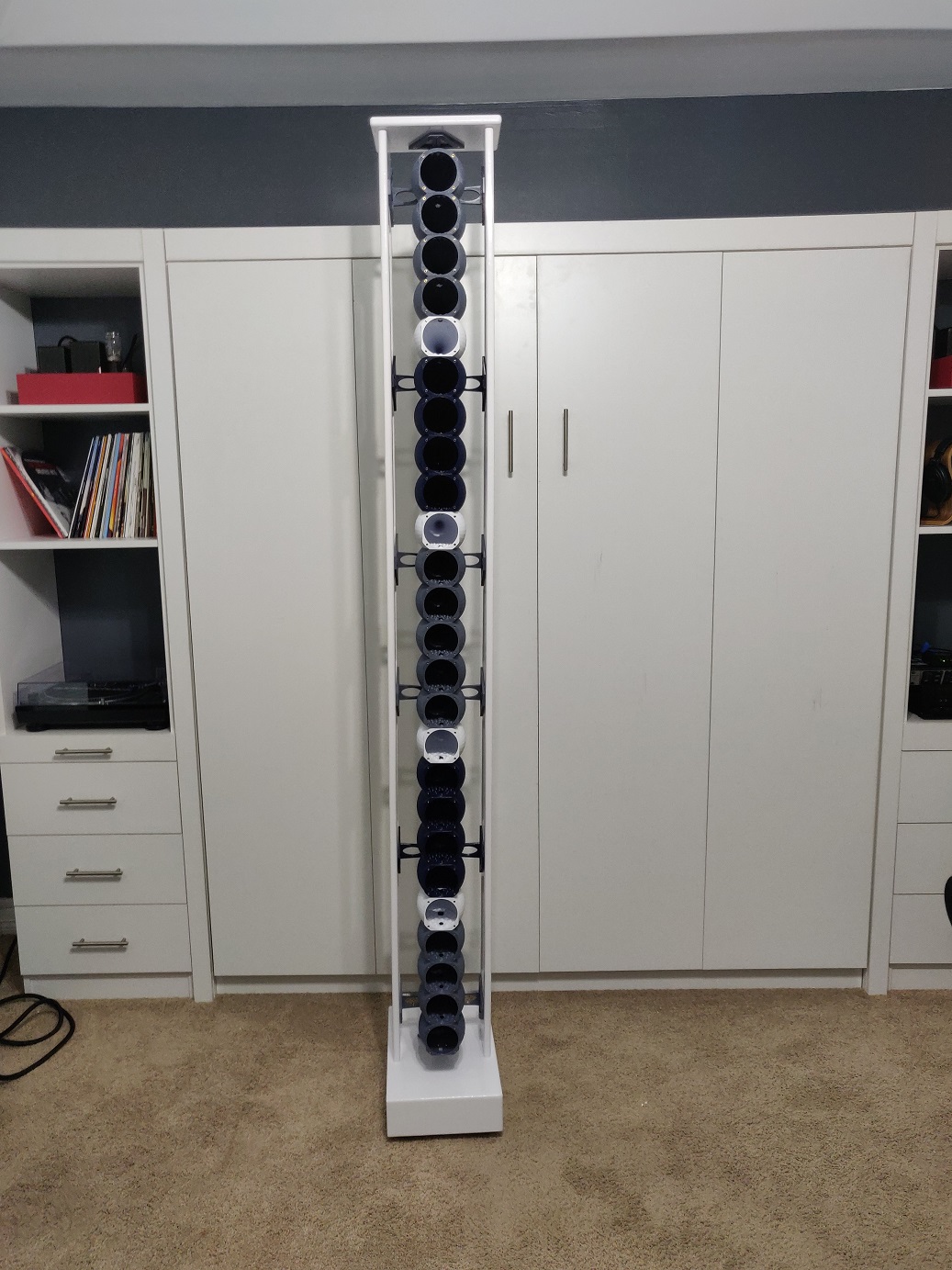

I have also started making some progress on the speaker stand parts. This is something I have been procrastinating about for a few months, but I finally ripped off the Band-Aid and started making some progress.

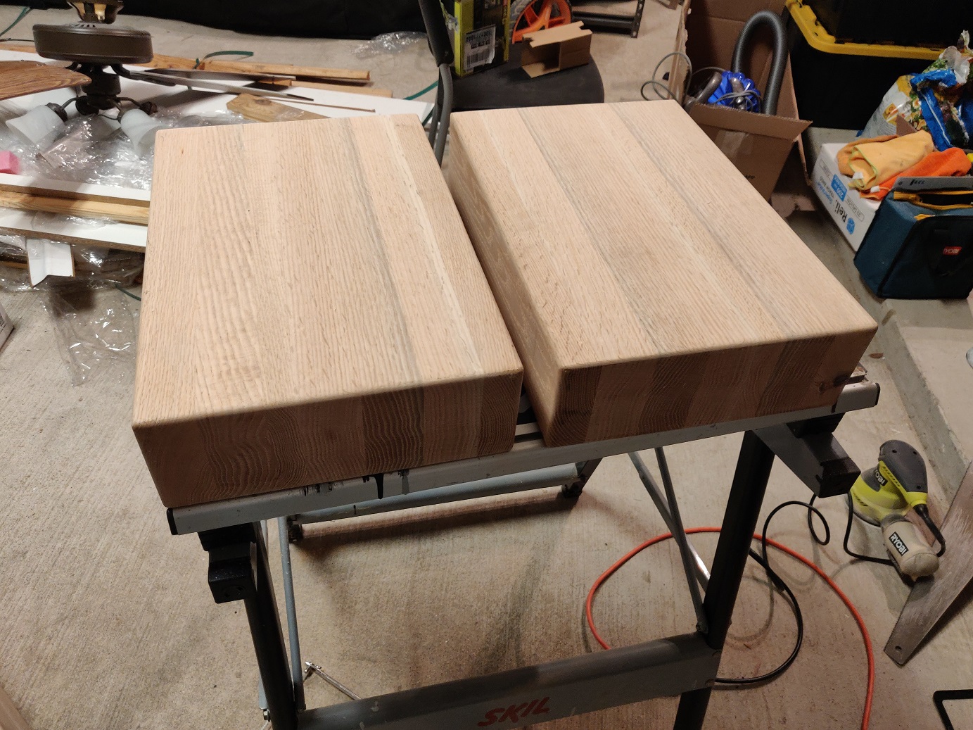

First item required was a solid base for the speakers. They are going to be tall and have a reasonable amount of weight high up in the structure so I was looking for something fairly solid to mount everything too. My father in law (who owns a re-modelling company) brought me what was an unused wooden step. Essentially a 48" x 11" x 4" piece of red oak. After a bit of worrying about ruining it, I took the plunge a cut it up to give me 2 bases approximately 17" x 11" x 4". Each base weights about 18.5 lbs so a decent amount of weight. I have ordered some spikes that I intend to screw into the bottom, and am considering getting hold of something like Herbie's gliders as the target room is carpeted and I am sure there will need to be some placement adjustments in the early days.

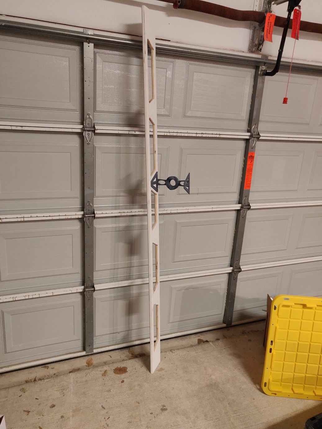

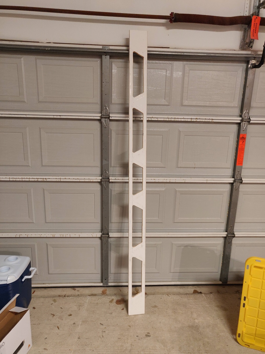

For the side pieces, I started out with some 1" x 6" by 8' primed soft wood boards. I marked out the locations where my printed mounts will connect and cut out as much material between these points as I dared without risking the structural integrity of the wood. The result is still fairly stiff, but I am hoping the stiffness of the 3D printed line will help in this aspect once everything is screwed together. I got hold of a handheld router and put a quarter round edges on every sharp edge I could find, partially for aesthetics but also because I now have an irrational fear of sharp 90 degree edges.
The first article of the side piece didn't really live up to my standards. I had some challenges with an old jigsaw blade making my cuts a bit wobbly, and I also made a rookie mistake in leaving an acute angle in one of the cutouts corners, meaning I couldn't get my router bit into the corner. The second article is much better and will be the template going forward. One of the pics attached shows how the 3D printed mount will interface with the side piece.
I invested in a Kreg pocket hole jig and intend to use 4x pocket hole screws to mount the side pieces to the bases. The top most and bottom most printed mounts have top and bottom connections (respectively) as well as the side connections, so hopefully between all these connection points I will get a good sturdy joint.
My plan is to sand and prime everything before coated with a high gloss white oil based paint. I went back and forth on the finish of the wood, but i think simple white paint will be the best finish so as not to clash with the more colorful 3d printed elements.

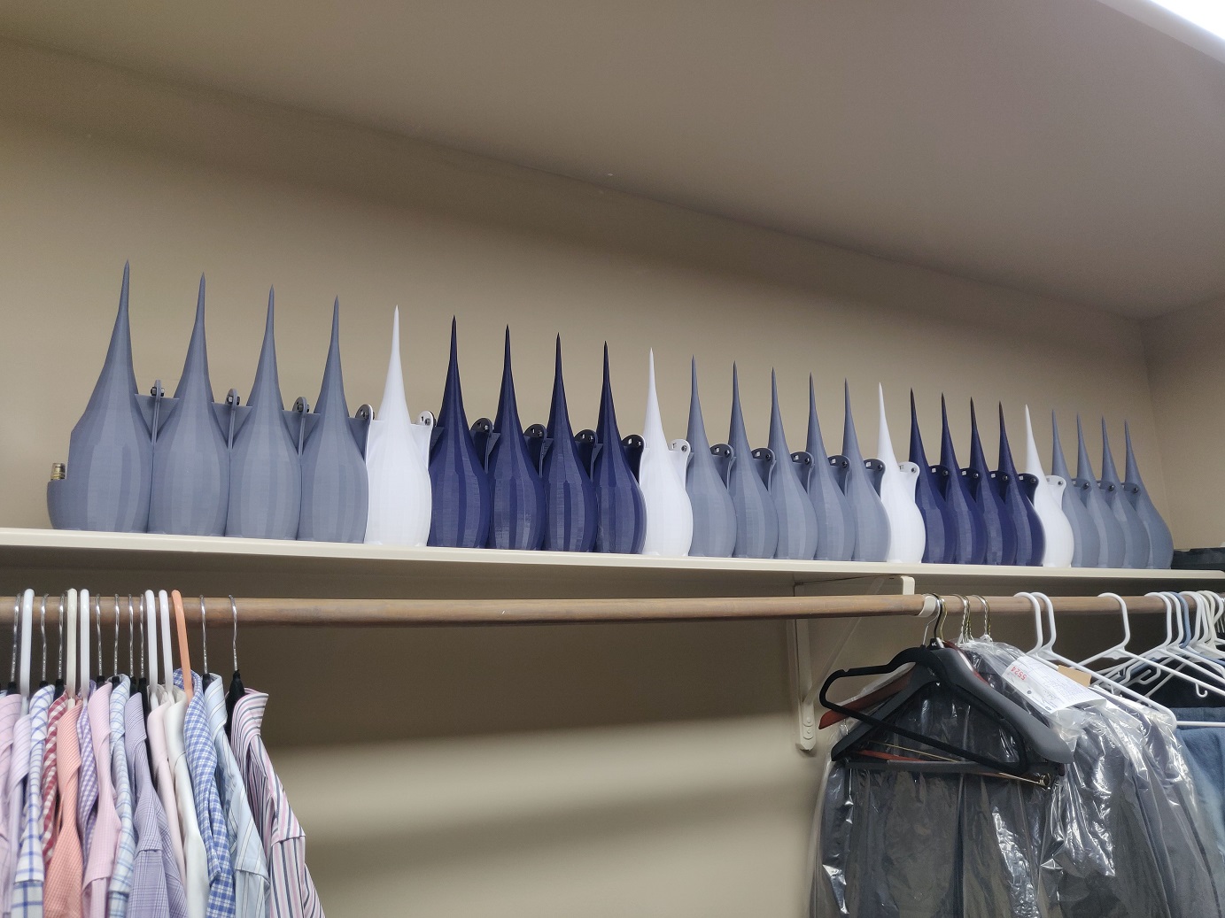

I have included a picture of the first line of driver boxes. It is stored safely away in my closet for now as I don't really have a good place to keep it as it got pretty big once I glued all the pieces together. Hopefully it won't be long before I get my first stand built and can get the line mounted and move onto wiring and stuffing.
As always, feedback and comments greatly appreciated.

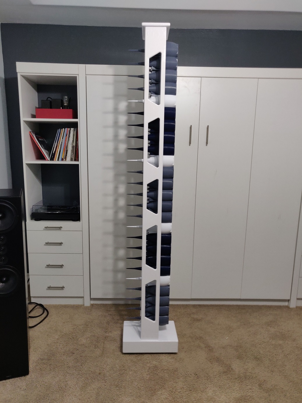

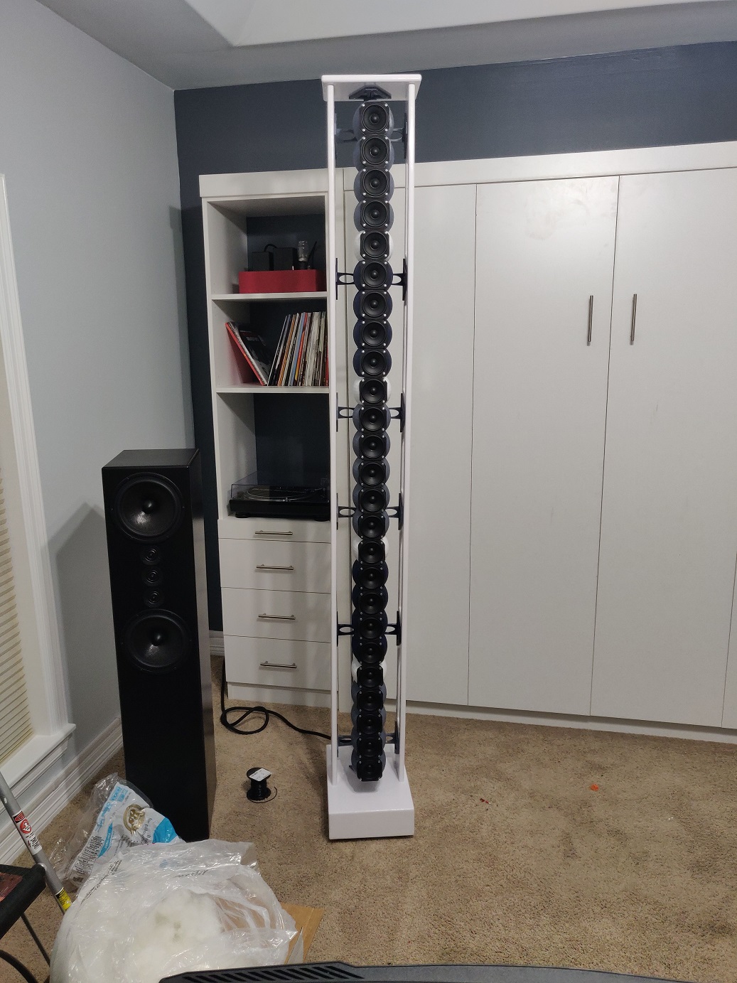

It's making noises! Plan to run it for a few days to get the drivers to loosen up and then start measuring. I have a calibrated mic due to be delivered over the weekend.
So, regarding EQ plans, it totally went over my head that I have a PC in my office where the speakers are located and could do most of my measuring and EQ on the PC.
My current plan (which I'm hoping for some feedback on) is to use a couple of PC tools (REW and Peace EQ maybe) to model my speakers unfiltered performance and what type of EQ filter I need to get the performance where I like it in my room.
My thinking after that was to try and get hold of something like minidsp to put between my preamp and power amp so I can have the relevant correction filter for my setup and still utilize my analog source when the feeling arises.
I do have a lingered niggle about whether I could build a hardware filter based on my "ideal EQ response" to suit my room and build that into my speakers. But that is a thought process for another day, as I have no idea where to even start with that.
I do still plan to try and explore frequency shading further down the road as well, but thought that shouldn't really impact the overall line pre-filter method.
Anyway, speaker number 2 is coming along and probably only a month away from completion. I then need to switch focus to producing the facia plates so I can get the whole assembly together and finalize my measurements and EQ models.
Been a long road to this point, but incredibly exciting to have something producing actual sound! Thanks for all the feedback so far. Going to get more technical from here I think.
