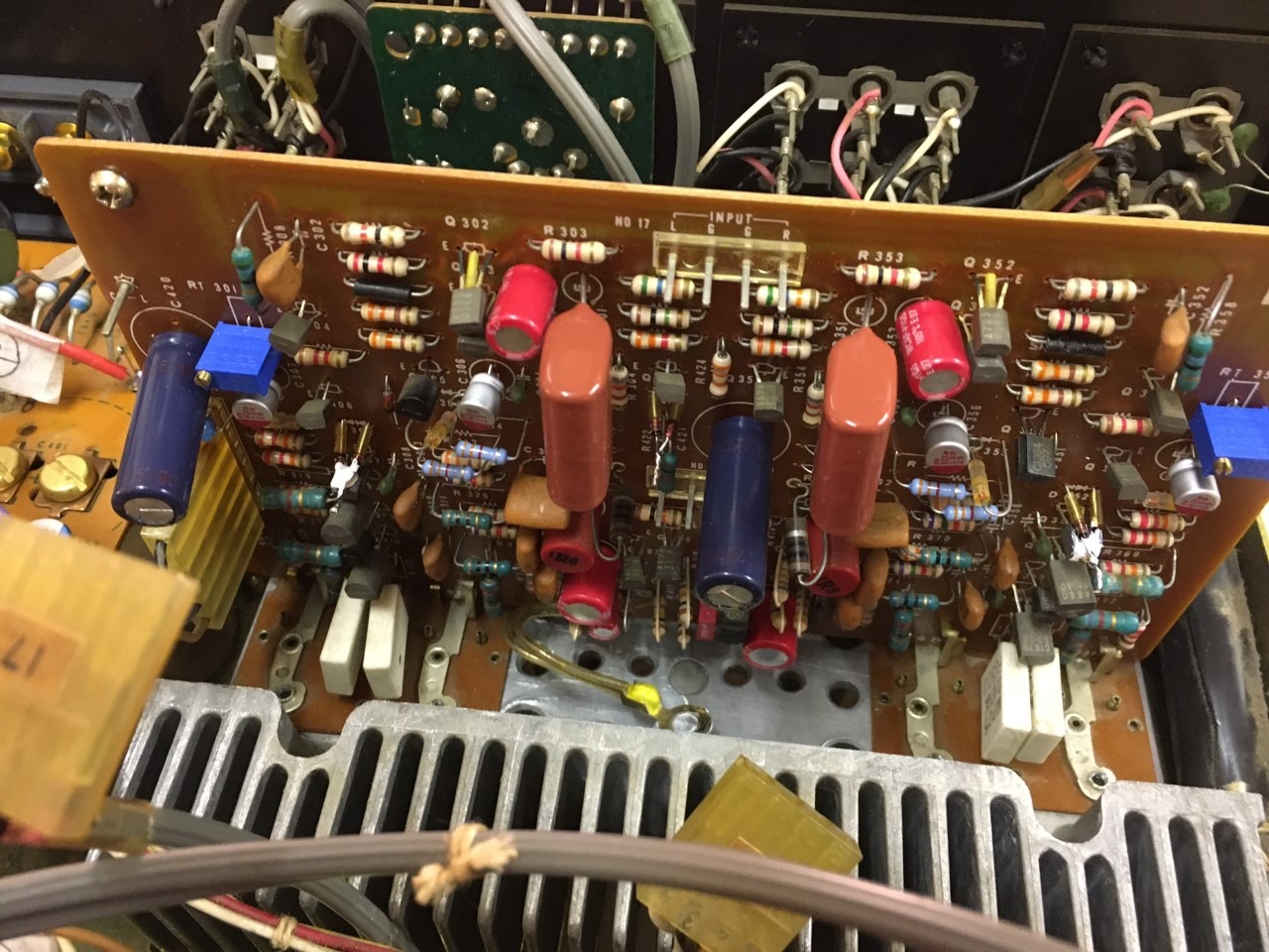

So to add to a previous realisation regarding the TA5650 there are some updates that occurred later in the TA5650 life cycle around the Pre-amp stage.
Just to follow up my previous post: Complimentary ramblings AKA another Sony TA-5650 V-Fet thread,
since I have service manuals for both 5650 and 4650 in front of me now;
for the TA4650 then:
C101 / C151 are marked as 3.3uf /25v in my service manual - equivalent component for a later TA5650 is 10u at 100v (I fitted 3.3/63v PET 🙁 )
C107 / C157 are marked as 470uf /10v these turned into a 35V part in later TA5650's (I upped this to a 25v part so at least moved in the right direction.)
Similarly C203 and C253 were upgraded from 10u/25v to 10u/100v
yes there's a pattern here...
The SM I have for the TA4650 does show later models on the power amp side, but only one version of the truth for everything else. I guess that these 'mods' didn't carry through for the baby amp? Or maybe it's the other way around 🙄
Anyway if I ever find myself in a position to use the amp, it'll warrant re-visiting. Esp C203 & C253 loads of space there 🙂

So new caps installed... Going with the Phono amp as previously described, rather than rolling any TA-5650 related changes but happier with the amp coupling caps at 10uf as intended (C301, C351 on the F board and C203 and C253 in the B board)
So, back to square one then. Check it, check it again and then check it some more 🙂

It's odd when you return to a project what strikes you. Installing the Bias pots as in these pictures means min bias / max voltage is at opposite ends of the VR
It takes some time to have the bias voltages stabilise, I'm using a Fluke 115 on the mV range
Still OK with the bulb-less technique just make sure the meter is correctly connected as per the service manual. Here's my 'procedure' for what its worth
- No Power Vfets,
- Power on Pre not connected to the Power
- Set the 20v line
- Set Bias to the highest voltage, +/- 60 odd volts relative to earth
- Install V-fets (do I have to say with power off?? 😀 )
- and a meter (or two) connected measuring the bias mV (between test point and speaker +ve)
- Power on watching the bias mV readings - they should plummet. If not below 75mV in a couple of seconds [OFF] (75mV was the original running point)
- Pick a channel and increase the bias, with multi turn pots you will be making maybe 10+ turns before you reach the sweet spot, again if NOTHING is changing stop and check you're measuring the right thing - that's never happened to me 😵🙄
- According to the "Dutch service bulletin" Bias should be set to 45mV not 75mV as per the service manual. I chose 35mV for a bit, while everything settles down (an abundance of caution?) It does indeed take 15 minutes to 'stabilise' don't skimp on that.

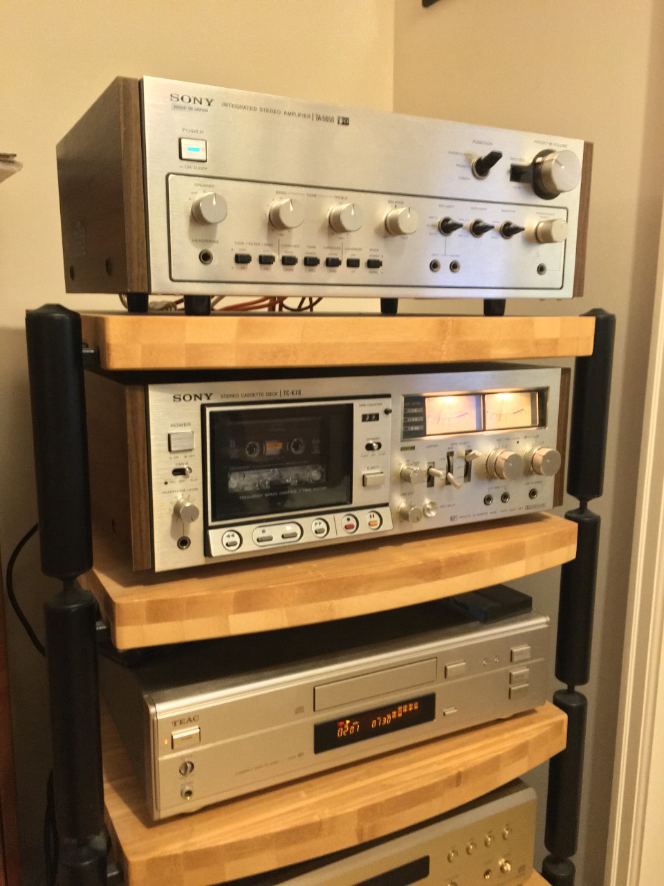

Morning after - Bias on a quiet amp (turned on but no signal after 30 mins now gets to 30mV not 35mV - Conclusion: there is some scope here, given the original spec was 75mV and revised limit is 45mV Lets see how burn in goes. If that's even a thing on a 45y/o amp 🙂 😀
To crow about it a bit, the volume control is just peachy! No scratchy noise whatsoever, pleased with that process (soak in IPA then add contact lube)
For comedy value I added loudness and turned the bass up to 10 and yes through my Castle Harlech's the floor does indeed go wobble - surprise for what's supposed to be a bit weedy - much OOOooommmphh!!
To think the TA 4650 / 5650 was "just something you could buy" - and from a mainstream manufacturer at that, tells a tale... Of course 'proud father' syndrome applies here. Get your own and find out 😀
I think that's all folks - end of thread

Well done 👏 you. Yes the bass is relatively good for a 40yr old amp. I use some IPL Acoustic Transmission line speakers and they have some rumble to them, even at low volume.

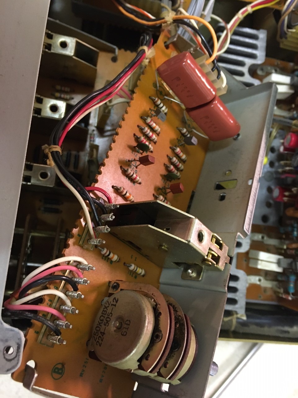

Andy,C and D boards
C board and D boards
These come as a pair by virtue of all the wire wrapping linking them together
The C board is tone control, nothing in here needs touching really, just the standard scrub and so on
The D Board – marked as control in the service manual
C210, C260 – 10uF / 25v replaced with 4.7uF / 63v film
C209 C259 – 470uF / 6.3v (New type) replaced with 470uF /16v poly
And clean the switches out of course
Without thinking I initially elected not to replace RV202/252 but, as I'm writing this, I think that's actually still standard enough to be replaced. It's also the balance pot so pretty important
Andy
