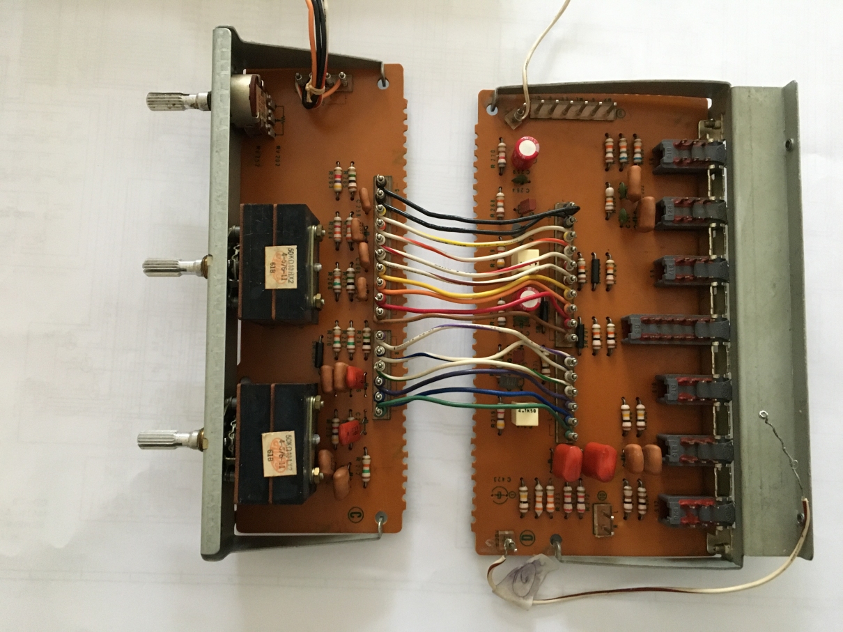

C and D boards
C board and D boards
These come as a pair by virtue of all the wire wrapping linking them together
The C board is tone control, nothing in here needs touching really, just the standard scrub and so on
The D Board – marked as control in the service manual
C210, C260 – 10uF / 25v replaced with 4.7uF / 63v film
C209 C259 – 470uF / 6.3v (New type) replaced with 470uF /16v poly
And clean the switches out of course
Without thinking I initially elected not to replace RV202/252 but, as I'm writing this, I think that's actually still standard enough to be replaced. It's also the balance pot so pretty important

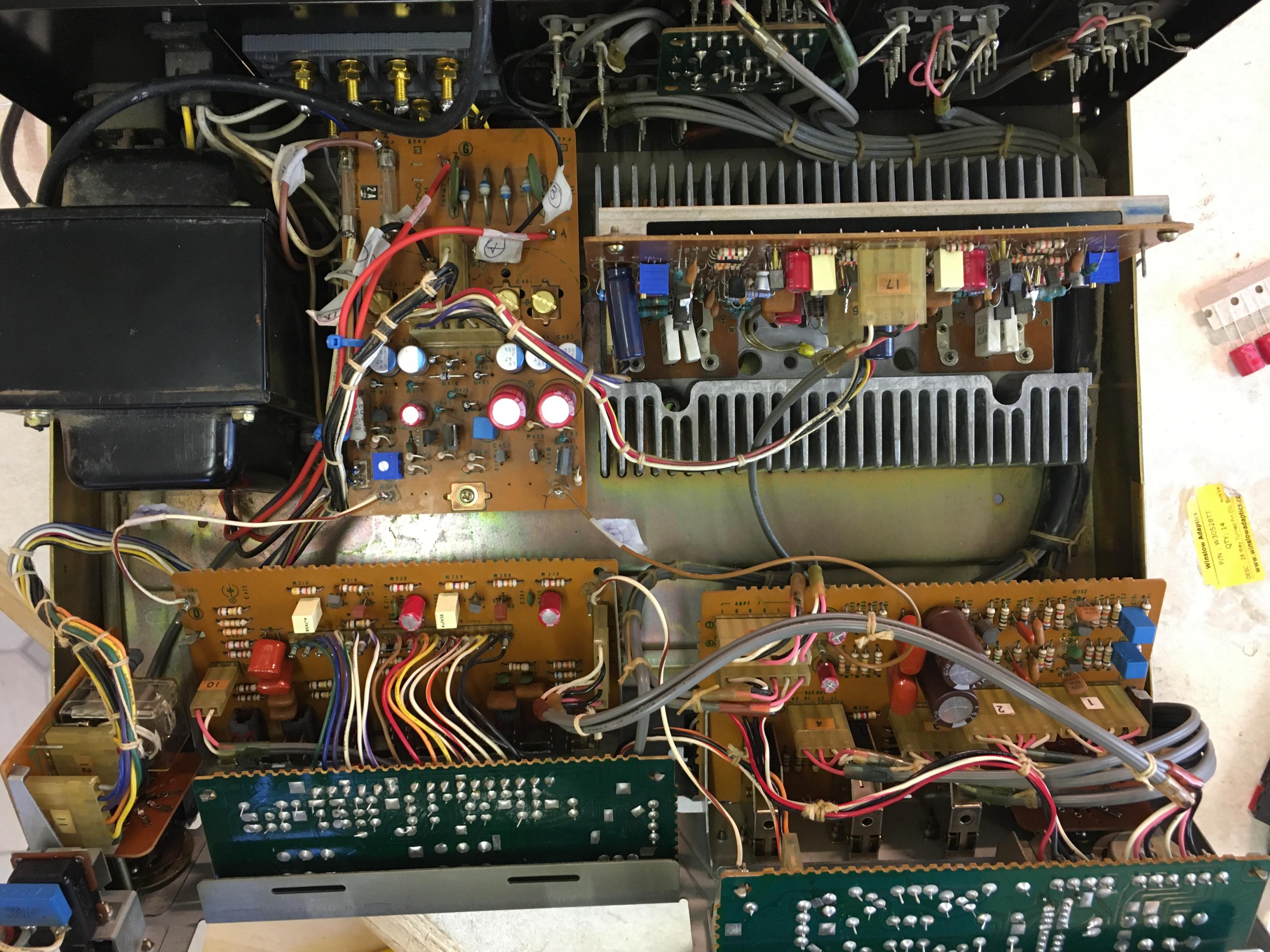

Next for the TA 4650 is reattach all the power stuff and then "do the full clench" with power on. No Vfets fitted except in the Phono stage of course. I really hate that part with these amps - it's a very first world stress 🙂

#1 The 5mm stand off on the power board is not actually M3 - so that doesn't actually fit 🙁
#2 The new speaker posts need to be fitted before the PS board, I should have spotted this as I was very aware my go to amp posts didn't fit because "depth" 🙄

Also , the front and rear panels will hinge down. Undo the bottom screws and slacken the side and they will pivot.

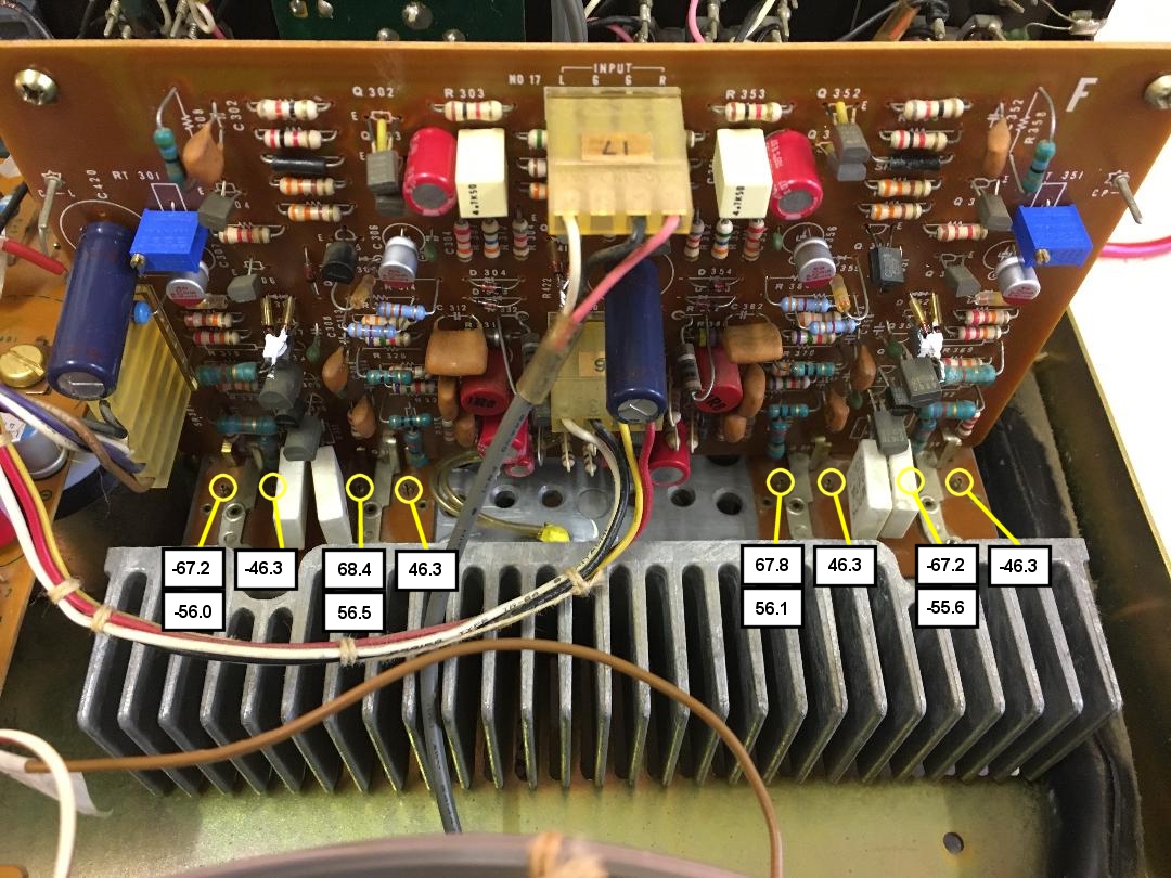

Taking a breath: The voltages across the still Vfet-less Vfet pins are symmetrical to within a volt.

So after a busy few weeks I've finally got back to this; power on and checking voltages on the F-board one final time. Good swing from the Bias VR's and so on (see photo for voltages) Everything is super steady too
So at this point I linked the Pre-amp section back to the power - May have missed the part where I hooked that up to another power amp to check all was rosy. I did, It was.
Now here's the stumper: gate voltages drop from the 67 volt range to the 40 volt range.... Supply is still steady at 46.3v but you'll see the problem: Bias would be reversed and that's bad times
So the Vfets remain OUT for the moment.
My hope is it's just a Vfet-less anomaly.😕 Both Channels behaving exactly the same should give me some comfort. I'm just sort of baffled that the pre-amp has an effect on the power amp voltages. They're separated by a cap after all. (I'm using the original links so no additional ground connection)
Thoughts / comments anyone, Should I be checking anything else? I'll accept that the Sony team probably didn't expect anyone to be prodding around 30 odd years later with the main components missing.

Hi Andy,
What are you using to reference your voltages to? Should be the speaker output GND by memory.
Jon
Jon
Its all relative...
@jonboylaw
Yes that, I should have mentioned, "all voltages are relative to speaker ground"
There is a note in the thread you shared about this sort of thing too.

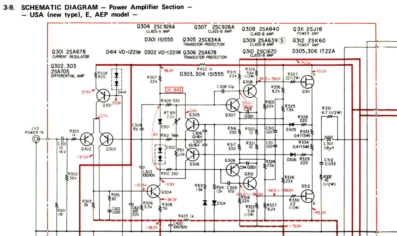

I'm looking at the schematic now, am I too far off to suggest that if Q308 conducts at all, the gate voltage for Q311 tends to zero (assume without the Vfets) because of the potential divider R319 and R320? So any noise and you'd see what I'm seeing? I'm not in any way experienced with transistor circuits so this might be politely [BUNK]
I didn't do this last check previously because the amp was known working prior, (perhaps ignorance is bliss) so I might be over thinking this
Andy

#1 Turns out that yes; putting the V-fets in stabilised the voltages nicely.
With/without the pre-amp linked in, the voltages measure as the previous picture.
#2 (AAaaand here's where the afternoon could have been better) Right channel setting bias nothing much happening, as usual with the multi turn pots, but I smell "warmth"... power off!! Too late = One dead V-fet pair
I'm a *little* annoyed as with hindsight I knew the 2SK60 was a survivor, I'm also sure it measured OK beforehand and gate and source voltages checked out so either it didn't like the stress or, more likely, I goofed somewhere. 😱
Whatever, replacing the 2SK60 with a spare brought the voltages back there. But gate for the 2SK18 was now stuck at essentially zero volts. A further diode check confirmed it's fate along with it's sibling. [Insert flowery Anglo-Saxon here]
One other thing was that the right channel wasn't linked to the pre-when I was fiddling. To be fair I didn't think the left one was either but turns out i have a rogue link.
Left channel works fine. I've hooked up speakers and so on. It's a little bright (on the left ear) compared to the TA-5650, but loads of detail. In the fullness of time the aforementioned changes around caps in the signal path might need to be reviewed...
Anyone got a 55 rank 2SJ18?? 😀

Having reviewed this afternoons events I'm putting it down to stupid on my part. Without the pre involved i think bias might have been a bit more ON than I expected. I've cooked 'em by over/under biasing.
no excuses, I do think this one's squarely at my feet
Seems to imply though, that it's worth checking the bias if anyone chooses to use these as a power amp, if only out of an excess of caution.
Tomorrows job is put the left channel Vfets in the right channel (carefully) If I'm sitting on a fully restored amp less 1/2 the Vfets then at least I know what shopping looks like...
