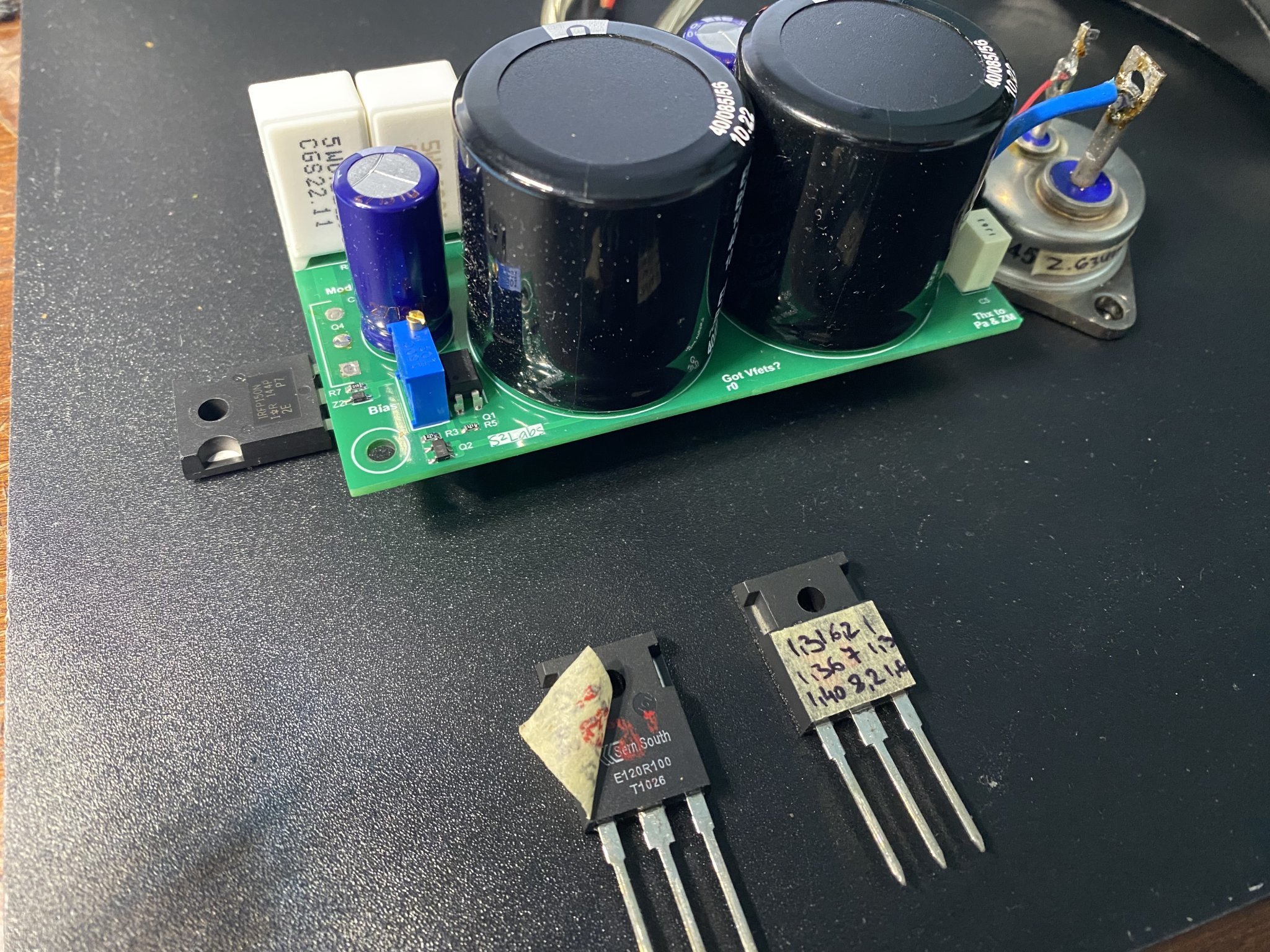

Further to post #176, here is the GB for 2SK3497, as promised, for those lucky guys with a pair of Semisouths :

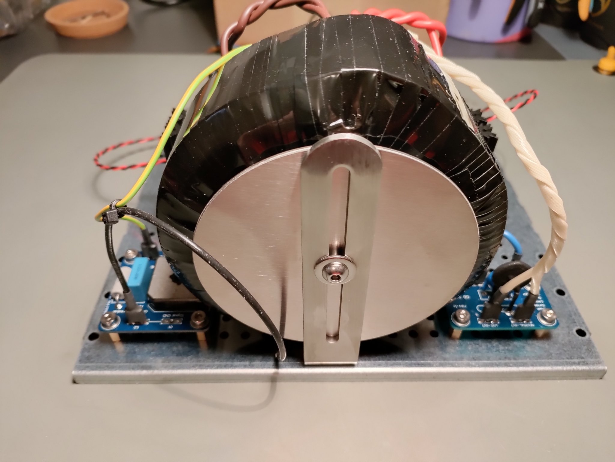

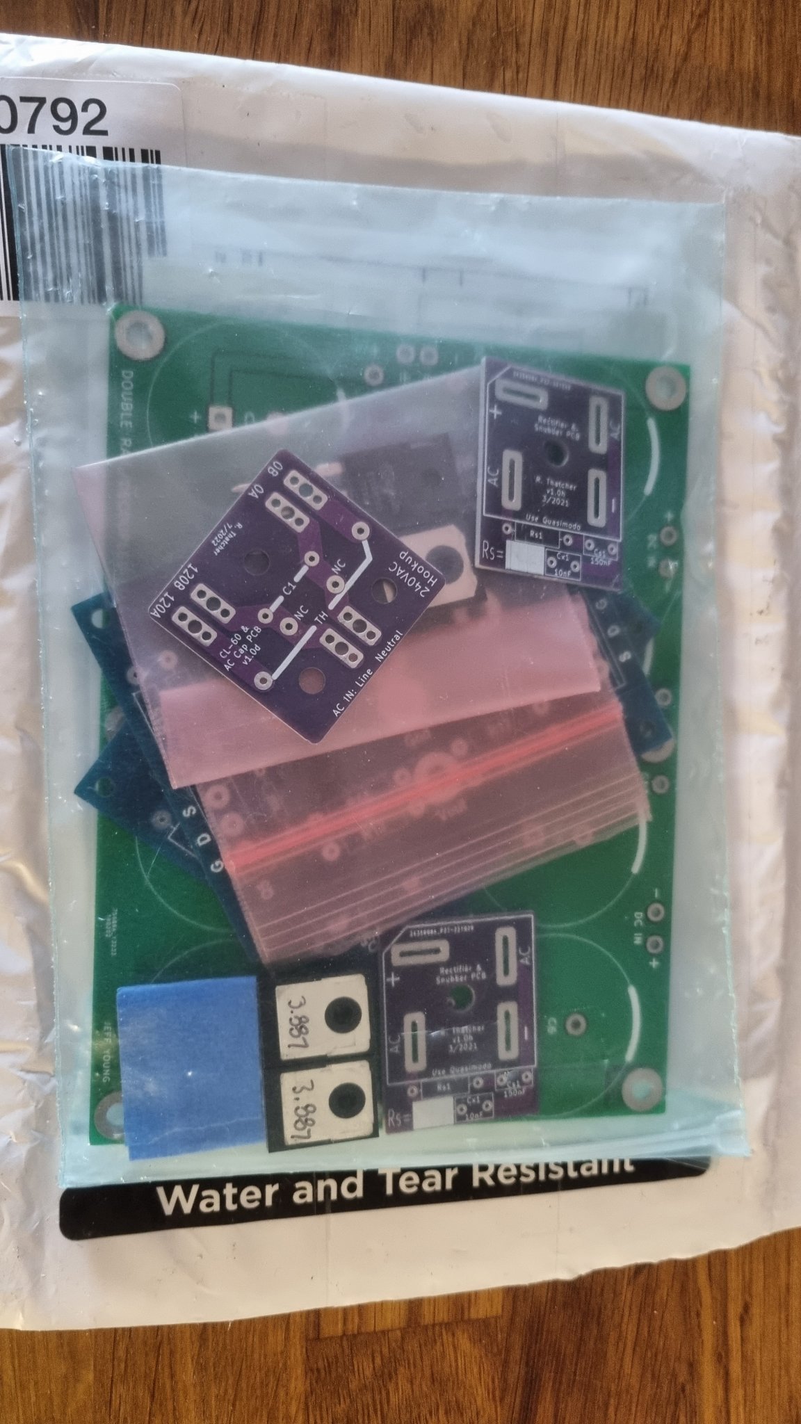

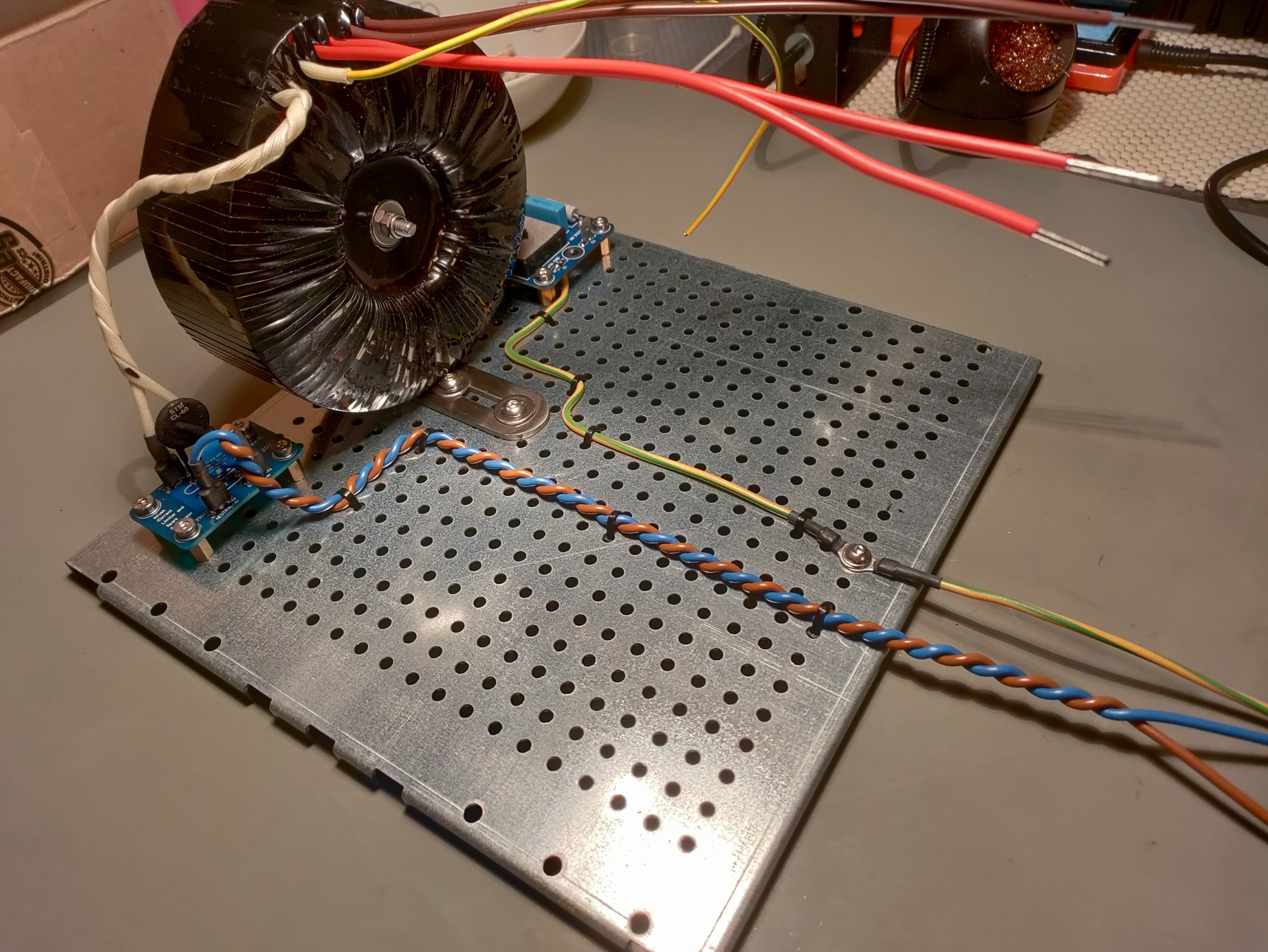

Thing is that I was already building a FW PSU for a mini-dissipante chassis when the SS pair fell into my lap. Now I am thinking that if I want the J2 finished before the summer I should set aside the PSU board kindly provided by Randy for next build and hijack this already-built PSU into the J2.

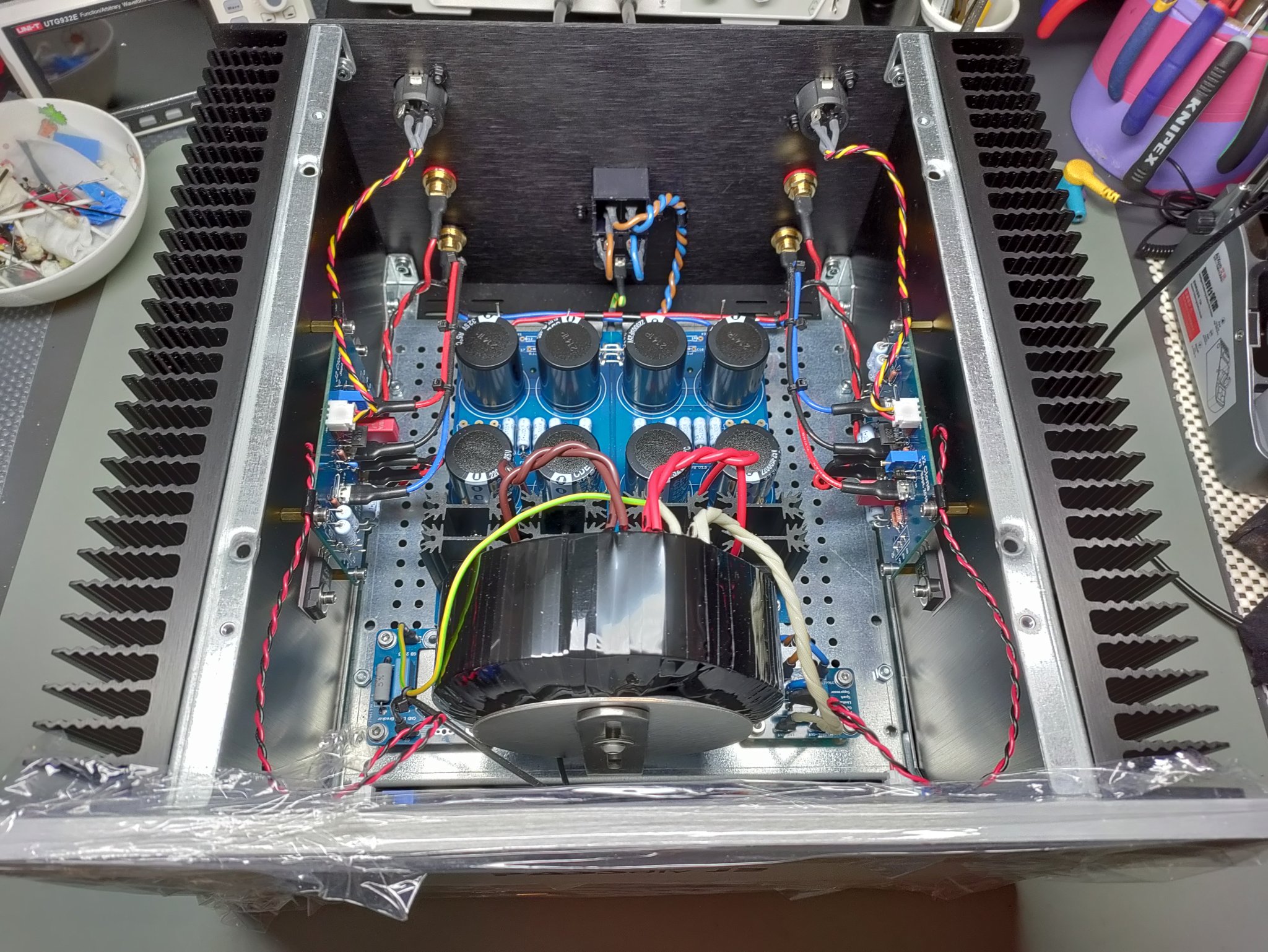

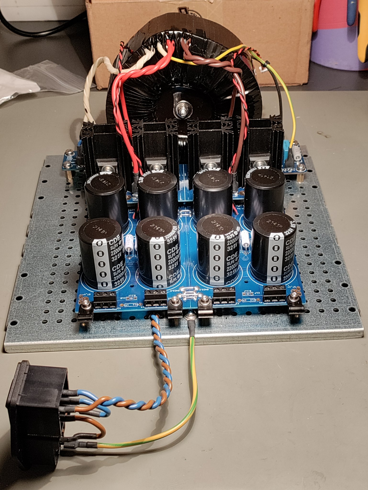

Consider a relay to reduce turn on zap of the caps. Mine bulged in my F5 shortly after building it. But they were very cheap caps.
Thanks!
The CL-60 on the transformer primary should take care of the inrush current at turn on. We'll see.
Mine did not. I wonder if the Universal PSU needs some fine adjustment for us in 230V countries.

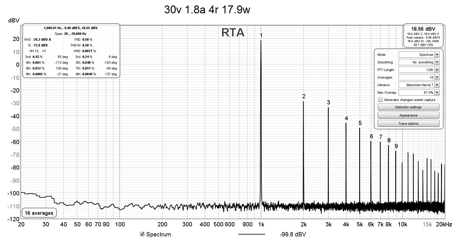

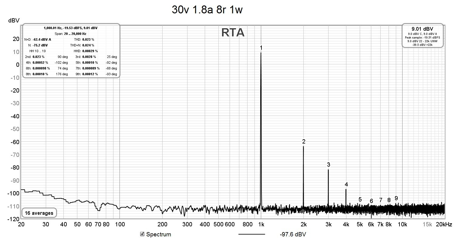

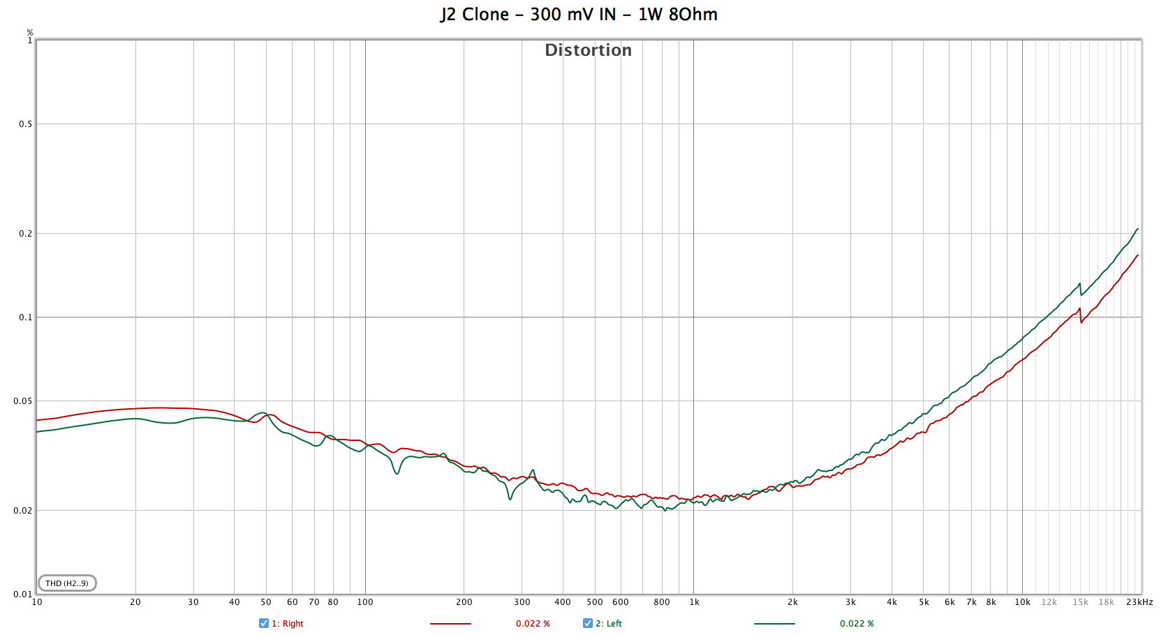

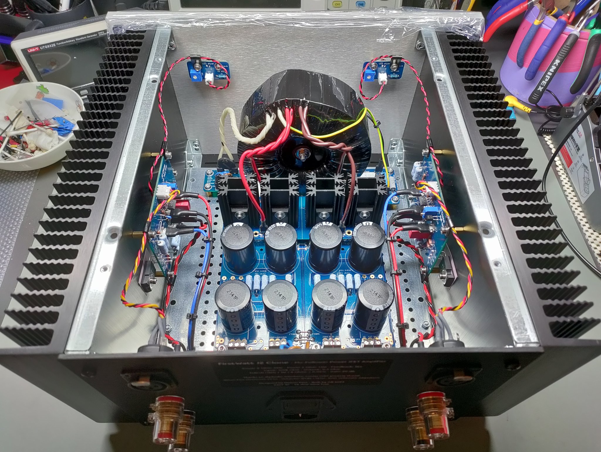

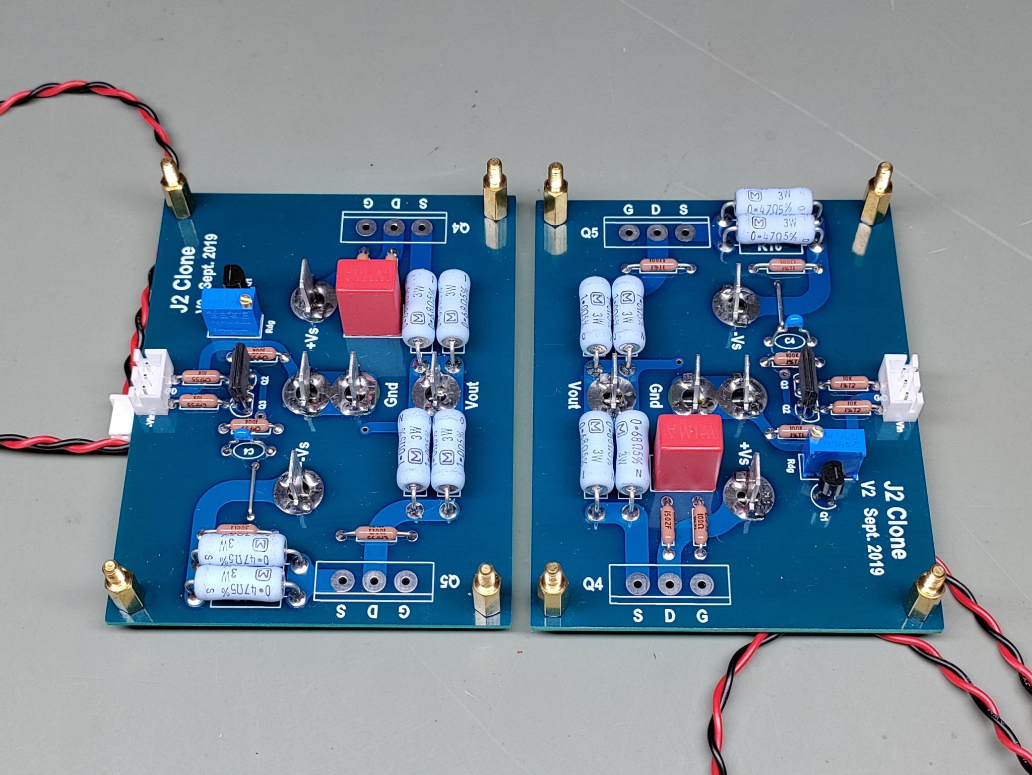

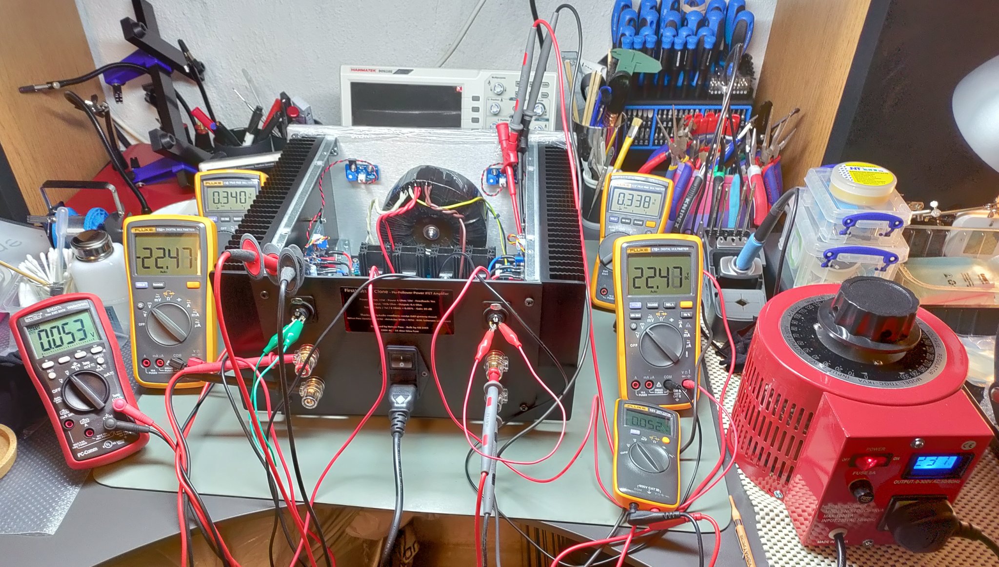

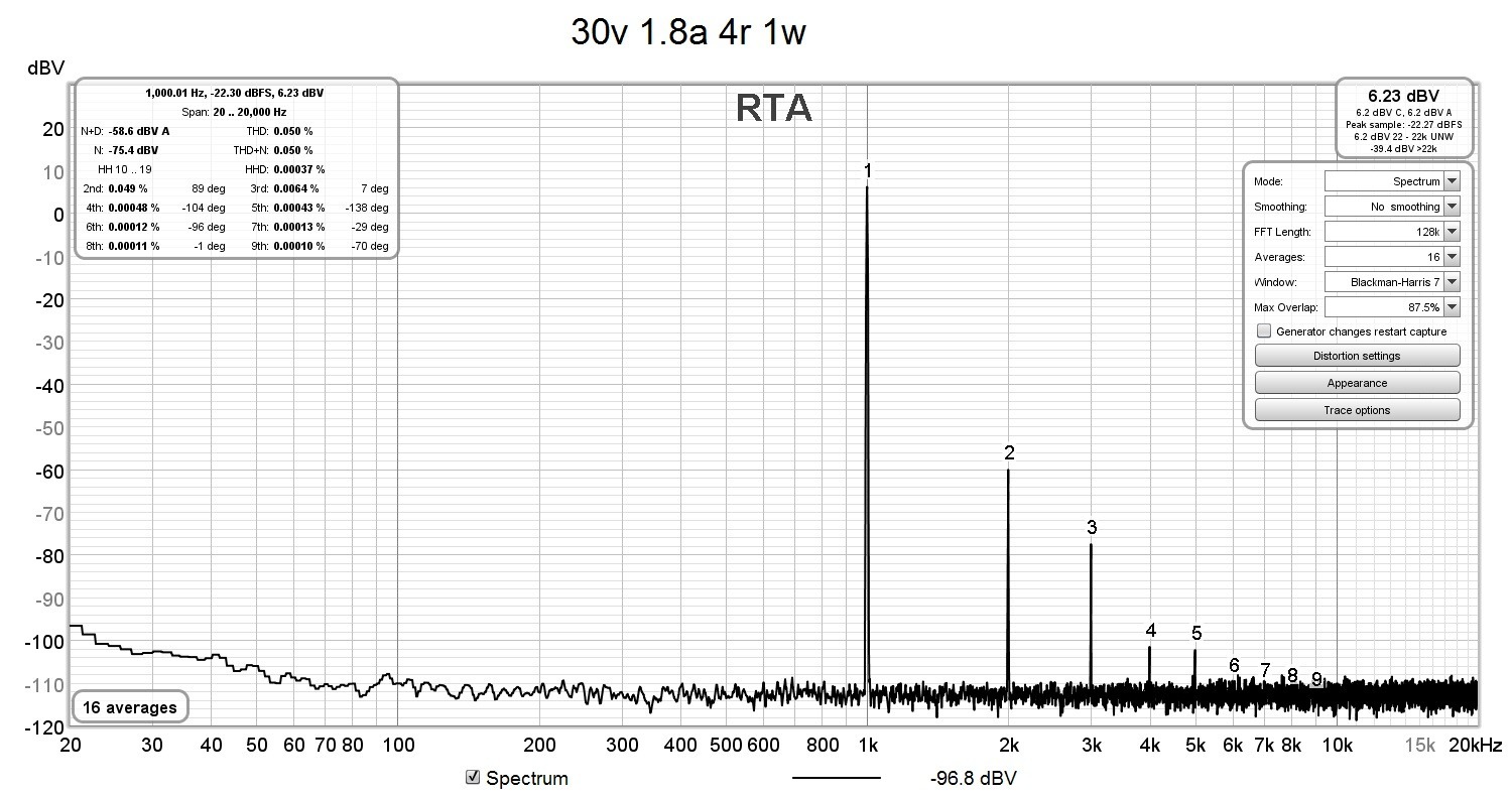

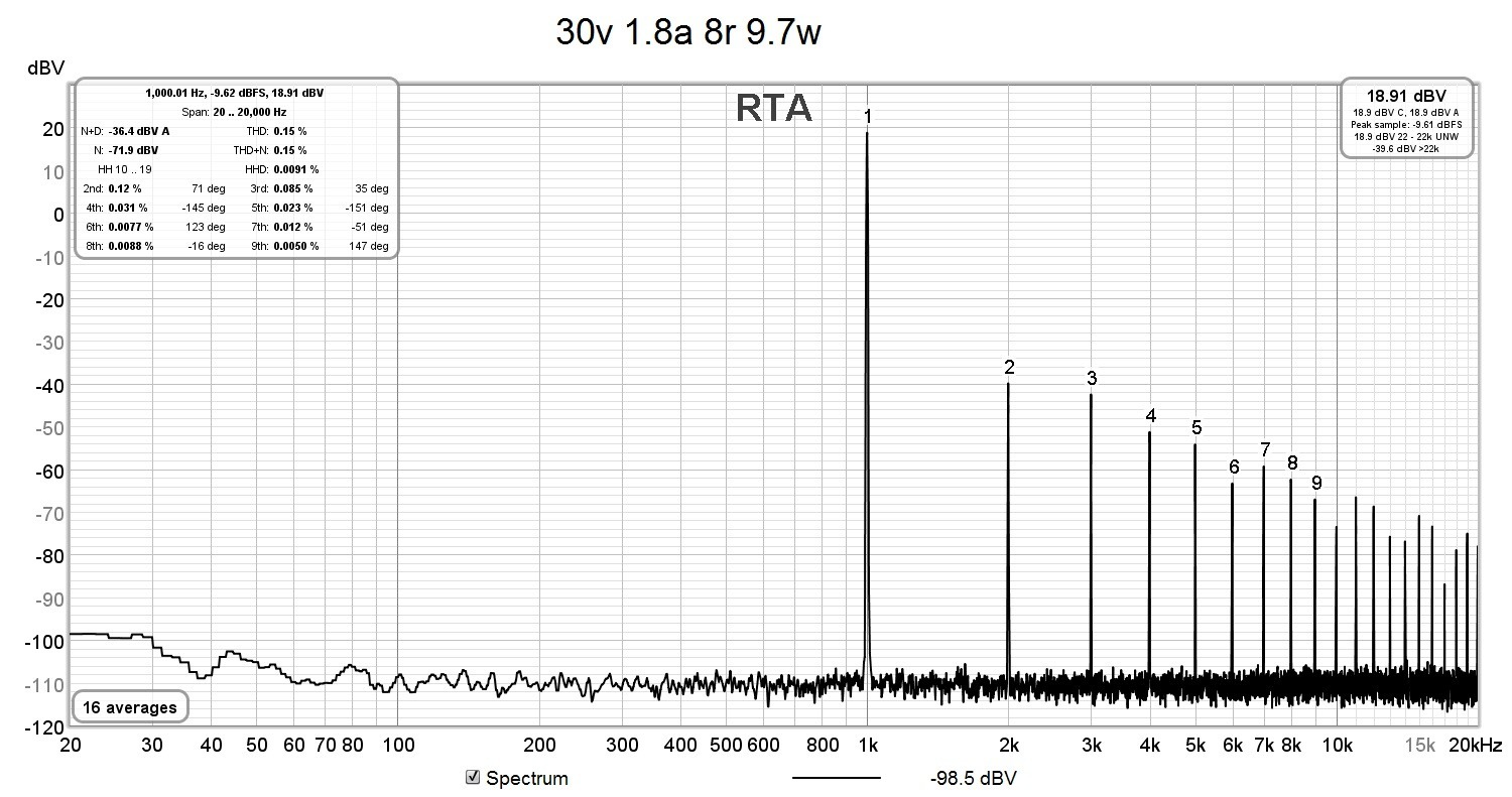

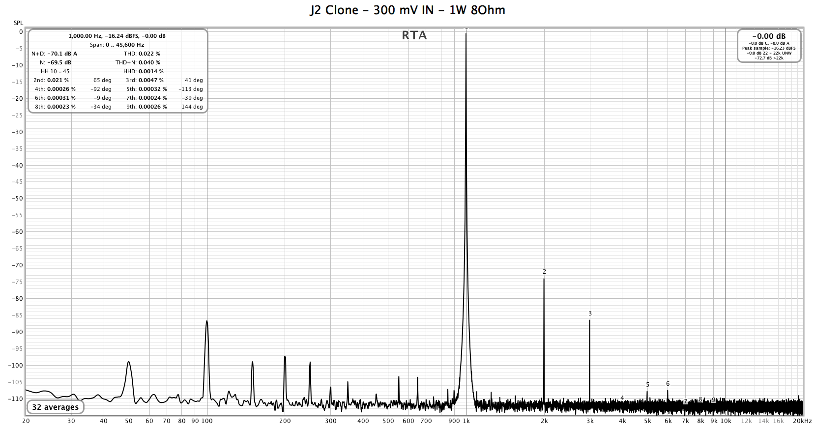

Finally I got to use mine. Same nice sound as with the sits but with a bit less thd.
I said this was my summer project but I did not specify in which hemisphere

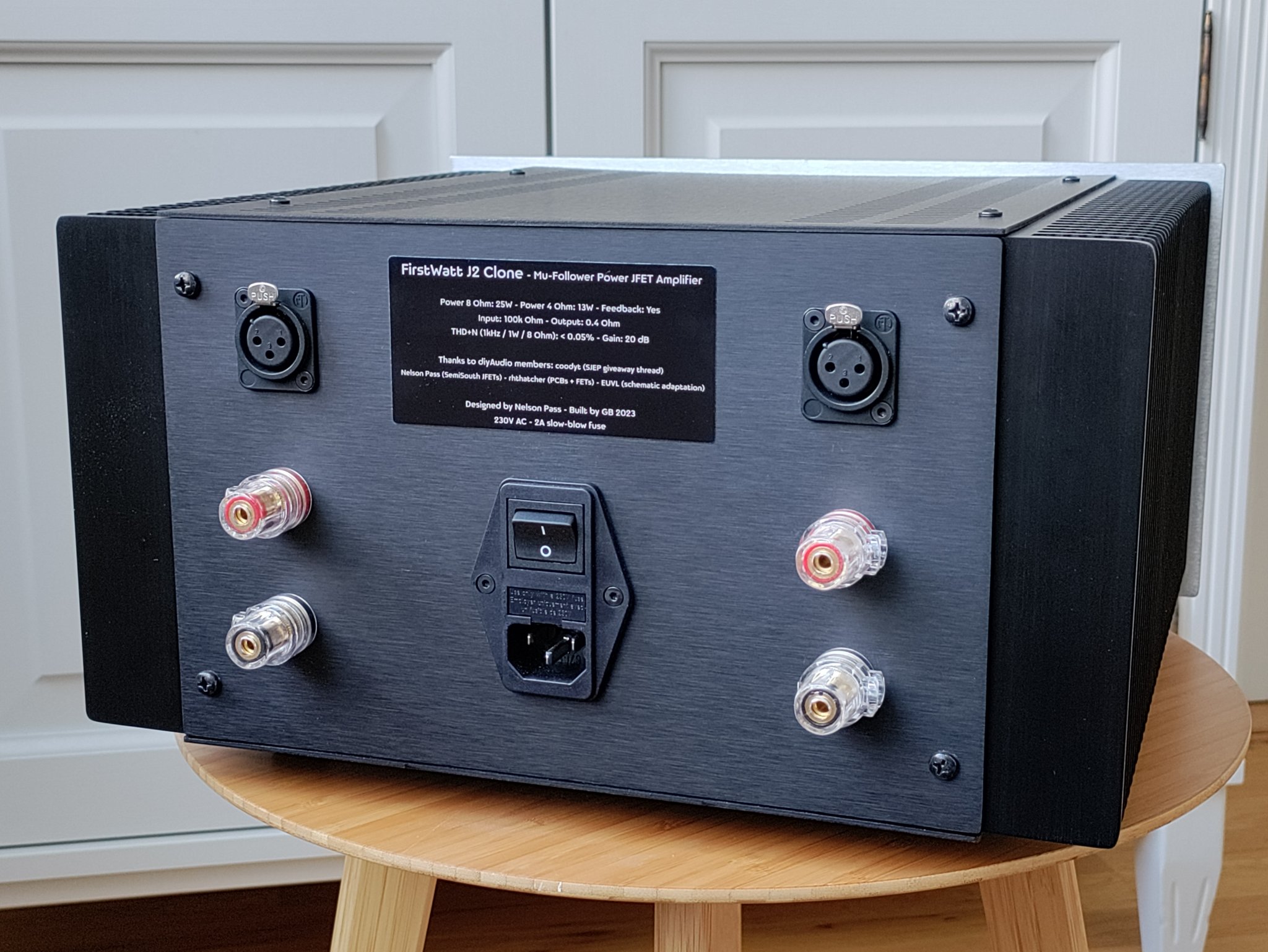

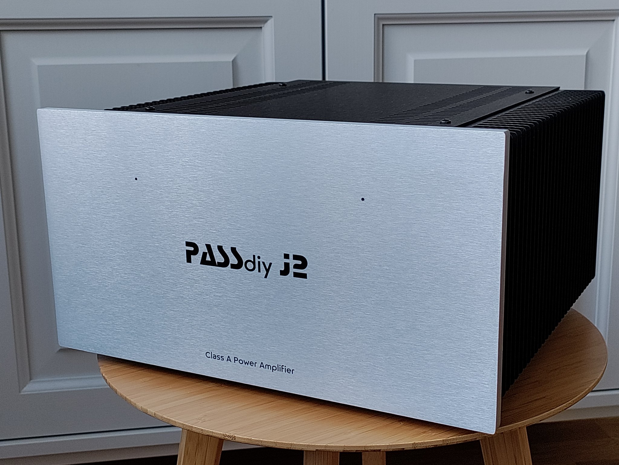

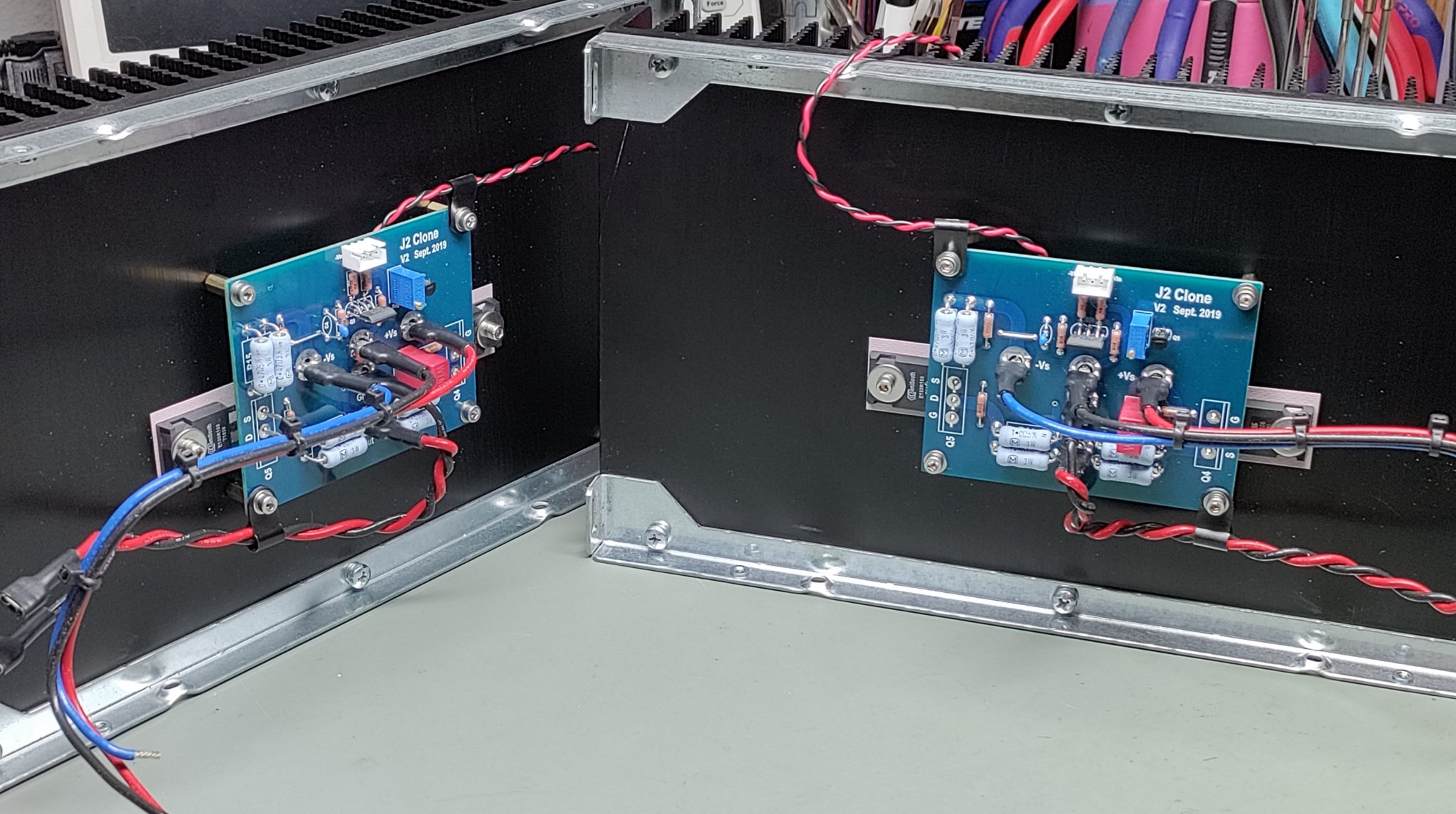

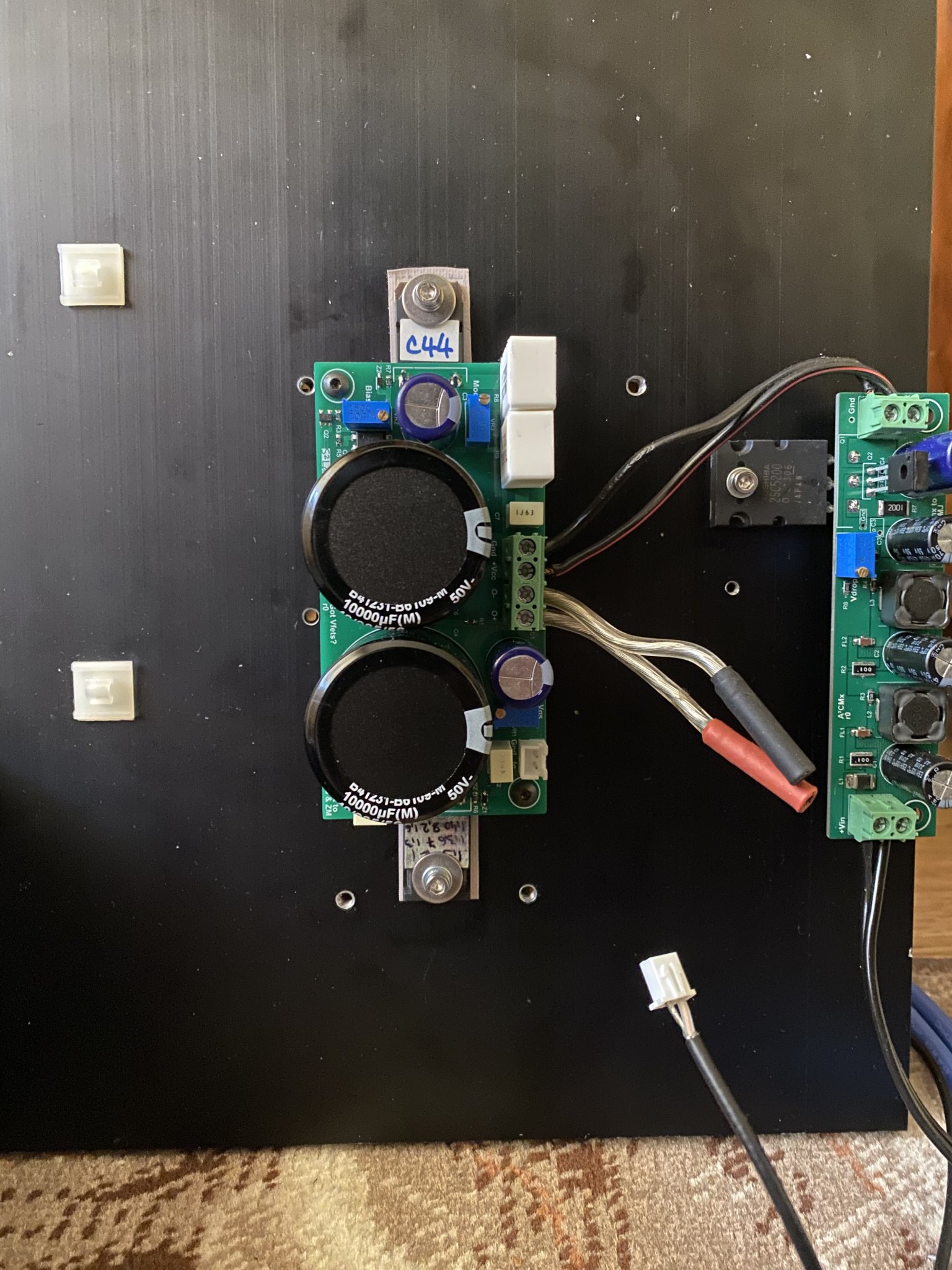

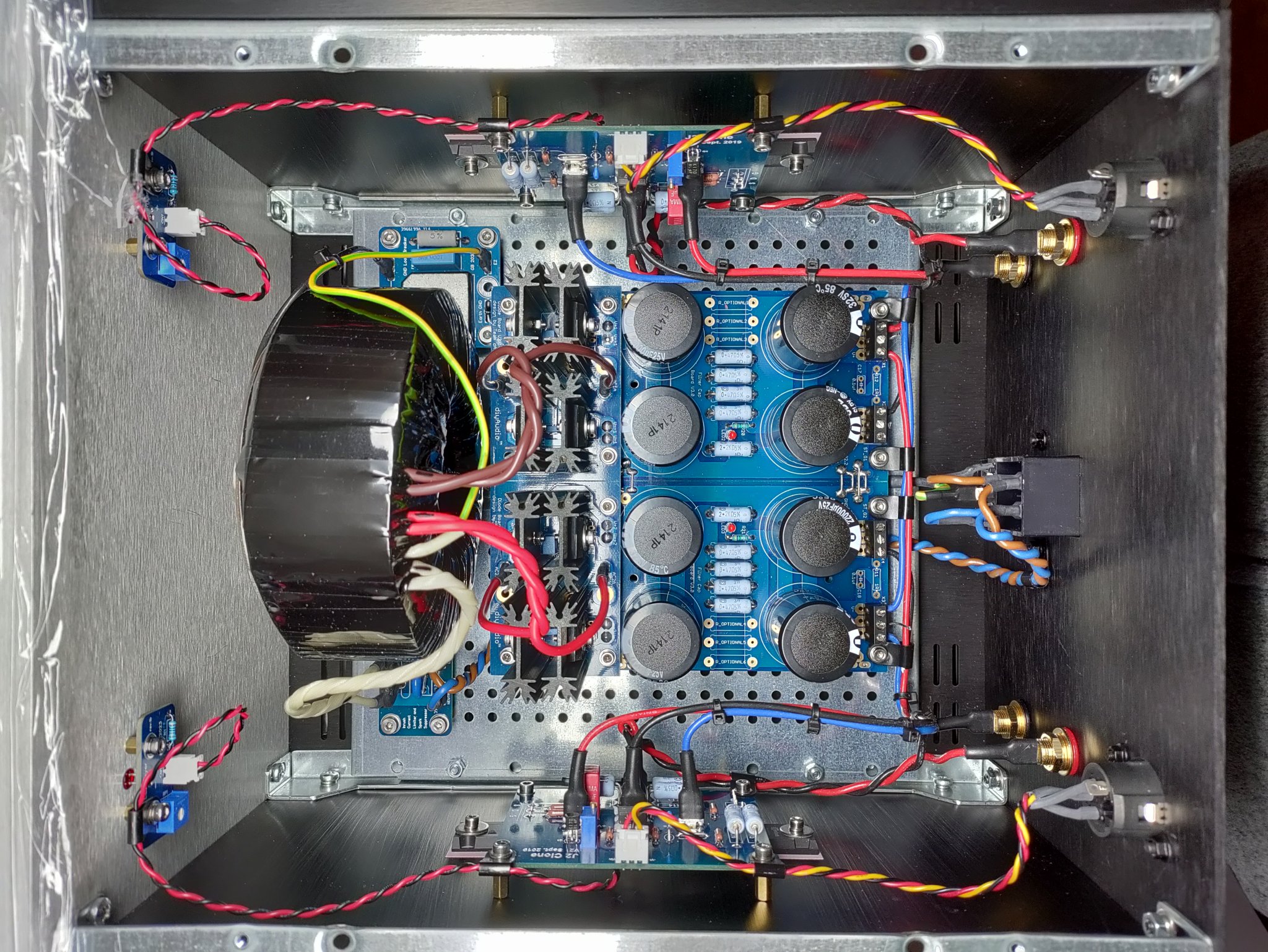

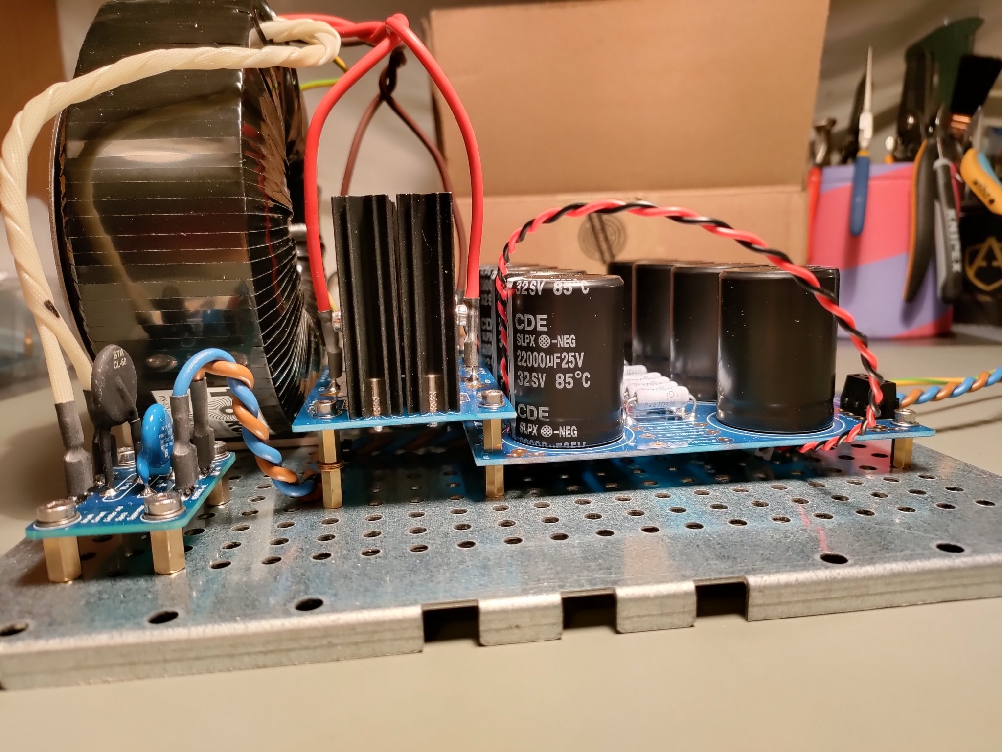

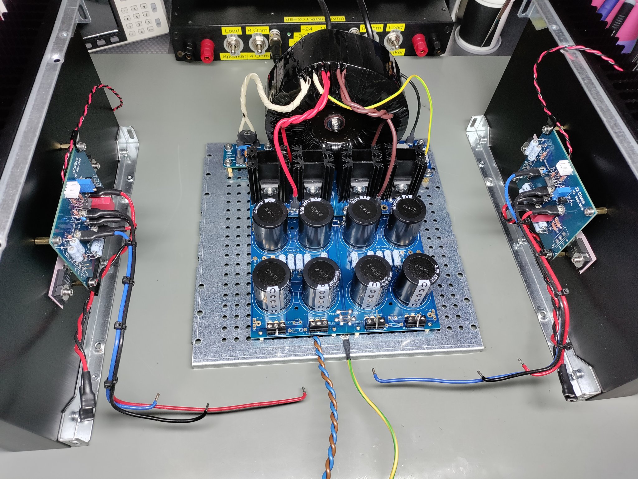

Finally done! Here it comes 🥁
Thanks Cody, Nelson, Randy, Patrick and everyone that shared their knowledge in the J2 thread (the omnipresent ZM of course)

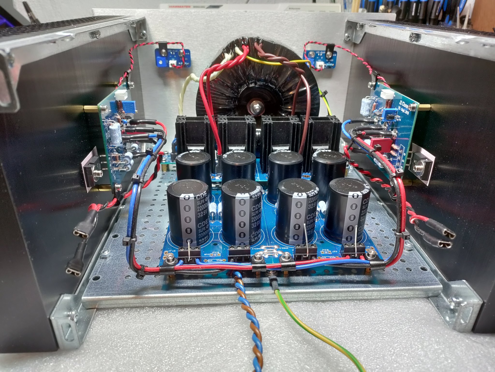

Here it comes a screenshot... and a new sticker for the back panelFugly!

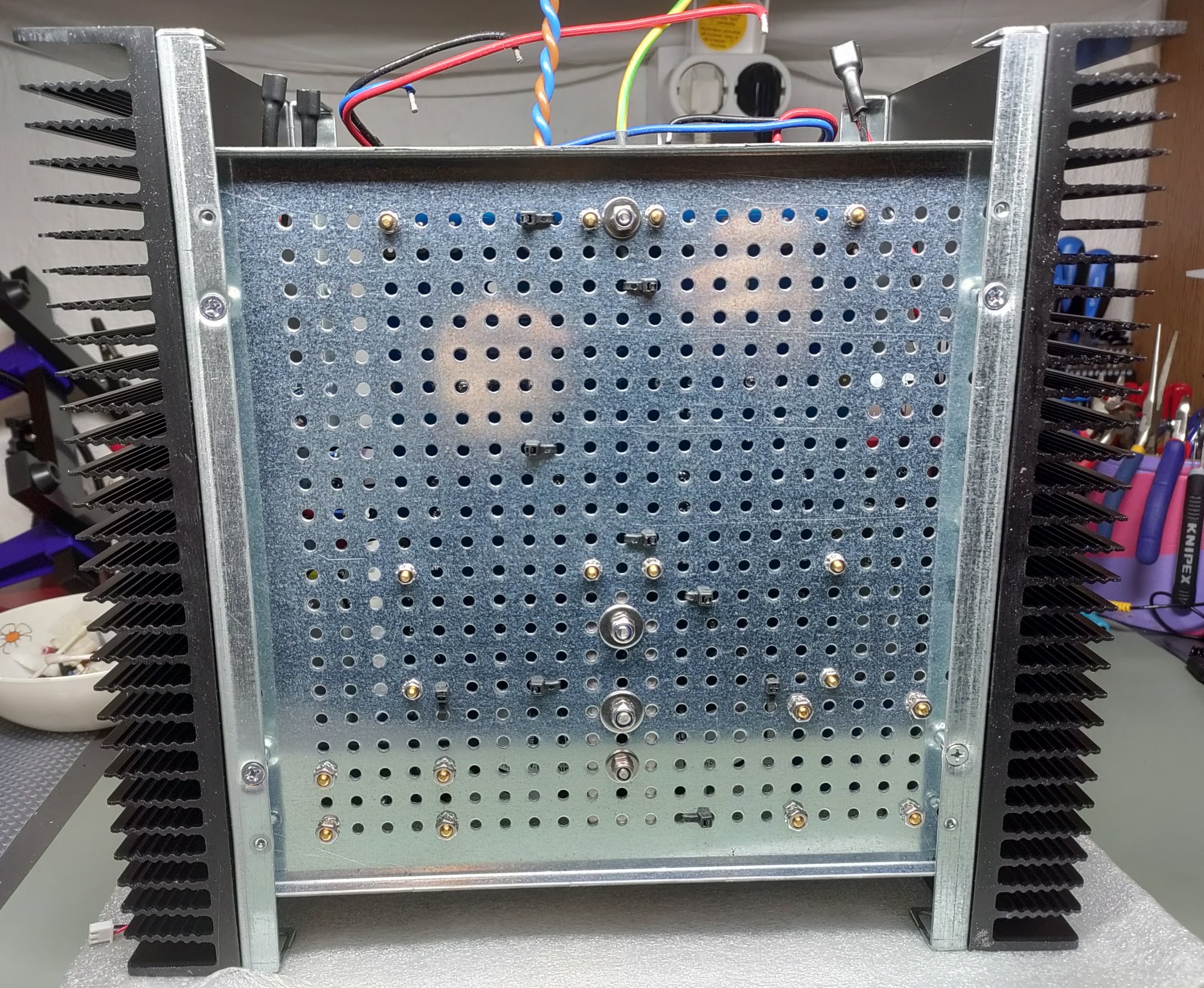

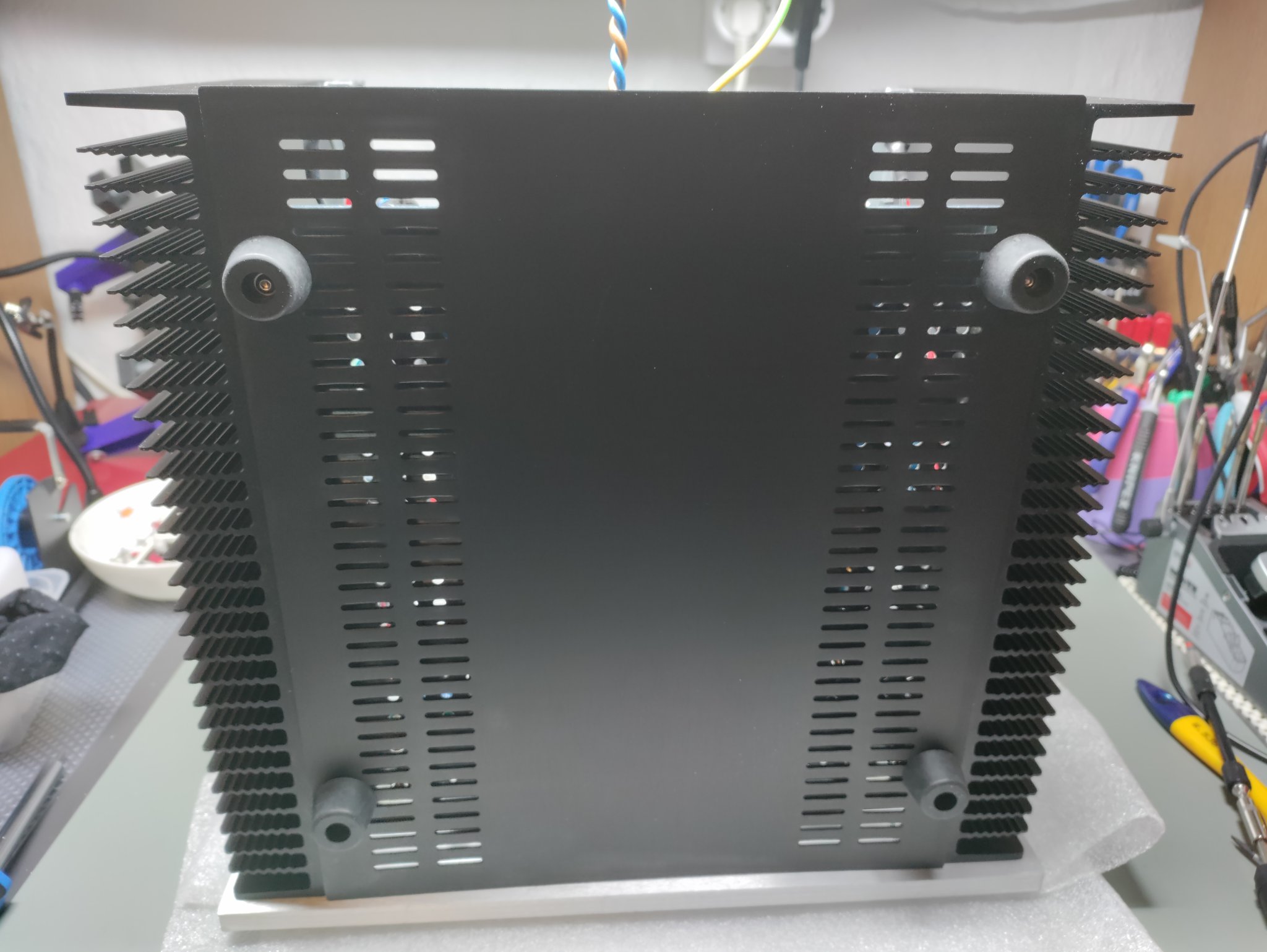

next time, base plate lip up + 10mm distancers, so free clearance to route mains wires underneath
