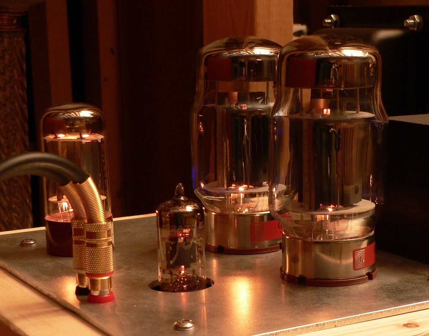

By the way, Dave, your chassis work looks fantastic. What type of wood is that? I want to learn how to make through dovetail joints. I'm afraid I'm not much of a woodworker.

Thanks...The wood I used was figured maple and walnut crotchwood for the corners. I don't use dovetails too much, but I have a Keller jig that does a pretty good job with them, only $80 through Amazon:

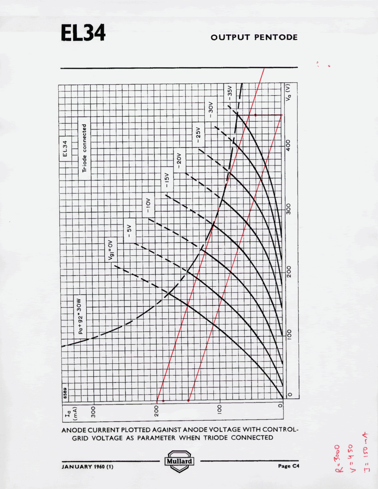

I understand the EL34 datasheets usually recommend a 3K reflected impedance, but the datasheet typical applications are usually at voltages lower than the 400+ volts you'll see in a Simple SE. I did some quick load line plotting, and noted that my idle current ought to be slightly lower (~50 mA) with a 3K load than I could "safely" run if I had a 5K load (~60 mA). When I say safely, I mean the load line doesn't run across the maximum dissipation anywhere along the line. Conveniently enough, my Simple SE seems to run right at about 61 mA. I have the Transcendar 5K transformers.
All that said, my speakers claim 6 ohms nominal, 4 ohms minimum. If believed, that means my reflected impedance is 3750 ohms (2500 minimum). I recall that George has intentionally (?) run 5K-8 transformers on a 4 ohm speaker to achieve an effective 2500 ohm load on the finals.
Here's my lines. I guess if I were using a 750VCT power transformer, I'd want to shoot for a 5K load. If I had a 600VCT PT, I'd want the 3K. From what I understand, lower loads give you more power at the expense of higher distortion.
If your speakers don't match the rating on the OT's secondary, the reflected load on the primary will need to be adjusted proportionally.

By the way, disregard my previous post concerning load lines until further notice. I had a long discussion tonight with an EE friend, and he cast some doubts on things I previously believed to be true. I'm going to have to do some more experiments before I'm convinced of anything anymore.

It appears to be mechanical in nature, most likely from the power tubes themselves. I'm guessing the grids jingle/rattle a bit when you shake the tube just so. I can tap on the bases of the output tubes while the amp is off and cold, and I hear the same noise. It's virtually impossible to hear them if you pull the tube out of the socket. I'll assume the circuit board itself is acting as a sounding board. The ever-so-slight vibration of the power transformer is just barely enough to get them going. Sometimes it happens, sometimes it doesn't. I've got a quad of these tubes (EH fat bottle 6CA7) and I've made two random pairs out of the quad. Both pairs do it. I'll try out the New Sensor KT88 in the next few weeks, and see if I get anything similar.
In case you're worried, you can't hear a thing from the amp when you're more than two feet away from it, or if there is the slightest amount of noise in the room.

Thanks. Yes, I'm very pleased with the results. It's a good sounding amp.
