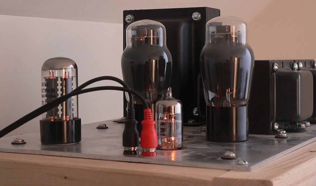

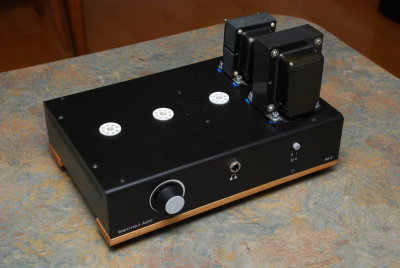

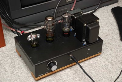

Just to add to what Ty said here - I originally bought a Wheatfield HA-2 it had a Hammond 270HX on it that was noisy as all heck. And like Ty, my listening environment is very quiet so mechanical noise is unacceptable. So I replaced it with the 370HX and the amp was essentially silent thereafter. The 370 also ran cooler, which was comforting on an amp running its transformer that hard.
I remembered that I had pictures of before and after mods on my HA-2, this should give folks an idea of the difference in size between the 200 and 300 series trafos.
Stock HA-2
Modified HA-2
One other note, the quality of the finish on the 370HX that I got was significantly better than the 270 that came on the amp. Not that this means a thing regarding performance but I thought it might be worth nothing just the same.

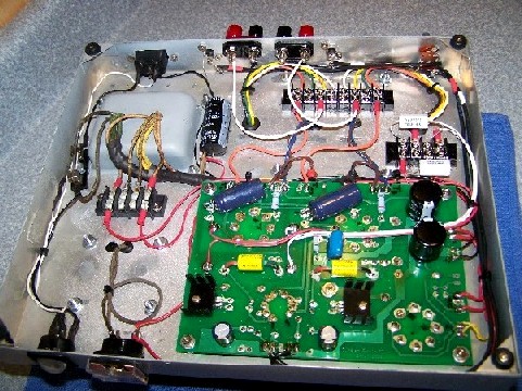

Hi Ty and guys,
When I overhauled my Simple SE, I thouht about making a daughterboard to hold multiple cathode resistors similar to your concept board.
Ultimately, I took a low tech approach and just moved them off board on a barrier strip, as shown in the picture that should attach to this post. This Simple SE can accomodate almost anything. I can change the secondaries on my pwr txfmr, plate load, degree of cathode feedback, and cathode resistors with just a screwdriver.
This board is starting to look a little rough because it has had a hard life. A lot of things have been turned up until they exploded, and then backed off a little bit!

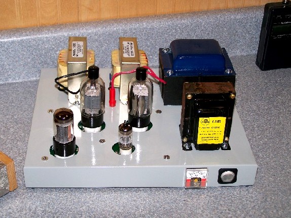

I did not bother with a daughter board or anything complicated, I simply used cable ties to strap three resistors together. The resistor closest to the board is soldered to the board. This resistor is the highest value you need and is always in the cct. The other two resistors are calculated to give the two lower required resistances when parralleled with the first resistor. The other two resistors have one leg soldered to the first resistor and the other leg goes to a three position switch that is either open cct or switches either of these resistors in parrallel. Took a few minutes to wire up. Used the hole in the chassis that was used previously to switch between SS and valve rectification to put the 3 position dual pole switch. Quick, simple, effective, cheap and no extra parts or chassis work required.

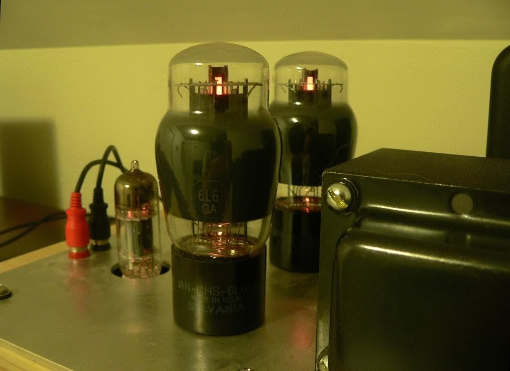

Well, I finally got around to doing this to mine. Even before I even decided to build a Simple SE, I wanted to use this beautiful pair of 1945 vintage 6L6GA. I used them as the "models" in my chassis design concepts. Unfortunately, they told me the Simple SE voltage would be too high to safely run these tubes. The choke input seemed like a good way to drop a lot of voltage without having to swap out for a different power transformer.
I found a spot to sneak in a little Triad C-24X, which ends up being the second L in the filter. The larger Hammond 159Q is the input choke. The hardest part was cutting the trace on the circuit board - for two reasons. I hated to make a more or less permanent change to the board, even if can jumper around it later to reverse the mod. The second reason was the copper on George's board is really thick, and even with a sharp X-acto I had to work a bit to get a clear cut.
With the choke input, B+ is about 335 VDC. I'm wondering if I should make any other changes, perhaps to the cathode resistors (currently 810 ohms) or possibly jumping out R14 to account for the lowered B+. I do need to make a quick measurement of the 6L6 cathode voltage, and also of the 12AT7 plate voltage. But first, I'm going to take a little time to finally enjoy these sixty-five year old tubes.
http://i69.photobucket.com/albums/i43/Ty_Bower/Simple SE/P1150138.jpg
http://i69.photobucket.com/albums/i43/Ty_Bower/Simple SE/P1150148.jpg
I don't think you will need to jumper R14/24. For the 6L6GA and 335 volts, 470 ohm would be a good starting point for the cathode resistor.
With that B+ voltage, 6V6 and 6F6 will work well. An 810 ohm cathode resistor is about right for them.
Win W5JAG
I measured the idle current for the 6L6GA, and came up with about 33.6mA average. That's only ten watts dissipated in the tube. I'll fiddle the cathode resistor and see what happens.
I popped in a pair of 6V6GT, and they sounded just fine.
