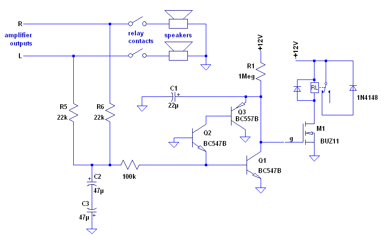

Another simple DC protection
R5 & R6 bring down the offset current to non damage levels.
The two resistors allow just 1.1mA to pass from 50Voffset to the good channel.
Of course. 44Kohm resistance between left and right output. This seems a lot simpler than the first schematic I posted with all of the diodes, and obviously the FET will hold it self on until the power is removed, therefore no need for a PIC at all.
The gate of Q2 is connected to ground! How can this ever switch?
And can +25v be used instead of 12v?
Q1 detects positive dc voltage.
And Q2 detects negative dc voltage.
To switch ON Q2 you need 0.6V between base and emitter.
So If we connect base of a Q2 to GND (0V) we need -0.6V on emitter to switch ON Q2.
C1 provides soft-start and C2, C3 can be replaced by one electrolyte capacitor because all electrolyte capacitor can handle -0.7V for a short period of time.
yes you can.

jony, I built the circuit. When I power it, the relay energizes. When I put + or - volts to the input, the relay clicks off and stays off even when I remove the + or - from the input. So it seems to be working..... Now, to reset the circuit, the power needs to be removed and then re-applied. When I do this, it takes forever for the relay to energise. If I remove the 2 x 47uF caps, everything works the same and the circuit resets immediately after the power is applied.
Is this normal?
Ok. I'm not sure what is actually going on....
I have a 1meg resistor as in the original diagram, connected to a 1uF cap. and 2x 10uF caps connected in reverse where the 47uF caps are in the diagram.
When I first connect, there is a slight delay and the relay energises.
When I put + or - onto the input, the relay de-energises (OK so far)
I remove the + or - and after 4 or 5 seconds, the relay energises again, shouldn't it stay de-energised until I cycle the power on and off to it? (Or am I getting MOSFETS and Thyristors mixed up her?)
This delay is cause by C1
seems OK for my.
To achieve this you need softly modify the schematic
yes you can.
Hello all,
Regarding to circuit at post #37, can i connect more than two channels each with 22k resistor additionaly via proper relay?
Thanks.
Yes extra 22k input resistors allow the detect to monitor extra channels.
But beware.
If you get opposite polarity fault signals, they can cancel out and the detector sees nothing wrong.
Further, as one adds extra channel/s the sensitivity drops.
