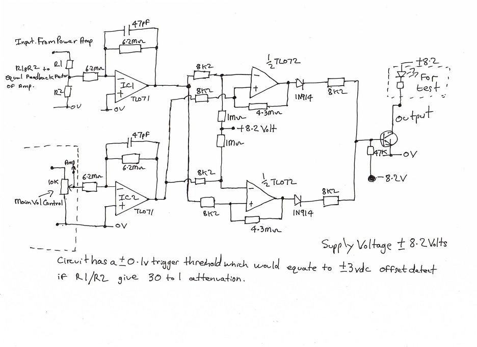

All these circuits so far rely on a time constant (to filter the audio) and although we all hope we never need the protection in practice, if we do... is it quick enough to prevent damage ?
Although I never developed this idea further (there should be a thread somewhere, although I can't find it), this working prototype aims to eliminate that delay by comparing input and output of amp. If there is a difference... the relay trips. The delay is now just that of the mechanical properties of the relay and the way the coil is driven.
