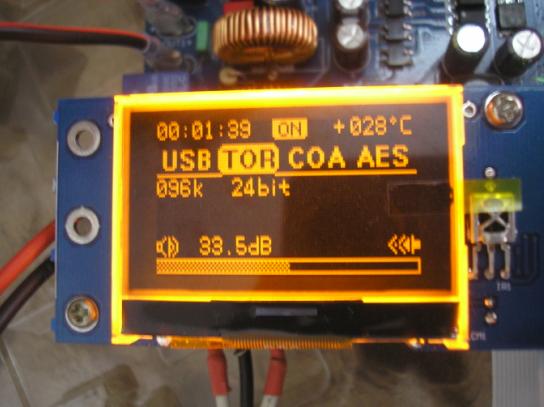

The temperature sensor is included in MCU, so I just don't want to waste it.😀
Me want 🙂
any idea to improve?😀

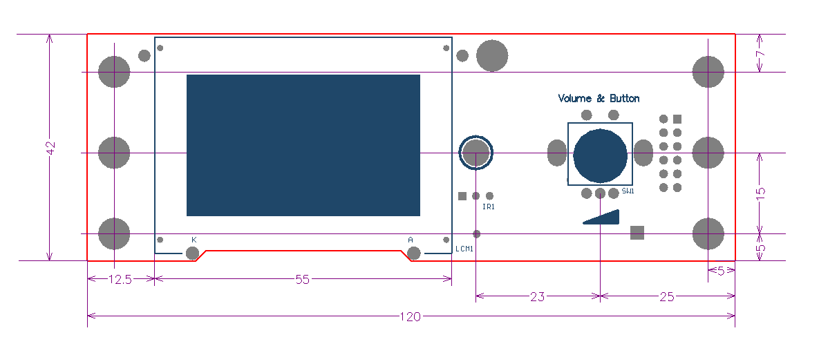

I'd recommend detaching the LCD and the control knob from the PCB (e.g., connecting them with wires and Molex plugs), so they can be moved around and installed in different locations. If the screen and the knob are fixed in place, it'll be hard to make this panel unit look good in an aluminum case (remember, most of us don't have professional machining tools 😉).
Along the same lines: it would be useful if the LCD came with a metal frame that has screw holes. That way, it could be attached to the outside of a case and all you'd need to do is drill a small hole for the wires.
It may be too late to make these changes now . . . but it's stuff that would be cool to see in the next version (the "modular" one? 😀).

Yes, yes, yes! There's no point in having an LCD screen when you don't have the machinery to cut out room for it in an enclosure.

Probably LCD would be nice on a board smaller than it or same size so we can mount it easier. I agree with the other guys.

Thanks guys, for your valuable advice.
I think I have to finish current one first, as good as I can. And then we will think about other form. It will be a exciting experience for me.

Optical and coaxial accept 96kHz/24bit and usb 48khz/16bit.
1st thing you need to remember is that the display must be visible for a distance, I.E. 3 meters app. Too small font will make it useless as you have to get up every time just to see what it is displaying.
2nd thing is the color of the LED. White is in my oppinion neutral although red or green is pleasing to the eyes at night if contrast allows it.
3rd Is there any way to dim the display or timer turn it off when not in use and watching movies?
4th is there no way to support 192khz/24bit material with this chip (or in general)?

3 digits for temperature display (028°C in the above example) is overkill i guess. We don't expect it to go over 99°C 😀 display simply 28°C would be nicer.
