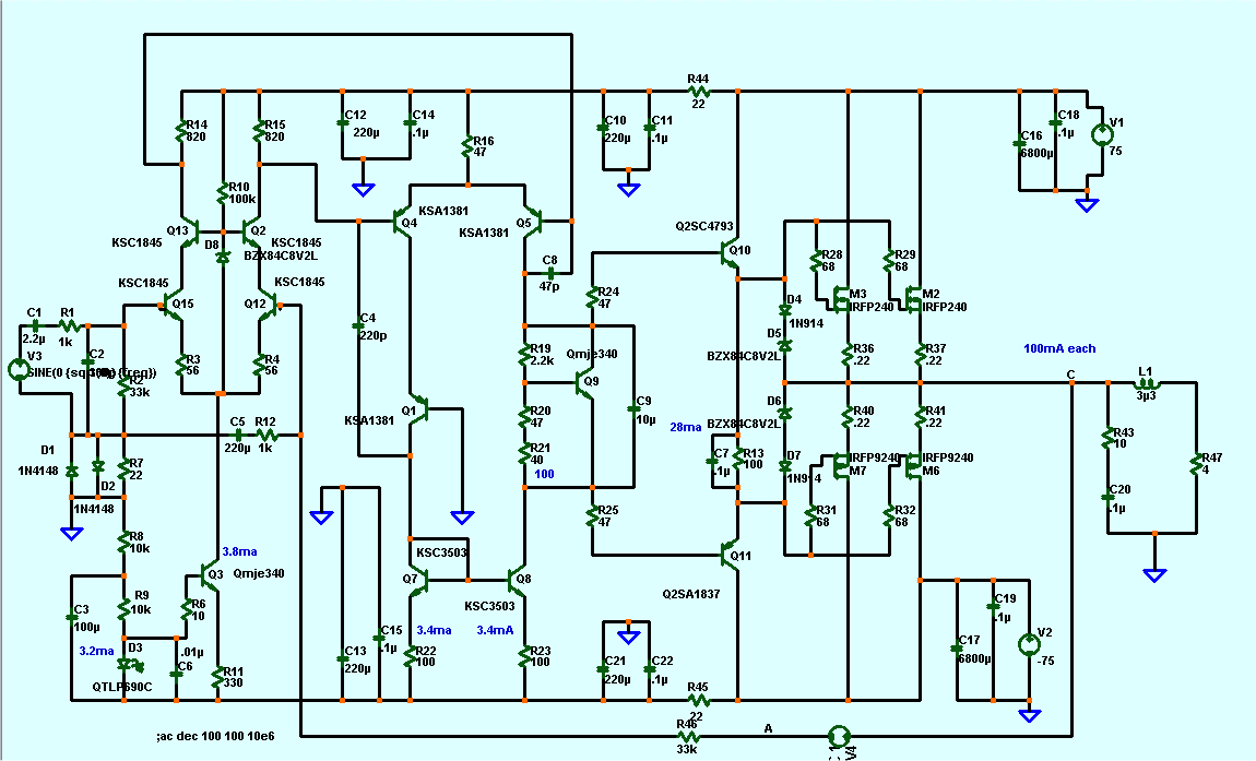

lee , your amp looks a lot like mine. I have run IRF's on mine in the real world and it works. Your bode plots lack sufficient open loop gain and are a bit undercompensated. Your amp might not outright break out into oscillation , BUT , with those voltages and 10 pair OP's , I'd be careful. The KSA1381/KSC3503 gaingroup E or F will get you that 70DB open loop gain . Drivers don't work well for a VAS.
Below is the amp as I had it and the loop gain as it should be. I only used 2 pair. You should build with 1 pair , test it out at low power / w - scope. Then run full monty. what is below works , holton's amp was the role model.

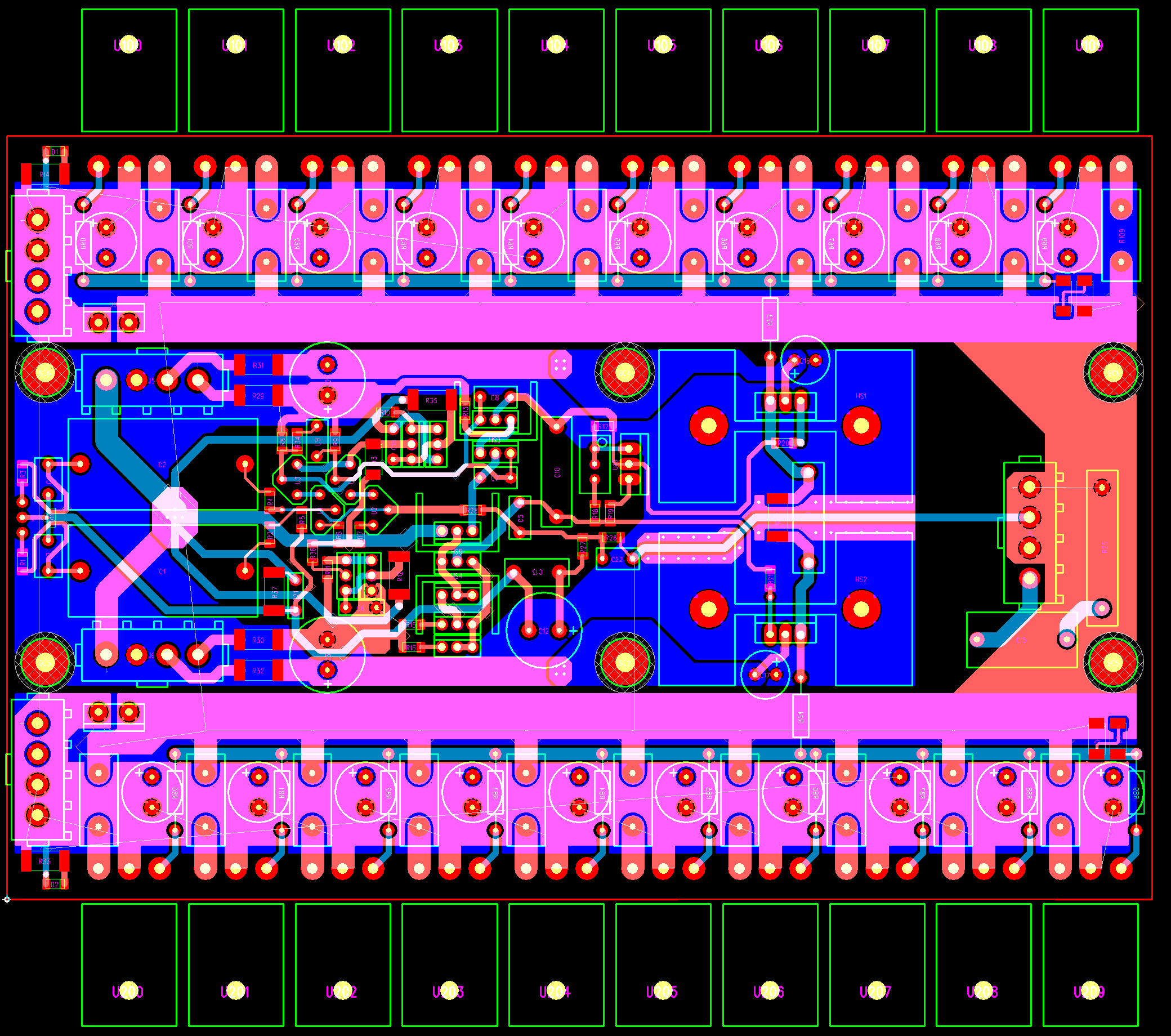

Routing
hi Lee,
I like the way you routed the AGND and the real small groundplane you created on the PCB bottom, it will work o.k.
The DGND plane is maybe a little overdone, but i don't think it will create problems. If you wish you could reduce the DGND plane, but let it exist under the Hs1/Hs2 heatsinks.
Enjoy the summertime!
regards,
Piersma
hi Lee,
regards,
Piersma

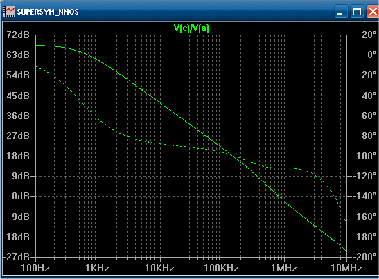

questions??? I am not the only expert here , but here goes.
1. I an glad to be of assistance.
2.What you see on my last post is ideal ,it worked with the IRF's and the BJT's. What you propose with the HUGE array of arc welding MOSFETS should be prototyped and tested,tested ,and tested with just 1 pair, ... BEFORE you extend it to 10 pair.
3.For an unregulated input stage PS , the zener is best. I now use a full capacitance multiplier or at least a CRC filter between the output stage and the VAS/LPT. For an amp of this caliber , I would consider fully separate supplies.
4. This is standard, look here....Project 101 - High Power, High Fidelity MOSFET power amplifier
and this is the "way" on just about my whole lateral/vertical mosfet project collection.
5.A current mirror is worth consideration if you use a FET input pair at low Ic... the loop gain is too low and a CM doubles what you have.
OS
Hi Ostripper
1. Thank you very much.
2. You were right: The amp was totally undercompensated. I didn't care about compensation and just used the one from the AV amp. Now it's much better.

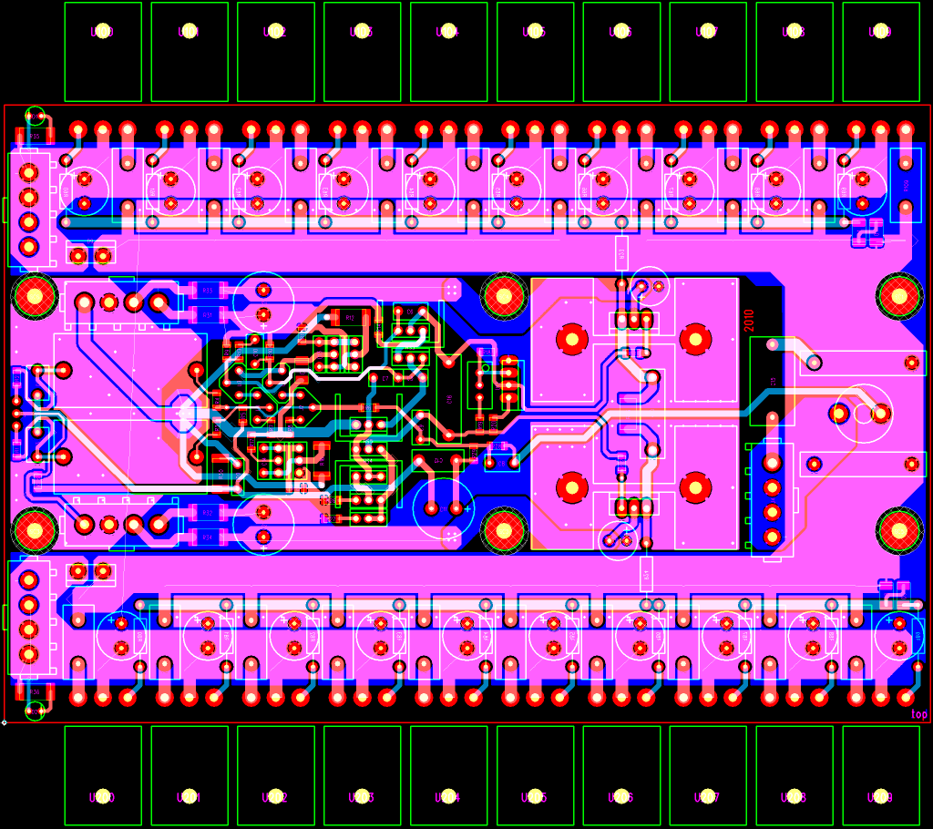

After some minor changes I think the amp is ready for a prototype now.
I gave it a name since every amp needs a name:
official name is: Lee Knattas Weld-a-Sym
(inofficial name is: Piersmas Knattasym )
Layout has changed as well. I decided to replace all SMT capacitors with THT ones for reliability concerns. Although I soldered several thousands of SMT caps by hand and till now the boards are working I prefer THT caps here. The SMT parts were just habit. Hand soldering puts a lot of thermal stress on them and they might crack immediately or they might crack later because soldering weakened them or because of board flex. I'll keep the SMT resistors for space reasons and because they are less likely to be damaged during soldering and I can change them with the board mounted to the heat sinks.
I will order boards next week.

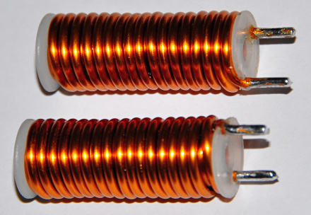

By the way: How do you like my DIY output inductors?
It was very hard to find small coil formers. (That's why there wasn't any progress for some time...) They measure 12mm diameter and 30mm length. I used 1,5mm diameter wire. Inductance is 3 uH, series resistance 10 mOhm. The inductor design is a compromise between size and performance.

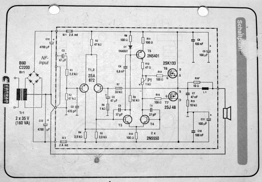

Hi all
Cleaning up my design directory I stumbled across the schematic of the amp I built maybe 10 years ago. I just took a photo and posted it here:
http://www.diyaudio.com/forums/solid-state/166212-amp-circuit-2sj50-2sk135-2.html
But didn't notice that the amp also has a topology similar to the *Sym ones. Funny, isn't it?
Just because I'm curious I simulated the schematic and was surprised it didn't sim as bad as I expected.
Best Regards,
Lee
Best Regards,
Lee

Attached is a preview of the final board layout.
The 3D view is nice to have but pretty useless since I cannot export to 3D CAD formats.

I finished board layout today and will order boards tomorrow (this time for sure).
