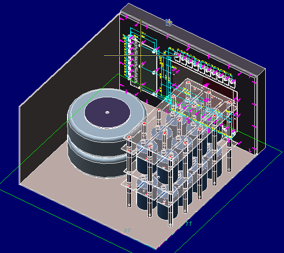

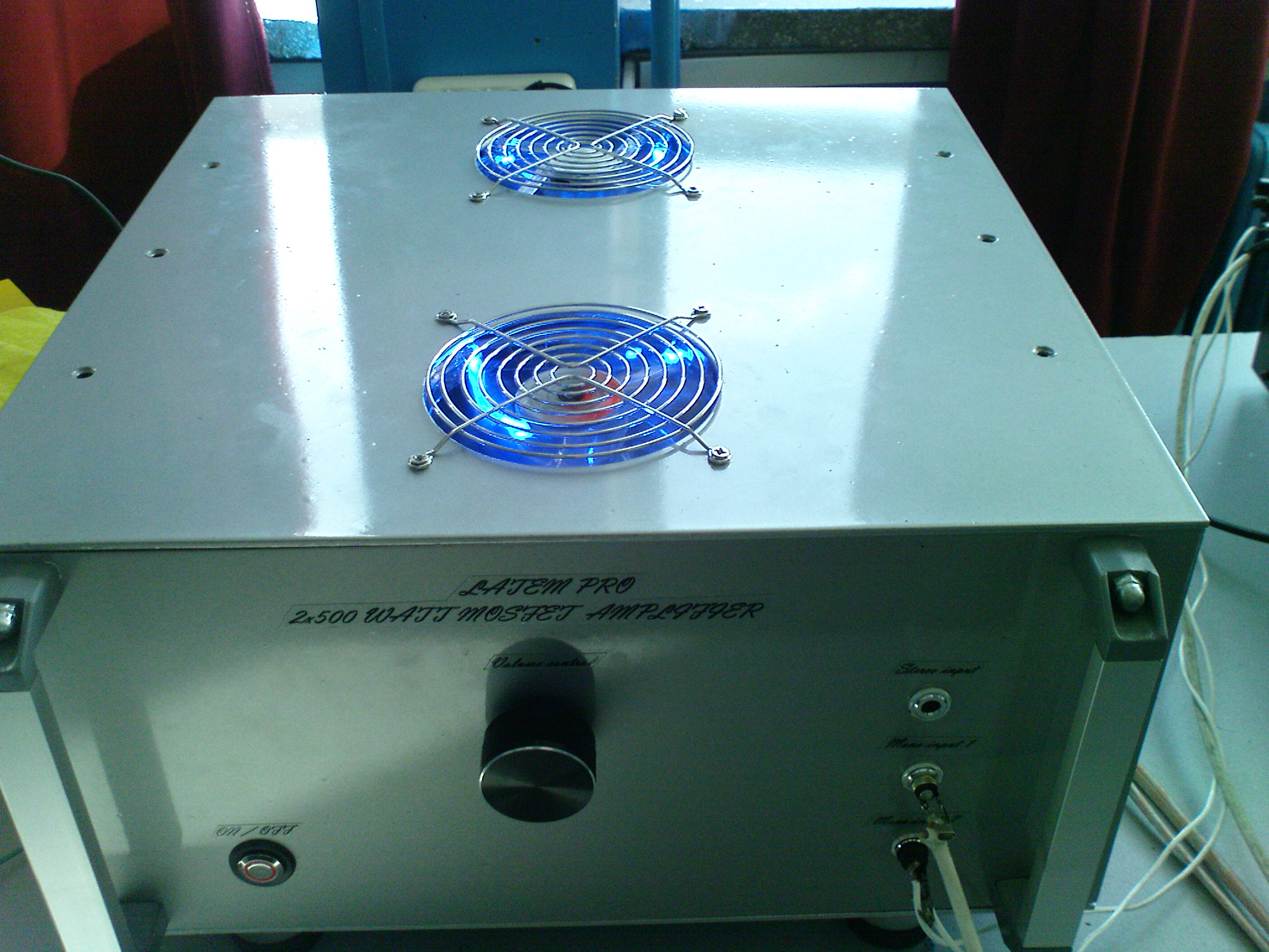

The last thing missing is a housing. First I wanted to have the interior complete and working. I have a concept already but I'm far from having usable drawings.
I enjoy great sound at the moment but I think this is not affected by the amplifier in any way. I believe amplifiers are actually inaudible. This is something one could debate about endlessly.

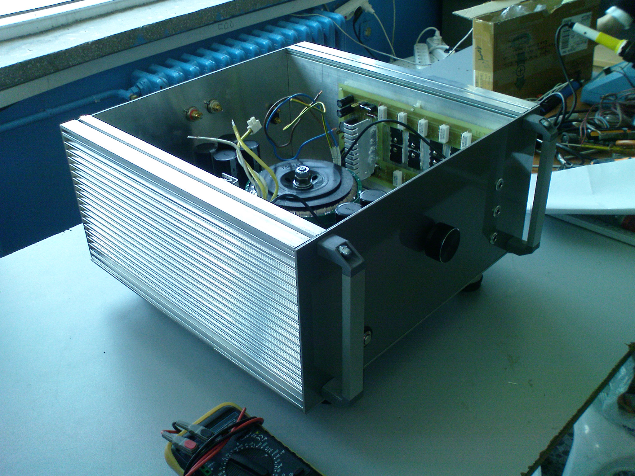

Hi Karl,
Sorry I missed your post. Somehow the notification did not reach me.
The smaller PCB is for the rectifier.
You should find the schematic in earlier posts already.
But I spotted some mistakes in the meantime and made some adjustments to components in the schematic.
This affects the inverting input. With the current resistor values CMMR is poor. With new values in theory up to -40dB could be reached but I expect much lower CMMR due to component temperature drift.
By the way: If you're serious about building this amp I would recommend to use a lower supply voltage. 90V is too close to the SOA. 70 to 80 Volt is plenty and gives more robustness.

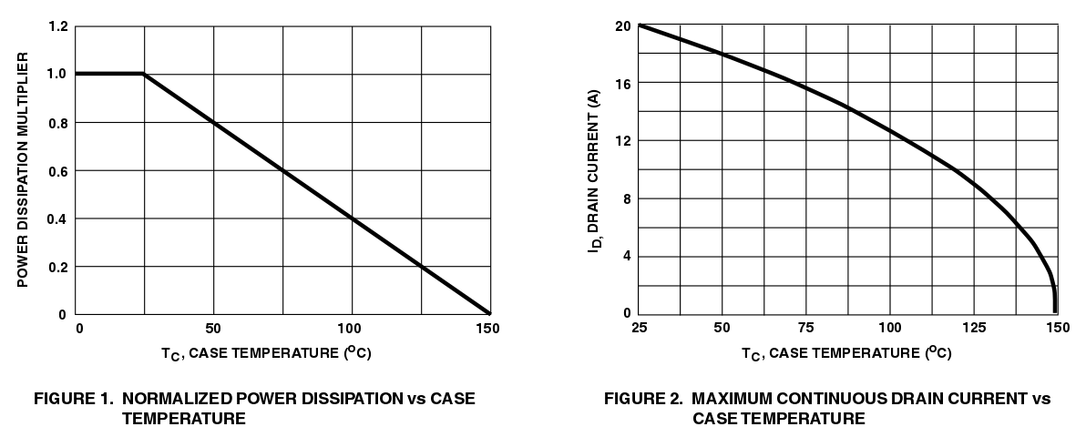

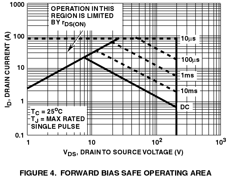

Hi Karl,
just send me a PM with your mail address.
I had a very brilliant colleague in my previous company and he had a look at the schematic and pointed out some potential issues like the SOA.
As far as I remember I was able to follow this.
The SOA for the IRFP240 at 25°C looks good:
But thermal de-rating needs to be considered as well:
With thermal de-rating the SOA at 100°C maybe roughly can be halved and there it gets critical.
I'm not sure whether this can be solved with more output transistors. There become harder to drive and quiescent current gets extreme.
My amp makes a good heater with roughly 250W dissipation idle anyway. You need to get rid of the heat.
Anyway, the amp is still working for years now but I never leave class A.
I have not electrocuted myself yet but may have a hearing damage already. 😉
