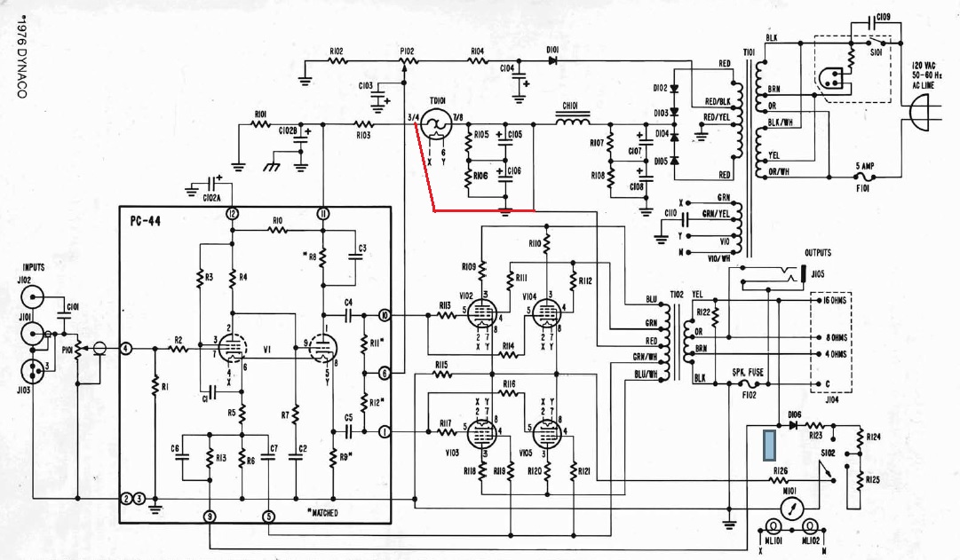

Hey Anyone,
When I rebuilt my Dynaco Mark VI's I added A CL60 NTC thyristor in place of the time delay relay tube. I placed it at the output from the power supply. In looking at the original schematic today I noticed that the original took the B+ for the output transformer from between the choke and the second filter cap. It seems to me that having the delay for the output tubes would be a good thing. I may be wrong on this. Attached is the original schematic. The red line is where my transformers draw power. Does it make a difference?

I personally don't like the bias circuitry on that amp.
If the wiper of the bias pot ever loses grip, it'll cause the bias to drop and destroy/redplate the outputs if you're not nearby, like in another room at the time.
A high value resistor (experiment) from the wiper to the pot on the side of R104 would save the tubes.
PRR
Joined 2003
There's no problem hot-starting 6550s at Dyna's voltages.
IMHO the delay-relay mutes the turn-on thump. Bypass it, wrap it carefully, and sell it on ePay-- they get good money now.
I never noticed, but the Bohemian has a good point about bias-pot failure.

The time delay tube make little sens AT ALL here providing that :
1/ the cap C102 has 500V limit
2/ a diode 1n4148 is mounted between pin 9 ( grid) and pin 9 (cathode) of 7199. This prevents the grid to have more then 0.5V more positive then the cathode, when tube is operating the diode is blocked and does no harm.
Switching powertubes might even harm them as a big "thump" will occur instead if a soft increase of current as cathodes warms up.

The amps now run 6CG7 front end with a 6CG7 LTP. Outputs are KT88's with fixed bias. I guess my real question has to do with inrush current. Before I put the CL 60 in it would blow the main fuse instantly. I'm also running more capacity in the PSU caps as well. Since the time delay tube only supplied the front end in the original it was probably for turn on thump. In my case it is there limit the inrush current. As it is the PSU charges the caps first. Then as the cathodes heat up and start to draw current the thyristor opens up slowly to allow current to flow through the tubes.
