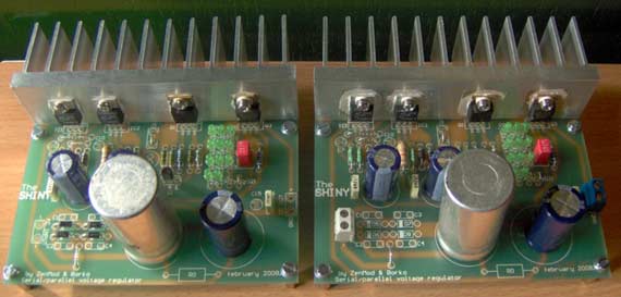

Hi all,
In case somebody agrees, here's the artwork of the Shinyy 🙂att'n: not yet tested!!!).
Guido
Massimo, in the next days I'll etch my sample: do you need one, too?
e-mail me 🙂
Guido

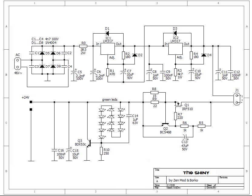

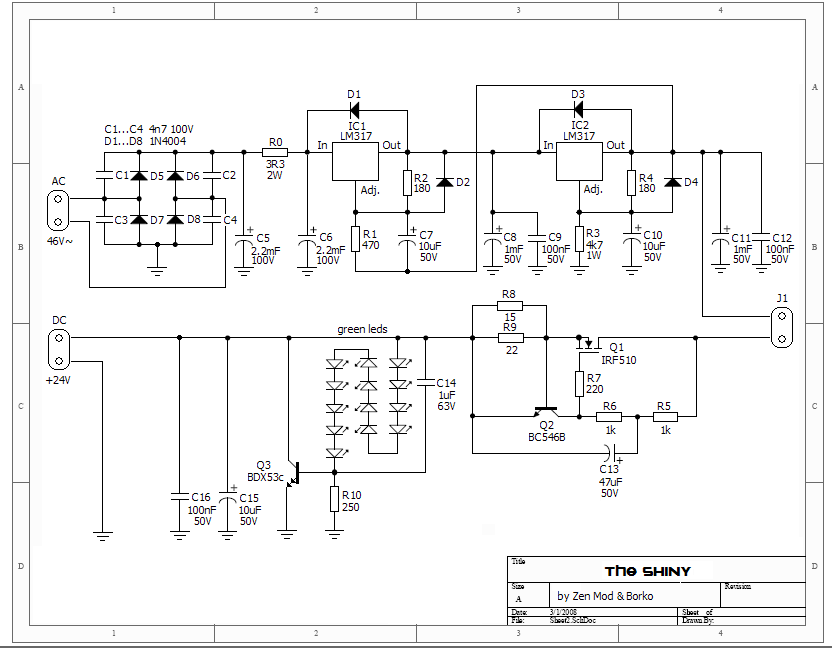

I built a shunty for the B1 but it won't turn on.
I hooked the circuit up to 42VDC and it draws like 60mA.
The section with the LM317s seems fine and puts out 27V.
But the voltage at the gate of the IRF510 won't rise above 5.7V. I replaced the FET. The one pulled from the circuit looks fine so it's likely that this wasn't the problem.
Could the BC546B be the cause?
(the darlington in the sim is not the actual one, it's a BDX53C)
The second channel I build won't turn on either, so I must have made the same mistake twice, hopefully.
Maybe someone can give me a hint.
Thanks guys!

circuit can't draw more than 0V65/R9
disconnect everything after CCS , then connect output of CCS via mA-meter to gnd and check current ;
on schematic everything looks good to me ; culprit must be somewhere in your actual implementation ;
did you checked twice orientation of parts , especially BDX ?
it's
Thanks a lot, choky, I think I'm on to something. I disconnected everything after the CSS and checked what current it would push through a DMM to ground. It's around 50mA, just as expected. Unloaded it puts out some 25V, haven't checked the voltage with a load, but will do tomorrow.
So the error must be in the shunt-regulator part. I'll check all polarities and keep you posted. Hope I see them LEDs actually emit someday.
Thanks a lot! :cheers:
For some reason I had the darlington wired incorrectly. Had the pinout right but messed up the wiring...
Well , now it's working. I'll post some circuit-pr0n tomorrow.
