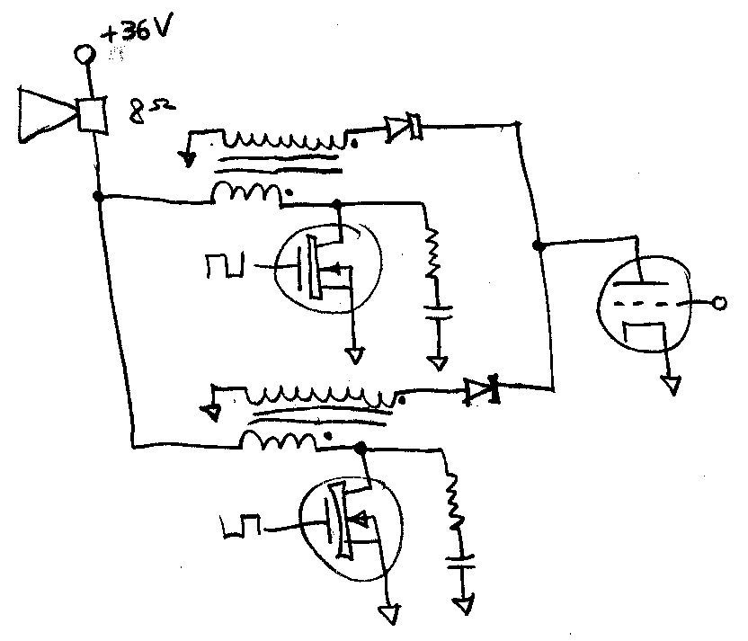

One transistor clapping
Here it is.
One transistor, one transformer/inductor, two caps. (C2 can be deleted here) and one diode. Although the design of the transformer/inductor is much more complicated here. This design has no ripple on the input current or the output current, and has isolation betwen input and output. A somewhat simpler design is possible without the isolation. Obviously, this is based on the Cuk converter, I shamelessly have copied it from the Cuk book. (the name is pronounced shuk, not cook unfortunately) A Mosfet switch would be more appropriate these days of course.
For either of these new designs, two such units are needed for a P-P output stage (just like for the Berning or SCIC designs), one for each tube. The other unit would use a P channel Mosfet and a minus LV supply for the simplest gate drive.
I should add, that for this 2nd design (Cuk), the duty cycle can be varied to adjust the voltage ratio (hence impedance ratio) and it still maintains zero ripple current on the input and output. So one could have an adjustable output xfmr. An "impedance adjust knob", a nice feature for experimenting with tube designs.
Some compromise in efficiency would be required for either of these to avoid EMI generation by slowing down the Mosfet transitions.

Here it is.

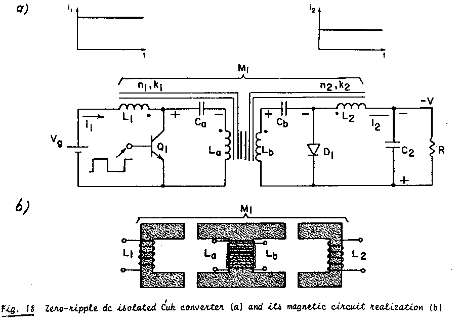

I need to point out a correction to my simplified dual boost converter xfmr design a few posts above. I mentioned it was ripple free on input and output, but it is only ripple free on the LV, or speaker side. The tube side would still have some HF saw tooth wave on the current/voltage. This may not actually be a real problem, since the speaker side is what matters, but it needs testing to check this out.
The Cuk converter OT above however is really ripple free on input and output. Not sure how well it maintains that though if you change the duty cycle however (ie, change the impedance control knob). The complex ferrite xfmr it uses requires specified leakage inductances and turns ratios to achieve the ripple free operation mode. These might need tweeking if one changes the duty cycle.

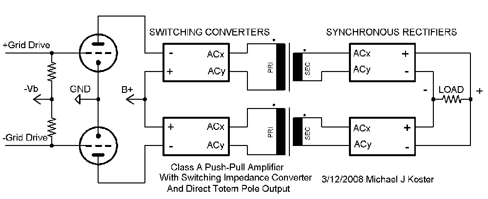

At first I was baffled by the OPT replacement idea but here's how I think I would do it. I'm still not sure about this; something doesn't seem correct but I can't find any error.
The basic idea is to down convert from the tube load impedance at B+ to Zout, and present the output as a balanced totem pole DC connection. The tube balance has to be good, maybe servo control or current mirror.
It seems like in class A the load would share the same way as with a conventional OPT, i.e. each tube sees 1/2 the total so each transformer ratio should be equal to the desired step down in this circuit since the secondaries are in series.. There might be several windings or toroids in series on the primary side and in maybe in parallel on the secondary side on each leg of the push-pull.
I'm still thinking this one through but here it is anyway:
"I'm still thinking this one through but here it is anyway:"
This would be the straightforward way of converting with drive power from the tube side. I was going to say just like Tubelab's, but after looking at his schematic again I see a problem there due to the capacitor in series with the speaker. The tube idle current will charge the capacitor up, and the voltage across the tube will collapse. Maybe this was part of the problem with the Fets roasting.
The synchronous rectification approach, and two converters besides, will use a lot of Mosfets though, and half of them at least will require floating gate drives. I think you will still also need some diodes in series with the sync. rect. Mosfets to protect them from reverse audio voltage.
It's really pretty tuff to equal the Berning design for economy of parts and effectiveness, even though it still uses a lot.
On my simplified converter ideas posted above, I have some bad news. The current ripple on the tube side of the dual boost design means there is a minimum current before conduction becomes discontinuous between switching cycles. So operation of the tubes would have to be class A to maintain continuity. Not real attractive, but useable still.
The Cuk converter avoids that one with it's zero ripple, but suffers another problem common to all the simple inductor mode converters. They have essentially a current source output Z, not a voltage source. Which means it has poor voltage regulation without feedback. This is the same problem (well one of them) that class D amplifiers suffer. So anything transformed thru these simple converters will look like pentodes and need global feedback.

Michael Koster said:I'm still thinking this one through but here it is anyway:
You don't need switcher supplies if you are driving from
the tube side. Drive both triodes SE, and bias into cutoff
with opposing square waves at the cathodes. Imagine a
6N30Pi twin triode as the top half of a cascode, above a
pair of switching mosfets. Let the tubes do the heavy
voltage blocking...
It is the synchronus rectifiers that are tricky. If the are
simultaneously on, its a dead short. If they are both
simultaneously off, there is nowhere for the inductor
to discharge but an arc... The overlap is a pain to get
right.
Fast recovery diodes are more cooperative, but there
is a forward voltage drop that makes them lossy....
And on the low impedance side, that can be significant.
I like the Berning design, cause it abuses simple diodes
that don't require fancy drive timing to prevent parts
from exploding. Who cares about a few diode drop on
the high voltage side? And the switch devices are all
kept to the low voltage end...
As for Transonars, Rosen type with about a 20x step-up.
Sometimes used for cathode backlight with a flat screen.
Probably the easiest way to find some for experiment.
Yes, the Berning design is elegant and effective. It has a number of advantages including replacing the B+ supply. Diodes are insignificant on the HV side, switcher is easier on the LV side. Both designs probably need to segment the primary to get the capacitance in series for the same reasons.
My design is just another way of doing it that drives from the tube side It does take more parts and basically needs gate drive transformers with well-designed timing. I guess I'm comfortable with that kind of design but by comparison there seems to be no advantage except it's not patented (yet). The output based drive appears to have some advantages.
Hmm. I have an old Hafler amp with blown up MOSFETS. It has a big bipolar DC power supply. I could prototype the output based drive scheme on this chassis. It is 150W/channel class AB SS so should be good for 20W class A easily.
More food for thought...
Michael

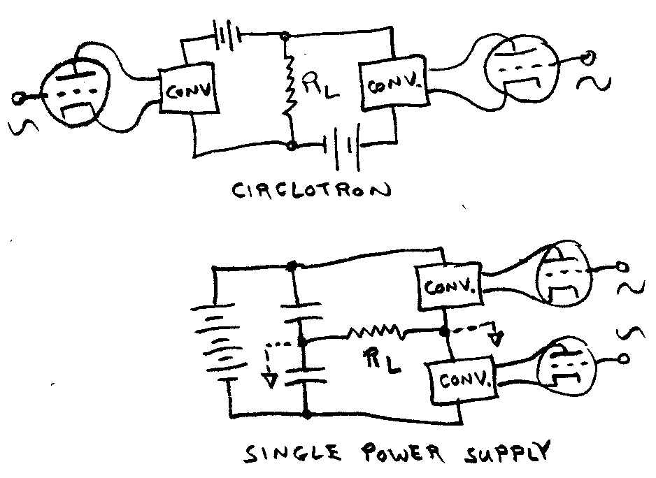

Topological Variants
Here are some topological variants on the Berning converter.
1st a Circlotron converter.
2nd a single power supply converter.
Output ground can be put at either end of the load here as indicated. Putting the ground at the power supply end is probably the best if using a switching power supply.
Don
Don
Here I am taking a clue from George's design, but adapting it to the undiriectional current flow for the Berning type converters (or SCIC).
Its seems a bit redundant to use two converters when we are only transforming a single signal. So I have done P-P to SE to P-P conversions here to get down to just one converter.
The switched mode CCS blocks are switched inductor current sources (minimal power loss). Their currents are arranged in accordance with the converters "turns" ratio in order to balance out (recall that the conv. is true DC to DC, so the CCS currents will balance out thru the converter).
Counting Mosfets (asuming two per CCS for ripple free currents) however still comes up to the same number as using two converters.
I think there may be a new design option surfacing here.
1st, the two switched CCS's are current related by the same ratio as the converter ratio. Seems they could be combined using the same inductors with two windings on each core and using the same Mosfets for automatic current tracking.
Now I may be going out on a ledge here, but I am wondering if the converter itself could not be implemented some how using the same two switched xfmr CCS's as well. After all, the CCS cores have the same audio signal voltages imposed on them. Some more thinking called for here, but seems like the converter could just be deleted...... somehow.
Don

Re: Topological Variants
I think that the current mirror output stage is a natural because it's DC self-balancing.
I like the way you show the tube and converter as a building block!
There are a lot of different topologies. These look like simple rearrangements of the basic totem pole load connection. Do the current loops differ in any way?
Yes, last night I was getting ideas for factoring out some redundant paths also but nothing concrete has fallen out yet.
I will need to study your CCS some more...
Michael
kenpeter said:Going Berning on top, AntiTriode on bottom?
smoking-amp said:Here are some topological variants on the Berning converter.
Don
