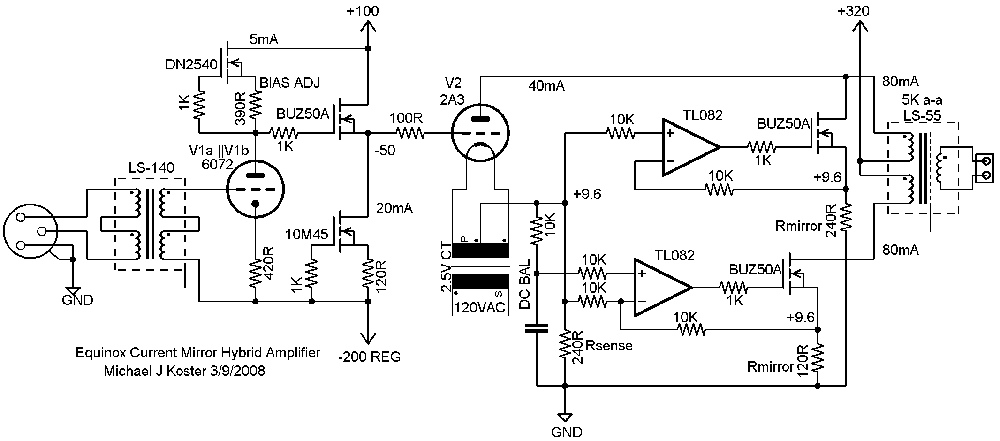

Roasting the sacred cow
Was actually thinking of replacing the OP-FET arrangement
in one or both current mirrors with TI's new heatsinkless
Class-D chips. As long as its slave to whatever the Triode's
RSense tells it to do... And the tube participates in driving
the real load.
Its not a simple transfer function fn(vGrid)=rPlate, but a
three terminal fn(vGrid,vPlate)=rPlate, involving all the
dynamics the OPT, power supply, and loudspeaker may
react upon vPlate.
One has to be very careful not to dumb it down and isolate
the tube from the load, or its just a fancy pile of sand. I think
everyone posted here in this thread already understands
this, but I still wanted to make written record of the point....
We may be cheating, but carefully cheating only the right
things. Perhaps even the OPT could go... Yet even with
OPT, no reason any mirrors must work exclusively upon
the high impedance side.
One might still want the Tube B+ to sag (for reference),
even if assisted by regulated low impedance B+ through
the slaved mirrors.
If everything sand does only what the tube tells it to do,
we must still make sure the reference tube sees nothing
abnormal in the load that might make it act un-tubey....

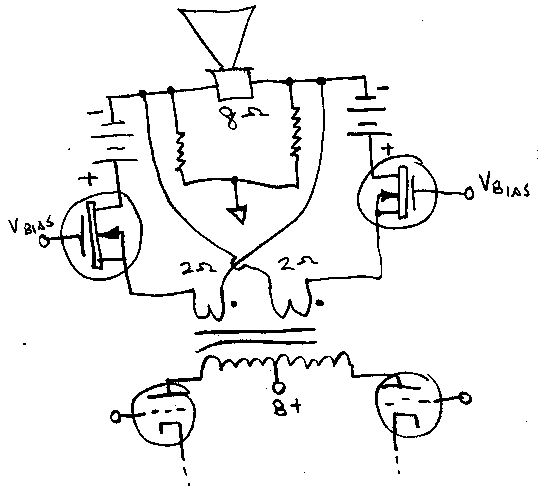

I experimented with a solid state "current booster" on the output side of the OPT. It was one of those experiments that I didn't talk about. This doesn't mean that it isn't a good idea, only that I didn't know how to do it!
Again, this experiment occurred several years ago. The mosfets that I used were already a few years old and have a lot of gate capacitance. I have learned a lot in the years since, and I wouldn't base any component decisions on those old experiments. The BJT has a SOA limitation that mosfets do not generally have. I blew up a few transistors before I found the MJW21195. It is the only one that could (at the time) handle 250 volts and 200 mA simultaneously. It is important in the "darlington" circuit that I used that the device have a relatively constant beta over the current range being used.

I've thought about putting the SS current assist on the secondary side of the xfmr too. The circlotron (or a totem pole output stage) works well for putting bipolar darlingtons in the cathodes to current drive the secondary. Sziklai bipolar add-ons for tubes waste too much power. Likely to get stability problems unfortunately in any case with the xfmr phase shift in the local loops.
There is a very fancy composite amplifier way to put current assist on the secondary. Basically uses a SS current output amplifier that parallels the tube output with a current sense resistor in the speaker return lead between the tube amp and the SS amp gnd returns. The SS current amp tries to zero out the return current to the tube amp, effectively unloading it. The tube amp sets the voltage still. Requires two complete amplifiers, so expensive. And may have some stability issues to deal with using real speaker loads.

I'm not afraid to try something new, but I think the next step for me is scaling this idea up a little and using a linear tube. I want to explore the sonic potential of this in a practical HiFi amp.
How about 16 watts from a SE 2A3 with a damping factor of >6 ? With 4X current boost the 2A3 can play into a 5K load for a very linear load line. The "anode" efficiency is about 30% in this case; 16 watts Po from 52 watts B+.
This is something I already have the parts for. I thought I would add another piece of sand or 3 to the driver as well after perusing the tubelab.com site.
Using a MOSFET voltage follower allows me to build a 2 stage amp with more gain and linearity in the first stage, and use what I consider to be a great sounding tube, while providing good drive to the output tube.
Actually I guess it's a 3 stage amp if you count current gain as a stage... Anyway I was thinking of a DC choke coupled design and decided to give DC + MOSFET coupling a try.
This way if I get a loose socket pin in the driver I blow up not only the 2A3 but a couple of $10 MOSFETS also. I will use a fuse to protect my UTC iron, though.
Michael

Here's a type of transparent booster on the secondary side. I believe it gives 2X power out compared to the tube output, since the voltage gets doubled. The tube amp sees 1/2 the voltage and 1X the current on the load thru a 2 Ohm output, so Zload is doubled effectively (ie, 4 Ohm load on 2 Ohm output).

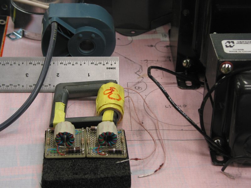

Transformers for these applications should be dead simple and tiny. My full bridge switching converter used a transformer core less than one pound (way less I think) and was good for 400 watts. A 20-50 watt tube amp converter would not take much cross section at 200 KHz. I think I have some toroids. Imagine... cheap tiny ferrites... A whole converter for 50 watts could fit in a shirt pocket and weigh less than a pound, heatsinks and all. I guess you would want more for a bass amp...
All of this with the goal of delivering what Berning calls the subjective performance of tube amplifiers, having "no analog signal processing by solid state devices"...
However I wonder about the subjective contribution of core saturation, which would presumably either not occur or occur with different results in the switched converter designs. The musical performance of an amplifier is in part determined by it's response to transient overload conditions which occur normally in most music due to the 14-18db (or more) dynamic range above the VU meter's top reading. Of course, a lot of today's recorded music doesn't have this much dynamic range for other reasons but that's another rant..

Here is the magnetics package for the 400W full bridge phase modulated converter. (The big iron in the background, for comparison, is for a 200W line frequency power supply for a 16W class A tube monoblock using 300b P-P.)
The "big" U-core was used with the HV potted secondary and 80T litz wire homemade primary in the yellow tape. There is a small air gap, not for DC but to add inductance for the switching scheme.
The mounted toroids are homemade gate drive transformers using a small ferrite toroid wound with loosely twisted #30 kynar wire wrap wire. The extra capacitive coupling functions as mixed drive and these worked really well.
The sconverter used an OTS controller and dual MOSFET driver chips with controlled edge rates.
A <100W converter package would be much smaller but then 2-4 of them are needed depending on the topology.
