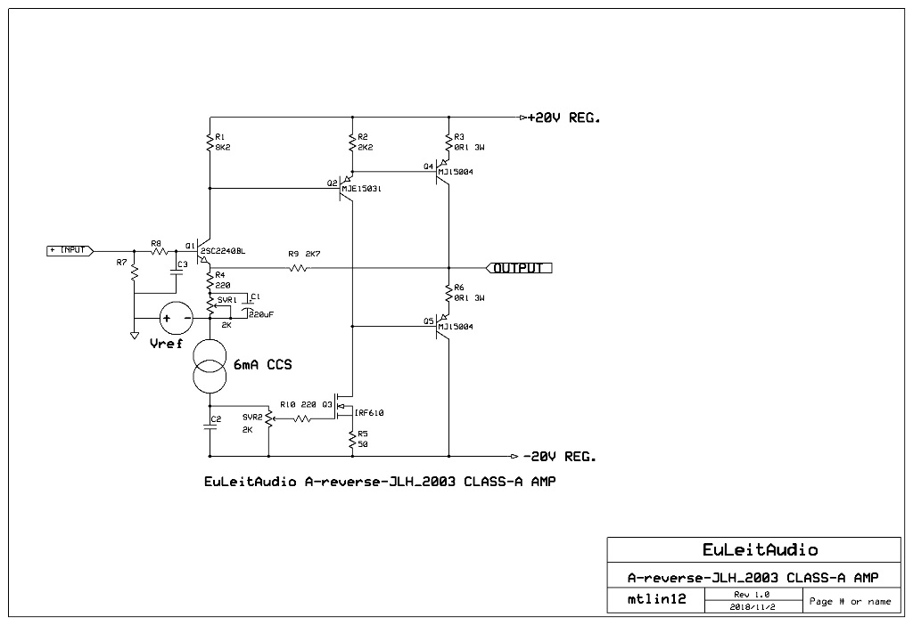

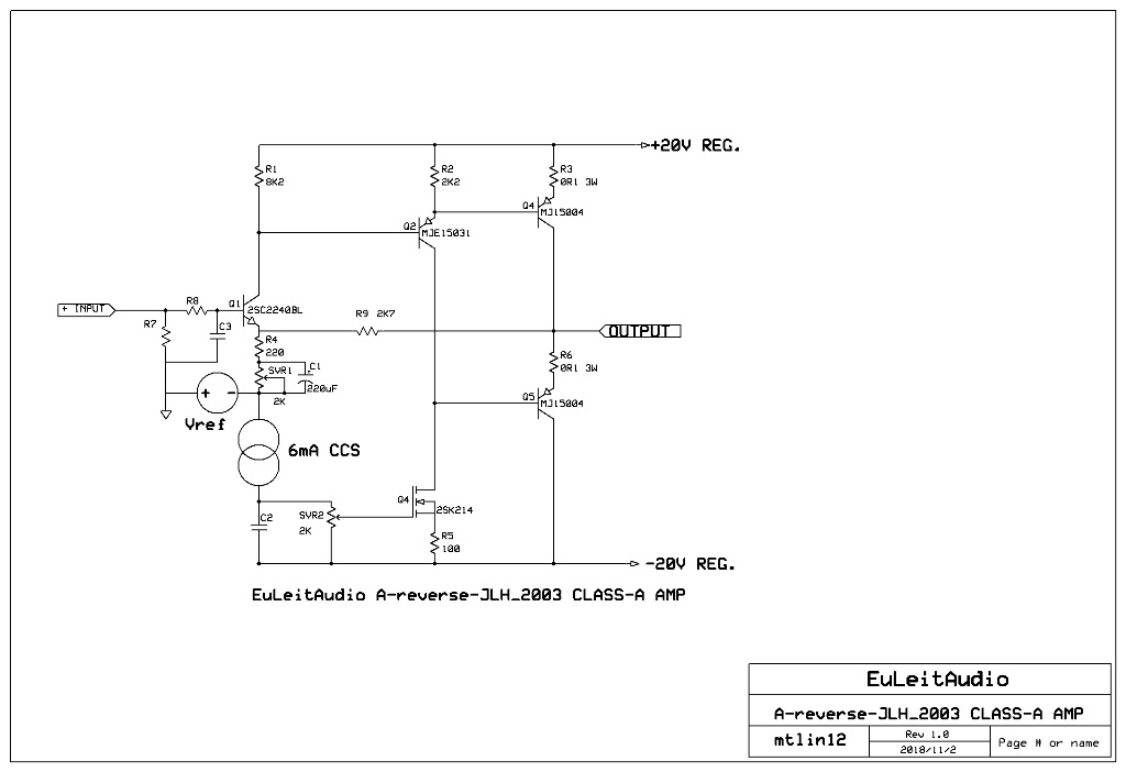

This morning I try to change some MOSFETs to BJTs, and the circuit looks like this, some were not changed to fit in my old PCBs.
2nd stage's CCS I still prefer using MOSFET, R5's value is not yet settled, I have several 0.1% of PHILIPS 100 ohm, best for measurement.
Thanks again N101N.
Thanks again N101N.
2SK214 is now also difficult.
So for others one can just use a DN2540 with a trimmable source resistor as current source.
Self biasing.
Patrick
Thanks, I have DN3545 but not many, and it often breakdown, I prefer using IRF610 instead though the Vgs is much higher than 2SK214, so I'm thinking lower the R5 to 50 ohm.
A high Vgs of the MOSFET does not mean a similarly high minimum headroom (Vds) of the CCS.
See figure 2 of the Vishay IRF610 datasheet.
Patrick
Another thing is power dissipation, my DN3545 is TO-92 package, IRF610 is TO-220AB much better than DN3545 or DN2540.

My DN2540's are TO220.
But I always prefer JFET for CCS due to lower noise.
For example a cascoded 2SK246 degenrated to 2mA has exceptional dynamic resistance.
Patrick
I like JFET CCS too, but right now normally I use DN3545+2SK170 cascode type for higher Vds needs, also provide higher current.
LM334Z has higher noise only no need to be trimmed, so I still use DN3545+LM334Z+Diode to lower tempco.
but have to add a 0.1uF to lower the noise.

From my own experience with the JLH topology, both with the above mentioned FET version and with BJTs
https://www.diyaudio.com/forums/solid-state/3075-jlh-10-watt-class-amplifier-142.html#post942914
there is IMHO no use just to have zero tempco with the CCS.
Everything else drifts anyway with temperature.
Vbe and hfe (hence base / collect current) of BJTs, Vgs or Id of MOSFETs, Idss of JFETs, ....
It is almost impossible to make the entire circuit thermally neutral.
So for peace of mind, either one uses the Cii in the feedback loop, or adds a servo.
Or one trims the DC and bias at steady state after 1 hour, and accept the lower bias / high DC at cold start.
Perhaps you have a different experience ?

Yes, plenty of them , FETs, BJTs even PCB & RELAYs blow many times all about thermal problems, not because of oscillation.
Like diamond-output-buffer-eats-trannies-thermal.html
Before these designs, normally I use differntial DUAL-JFET (LS-844 or 2N5566) input with NFB design, so thermal problems can be easilly controlled.
But when SPLIT or Power Buffer design is different, without total NFB sometimes it just get burned very quickly, maybe within 10 min.
Zero DC-coupled design is difficult without NFB, JLH-2003 fortunately quite easy to set to "zero".
