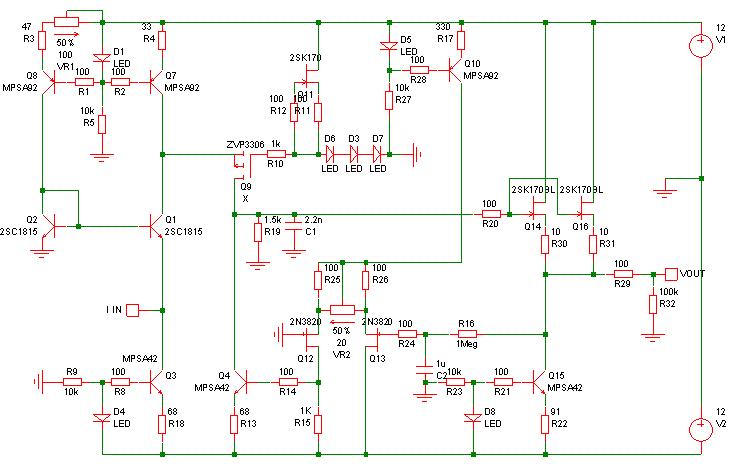

I get the components yesterday, then I tested the circuit last night.
More in depth this w.e…
“Jocko’s” circuit + folded cascode.
1) Resistor divider for Q1 base, quite nice… (PSRR)
2) Bypass to V+ or ground, not nice!
3) Insert 1k resistor between base and divider no peaking.
4) Much best results (PSRR) with a CCS instead of the resistor R1 for sourcing.
5) Right again ! Mosfet is obviously the winner 😉 (resistor divider for biasing).
But not listen to it yet.
Something amazing: DC offset at the output is very stable within +-/10 mV !!!
Later some measures graphs, and actual circuit schematics.
Triode_al you are absolutely right too, about the Vbe mismatches between Q12/Q1, I will focus on this point later, as I must reference the DAC outputs to 2.7V, as well as complete it for balanced mode… Still a lot of work ! 🙂
About sourcing, mirroring, I would try something else, I can’t draw it at the moment, I will post it this w.e.
Thanks for the link on tubecad, if you have a more precise link on dividers...
Probably tubes are often best in audio, the challenge is to reach them by solid state…
My amps are 300B non feedback 😉.
Test schematic.
I added the 220R base resistors, without them the circuit is prone to oscillations.
As I said without the 1k there is a peak in the response.
Update schematic.
What about this bias scheme ? (similar for Mosfet)
Ouuups.... 😱
Of course led's are inverted !, As they where just illustration schematics, I didn't care in drawing them, sorry.
Iam enjoying listening the mosfet circuit, it really sings 🙂
For the moment I use it with a PCM63 DAC and it makes a real difference compared to the 100R I/V resistor!

Extreme_Boky:
I am bit confused now, could you please make clear WHICH mosfet circuit you just referred to?
I referred to the circuit in post 22 “Update schematic”.
As I mod also the reference for the mosfet, the new schematic (for the moment 😉 ) is the one below (the one I am listening to).

Actual circuit:

Nicke said:
Perhaps a resistor at the gate of the MOSFET 😉
And some more current in the input stage...
The resistor at the mosfet gate isn’t necessary, this is "done" by R8 😉 .
Actually both stages run at 8 mA, do you think it’s not enough, 10 times the delta DAC output ? (+/-0.75 mA). I am talking about the AD1853, but for the PCM63 you are probably right, +/- 2 mA. Have you listen compared vs. differents bias currents ?
Sorry, in post 26 you speak about the original circuit,I thought that you where referring to the B.B./Elektor PCM63 output stage circuit… and not about the "Simple I/V stage" from Jocko vs. the one with folded cascode mosfet, in this case I can't say. I just built and listened to the circuit as in post 28, in the simple I/V circuit a capacitor is essential... For me is just an example of I/V conversion not a "full operating circuit", I could try one of these days.
I have in mind for DC-Servo, something like the circuit below. …If I correctly understand Jocko’s lesson…
The Mosfet and the circuit around it, replaces Q5 ccs in my last schematic (post 28). I will complete it after the design of the output stage buffer and with all the balanced input/output circuit.
It is probably right but the reason I suggested it was to lower input impedance.
No...not yet......
The one I meant was the original Elektor version with AD844 as I/V.Just wondered if you had the same experience like I did(a big improvement with a new I/V stage).
It will be interesting to the measurements when you make a differential version of the I/V stage...It shouldn´t be very much distortion left...

I don’t think that increasing current, even double it could make a such difference in the input impedance for the DAC, I believe that it depends more on the bjt device used.
I can try some measures in this way, but I think that it will not be so easy…
About the improvement over the AD844, or even a simple resistor vs. "Jocko's" circuit, absolutely agree with you! 😉
Right, in the differential version I expected less THD, especially THD2, even if this one is not so important for sound quality, but it could generate harmonics in the others components of the audio chain.

I took some measurements on the common base circuit input impedance vs. various idle currents:
04 mA Zin = 7.3R
08 mA Zin = 3.8R
16 mA Zin = 2.4R
I think, but I could be wrong, that 8 mA is a good compromise between input impedance, linearity and noise, with 2SC2547 or 2SC2240.
