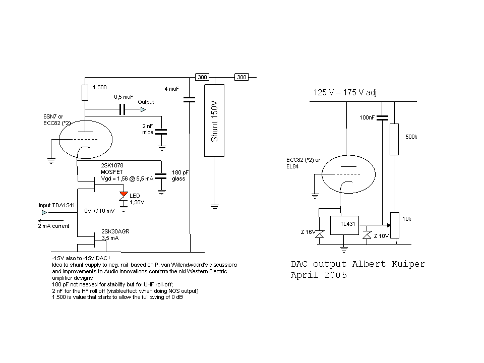

Hi Dad (?)
Attached find the scheme I am using.
The sound is “liquid” in NOS.
You state: “classic bjt CFP don’t sound “good” or musical, even if measures are much better”, this might have to do with the drain resistance.
Any case, the drain resistance of this 2SK1078 is rather low and that might be a reason why it is OK here.
It can be possible to replace the tube with a transistor like the 2SC1775 (very low Rb) and bias that on 5 V.
2SK1078 Power MOS FET Enhancement Type, SMD ----- Specs:
ON Resistance : RDS (ON) = 0.58 Ω (Typ.) at VGS = 10 V, ID = 0.4 A and > 0,8 Ω around 5 mA.
Vthreshold = typically between 1,4 and 1,7 volt (ID = 2 mA, VDS = 10 V)
Maximums :
Drain−Source Voltage 60 V
Drain−Gate Voltage (RGS = 20 kΩ) 60 V
Gate−Source Voltage 20 V
Drain Current pulse > 1 A
Power Dissipation > 400 mW
I have sampled to within 2 mV Tthreshold as I have some 100 pieces.
(Information from the TD62M4503AFN Toshiba chip with combines 4 of these devices).
I use the same principle of a cascade of FET and tube on my RIAA MC input (2SK240 + E88CC) though there with classic gate input. It is simply marvelous.
To me T9 in the RBROER scheme is to hide T5. This means that there will be no emitter temperature changes at T5 with voltage swing. The Audiophile ‘gang’ – Héphaistos specifically - recommend such measures. Actually I’d use something like that additionally also on T6.
