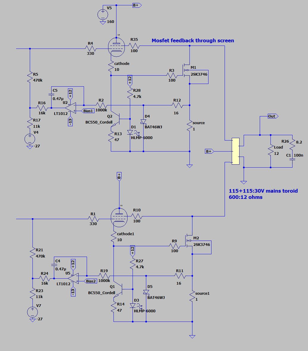

The jfet/triode pair sort of looks like an SRPP, but it's not because the dc coupling to the KT88 means the load is very high. SRPP's are optimally designed for a particular load impedance. Here the triode acts more like an active load for the jfet. If the triode was connected to B+ it would act like a reasonably good ccs and the jfet gain would be very high. However the triode plate voltage is swinging due to being connected to the KT88 plate, so definitely not constant current anymore.
With more reasonable dissipation for the KT88, maximum power output is more like 13-14 watts @ 1.7% THD which is about 33% efficiency. Which is about normal for a SET (which is effectively what this is). Also note you burn 8-9W in the KT88 cathode resistor.
Looks like there is some distortion cancellation going on, I tried the supertriode configuration that Broskie describes (where the triode is running at constant current) with worse results. So I don’t know if you will get any better by changing the input stage. Although the 12ax7 is running at 390V which is well over the maximum rating of 300V.
Attached is the output stage of the PP amp I mentioned earlier. The mosfets feed back through the screens of the ECL85 pentodes (doing it that way instead of just triode strapping the ECL85 lets the mosfet drain voltage swing lower). ECL85's are loaded by CCS on the cathodes (BC550 and LED). The opamps are there as an autobias for the mosfets, the schottky diodes clip the source resistor voltage to allow the autobias to work into class AB.
This is driven by a folded cascode LTP phase splitter utilising the triode halves of the ECL85.
