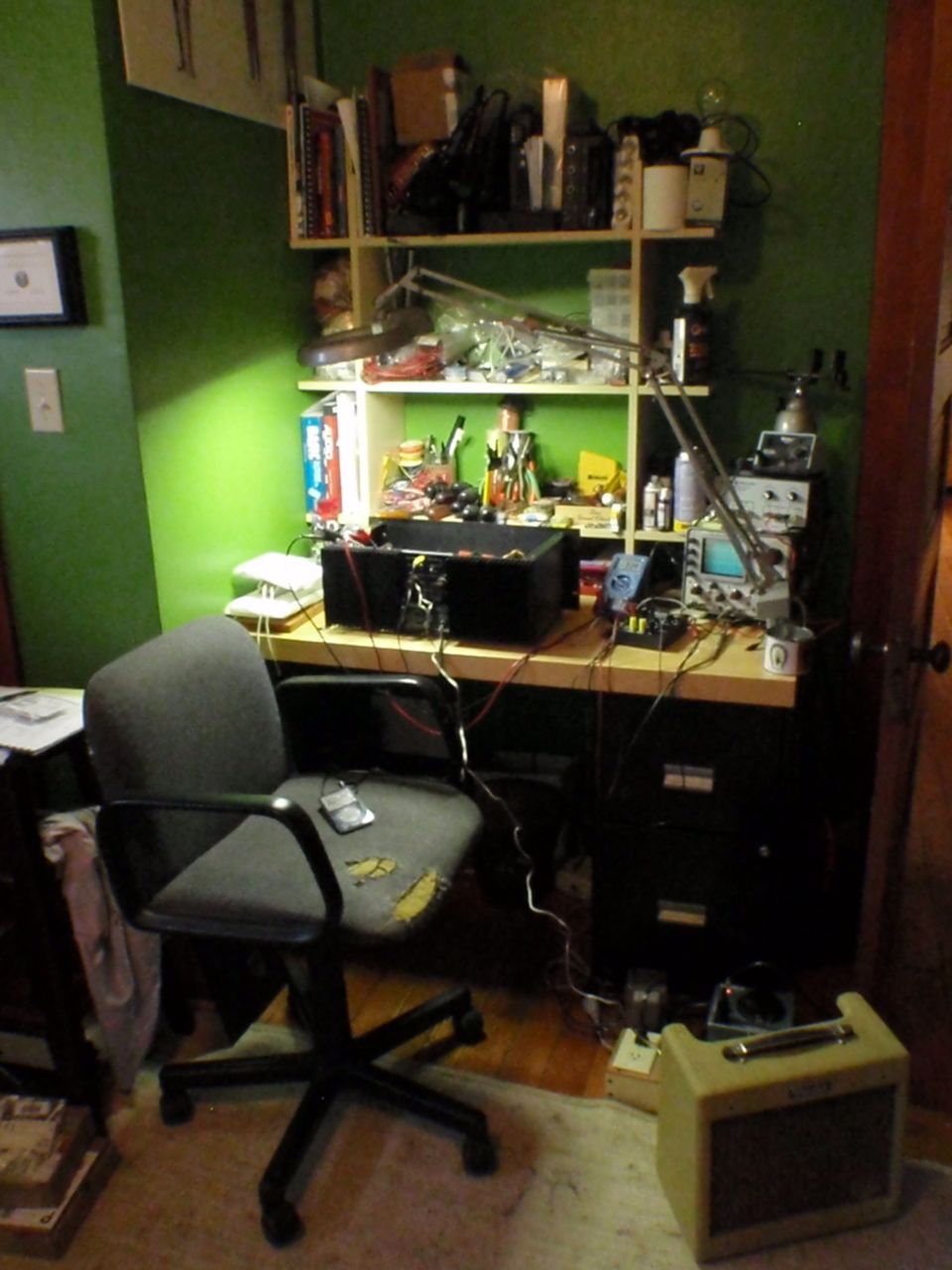

The attached pic is of my Adcom GFA-555 playing the Drive-By Truckers off of my iPod and through a craptacular Fender guitar amp 8" speaker. It sounds sweeter than anything else in the house right now.
Yep. Fixed.
You can hear for yourself here: MobileMe Gallery
Ran through the bias procedure no problem. I'll check it again tomorrow and do the other channel. I'll see what the final DC offset figures are.
I can't say enough how grateful I am to Chris, David, Glenn, Paul, Pete, Steve and everybody else who chimed in on this epic thread. This was a monumentally bad idea on my part, no one so inexperienced should have attempted such a repair, especially given the confounding factor of counterfeit parts. But those long odds were beaten by the generosity of everyone who took the time to hand-hold me. Thanks.
I'm going to let it burn-in for a few hours and treat myself to a plus-sized gin and tonic.
