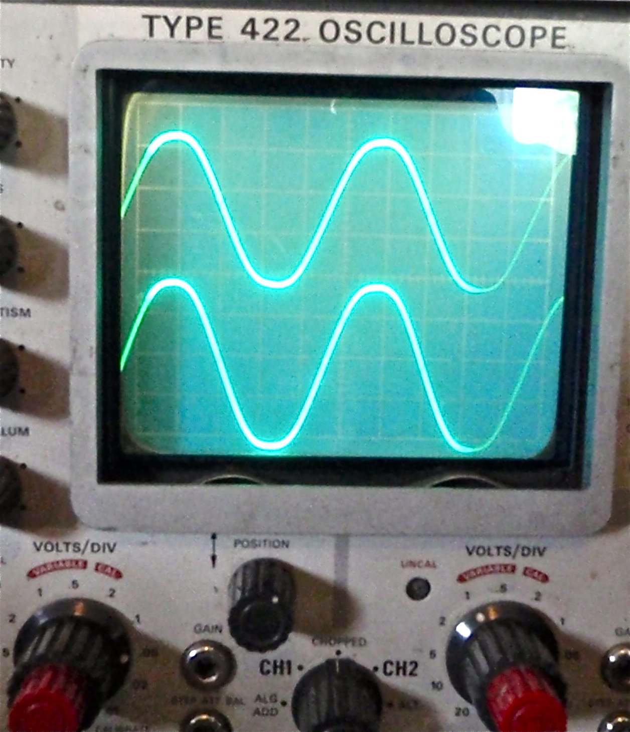

No problem getting a full voltage sine wave (100hz, 500mvac) out, first with no bias, then with 16mv. I was getting 15vac at the speaker out. See attached scope trace.*

*Upper trace (ch1) is input wave, lower trace (ch2) is at speaker out.
Scope settings were: 2ms/div and .05vdc (ch1) and 1vdc (ch2). 10x probe.

Nice work Fred, looks good! Are you sure that is full output, you can just touch clipping to see some flattening and be sure you are there.

Thanks. Not quite sure what you mean by "full output" here. This is without a load.

I simply meant full voltage swing within a few volts of the rails - perhaps you did already but it was not clear to me from the scope traces.

Yes, the traces were taken with ~80 volts on the rails.

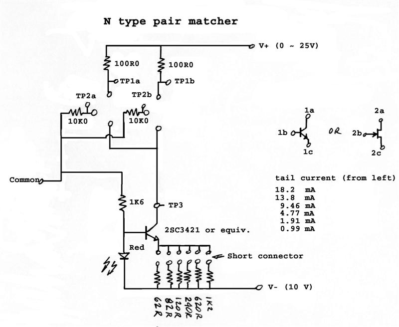

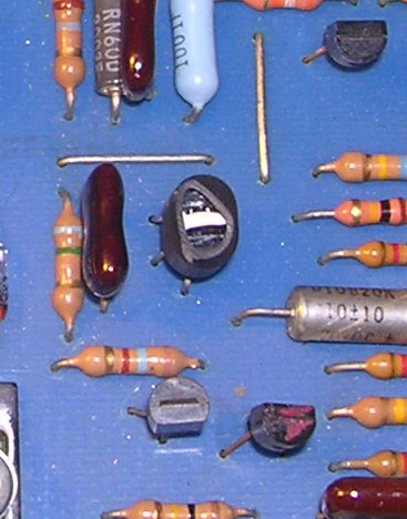

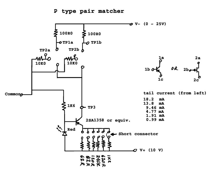

Hi Fred,
As Steve mentioned, setting up a differential pair isn't too difficult. There is the diff pair matcher I posted here before (somewhere). As for thermal tracking, put a touch of thermal compound between the two transistors, then use some heat shrink tubing to hold them together. This also creates a thermal isolation barrier between the input transistors and the environment.
I have included diagrams for the NPN and PNP channel matchers. These work great with J-Fets as well. In fact, i am currently matching some 2SK170 J-Fets right now.
What you do is preselect transistors into rough gain / transconductance groups. From those groups, install pairs that look close and let them settle in. Measure from one collector / drain to the other. The smaller the number in millivolts, the better your match is. Notice there are selectable tail currents available. Test them close to the actual circuit current and supply voltages. I bought 1% resistors and selected matched pairs from those. These determine your accuracy, so don't use carbon film trash here. The tail current generator is fine for carbon film types.
I have also attached a detail photo of one diff pair I had done a while ago. You can see how this pair came together pretty clearly. This pair was installed in a Marantz 240 power amp. It responded well to this bit of detail work.
Hi Steve,
Curve tracers take far too much time to use on the bench for service. The advantage the jig I put together is that it removes temperature as a variable. That is unless the pair is badly mis-matched, in which case you don't want those anyway. Variable case temperature was always my biggest problem in trying to get reproducible results when testing transistors.
-Chris
