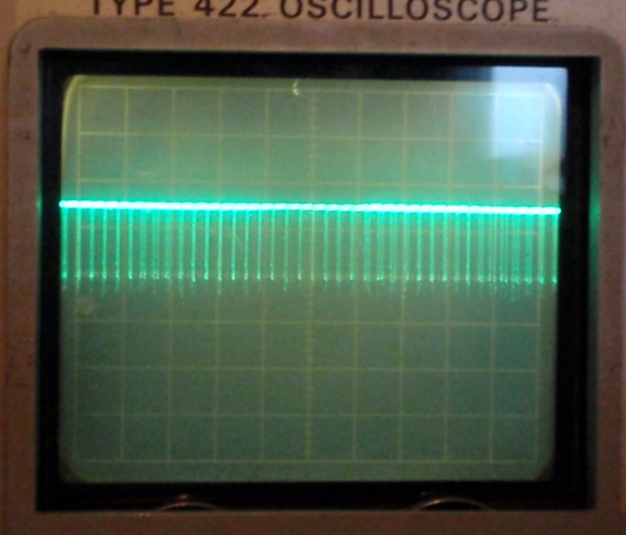

Okay, today's tests.
Same state as previous tests: Q1 and Q2 removed, Q7-C to + rail.
Turned the bias pot all the way down. Slowly turned up the power. As I approach 40vdc on the rails, the output starts to "pulse" with a very slow oscillation. The scope trace at the output shows a jagged, square-wave-ish, voltage drop about every 40ms. I swear it's in 4/4 time.🙂
When I re-set the bias back up to the factory setting, you can still see this oscillation on the scope (I tried to get a pic below), it's just higher frequency. The frequency of the oscillation also increases as power increases. The attached pic is at 37.5v on the rails, 2ms/div, 1v/div. Obviously, current draw increases with the oscillation.
I continuity tested both drivers and all the output transistors for case-to-heatsink shorts. I did not find any.
I tested resistance from the ground sleeve of the input jack to the common ground, it was 00.1 ohm in each channel.
I took Q17, Q18 and Q19 out of circuit by removing the screws and lifting a leg of the resistor, bringing the amp up to the oscillation point (34+ vdc on the rail), after removing each transistor. it oscillated.
That's all I had time for today. I'll get to the last five transistors tomorrow, hopefully. I'll leakage and gain test them while they're out of circuit, but I've got a fishy feeling they'll test okay. *sigh*

We need to stop the oscillation, which I have a feeling has something to do with Q4 - not that it makes any sense. If you've got oscillation we need to stop it before you pull the outputs. It is clear that it works fairly well below 40V so normal low voltage testing of the parts is not going to tell you much. We are simply trying to use the full voltage of the power supply to swing the output rail to rail and find any leaking devices. But first we have to stop the oscillation, then we have to see imbalance in the emitter resistor voltages or whatever might indicate what the real problem is.
Opening T1 will at least turn off Q4, that might be the simplest way to go.

I see what you're saying in your "re-thinking" post, but this post did get me thinking. At first I thought the oscillation was a pre-existing condition that caused the failure of Q7. However, on further thought it seems to me unlikely that the oscillation was present in the initial fault condition. Wouldn't it have smoked and burned more parts (e.g. R21)? If, and only if, that assumption is correct, then the only explanation for the oscillation is that I introduced somehow (I "built an oscillator" as you said).
Looking back, the oscillation was present after I did the following:
Replaced: Q4, Q7, Q8, R7, R8
Removed and reinstalled: Q11
So what do you think of an approach that first takes these components either out of circuit or verifies their correct function in circuit. Since Q4 and Q7 have been replaced twice (first with a poorly matched set, then with a matched set) without any effect on the oscillation, my first suspicion is Q8, R7, R8. If I understand correctly, simply lifting a wire of the thermal switch would take these out of circuit along with Q4?
Does this make sense to you or should I just proceed as you recommended in your last post?
