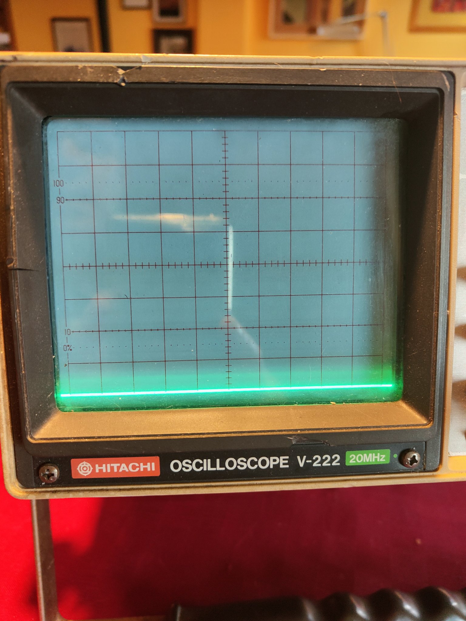

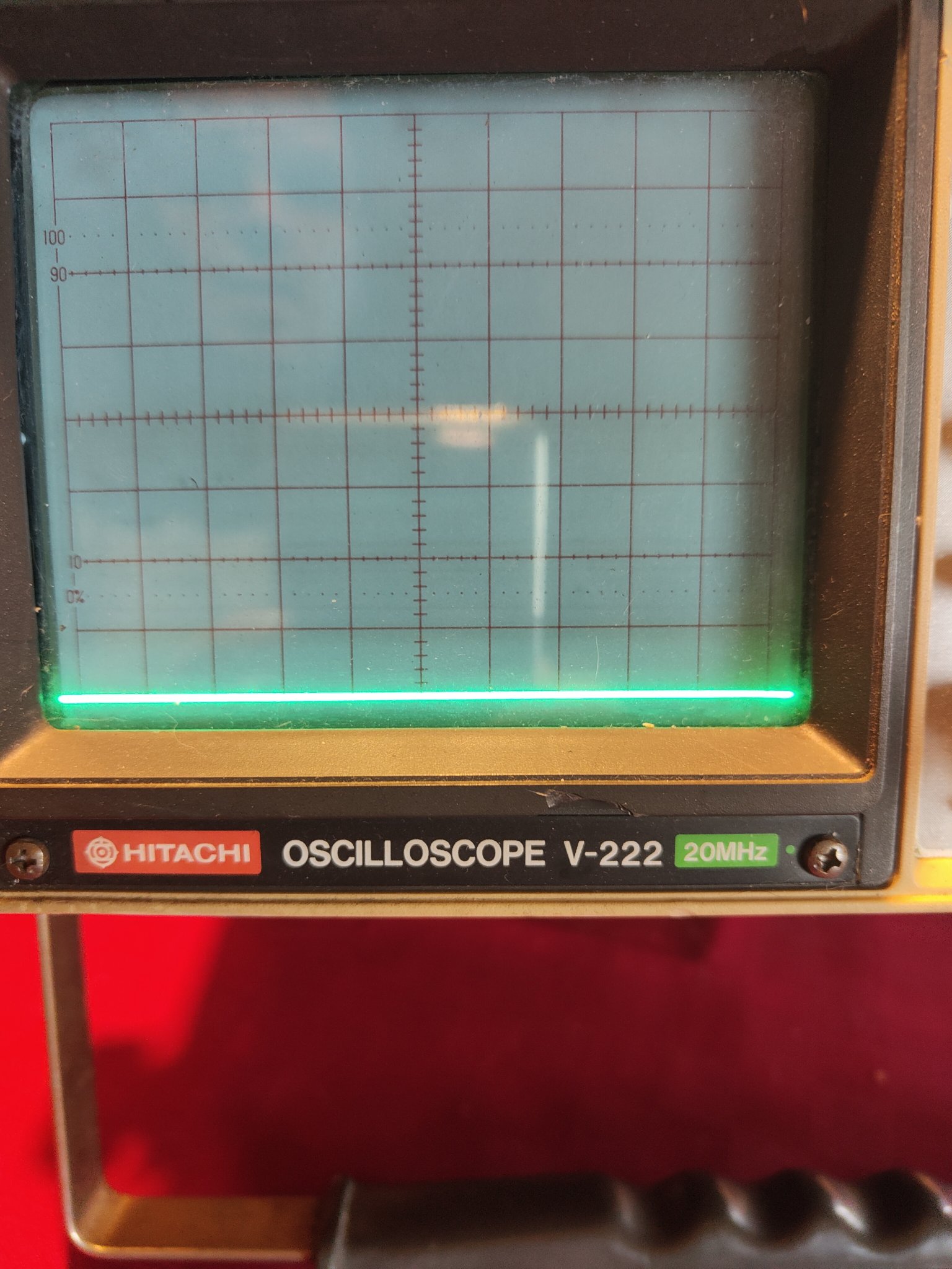

I can tell that I waste my time today: I have a bad scope probe (one of the two). I have a strong high on G1 and a G2 that goes with phi1 because G2B goes with Phi1 of the 6875 and G2A its directly connected with ground, that seems good.
So at any clock time the eprom can be read I think

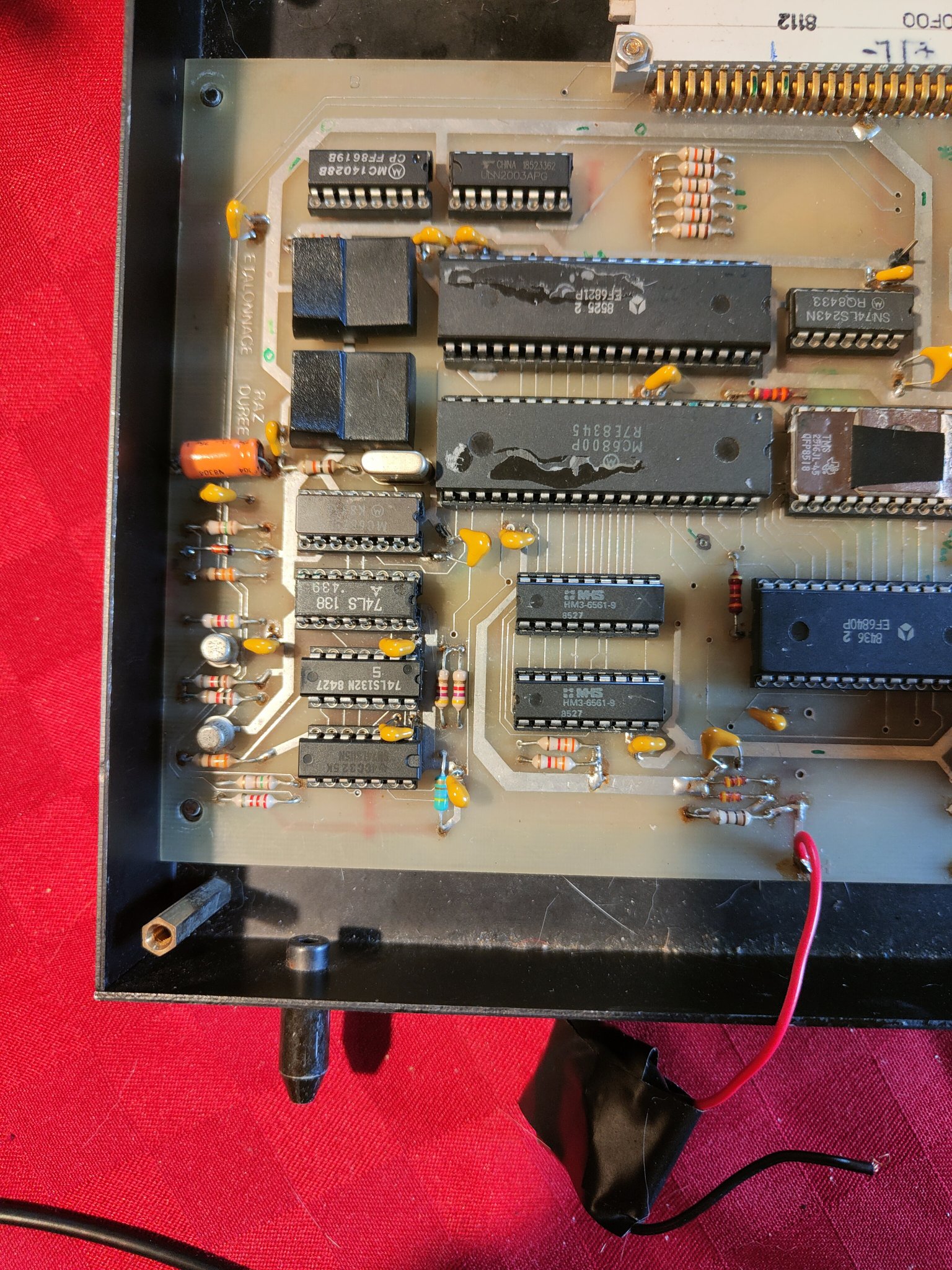

Can you post picture of the board.
RAM looks like it's made of 2 chips of 2114, those are possible failure sources....

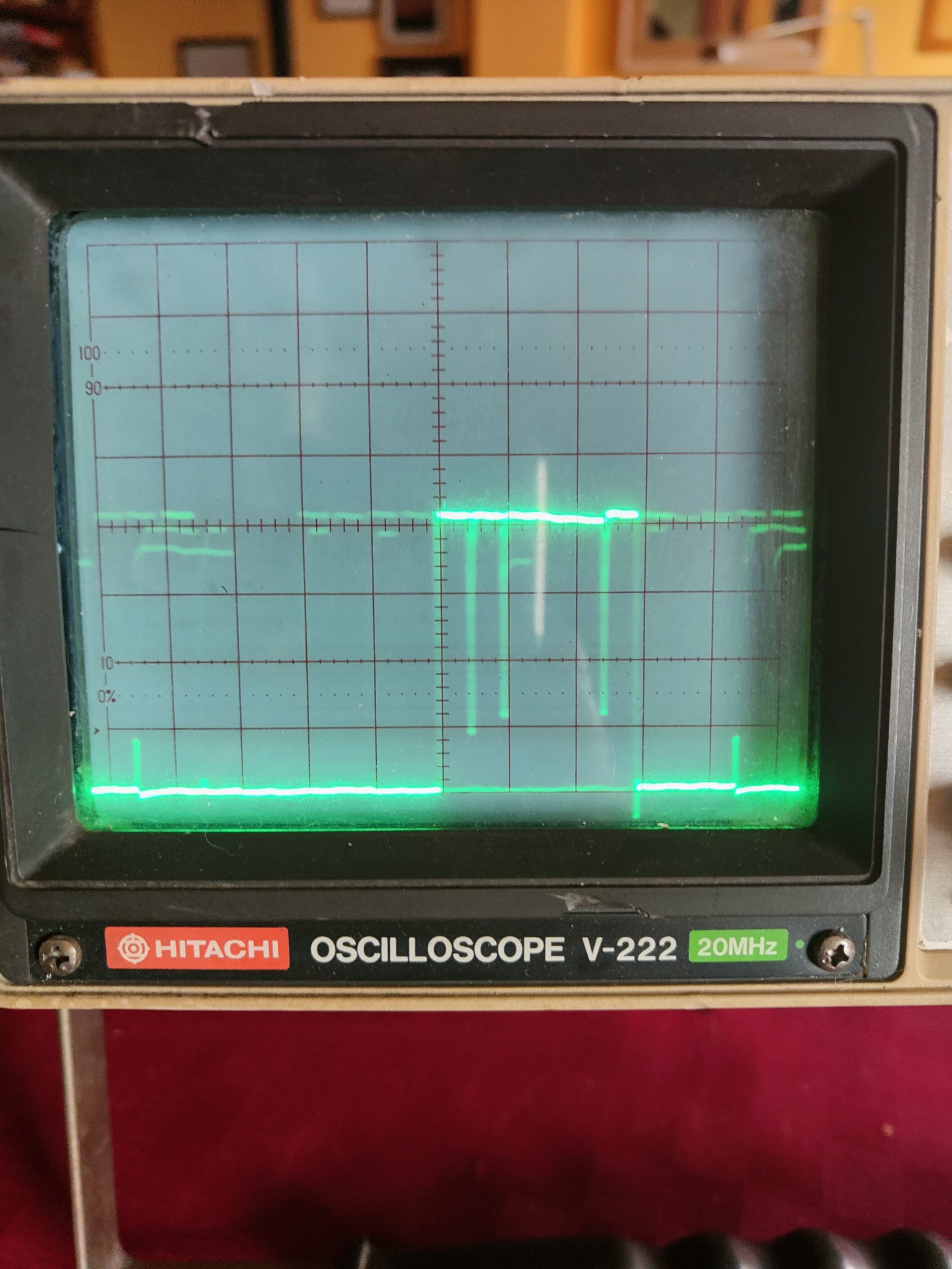

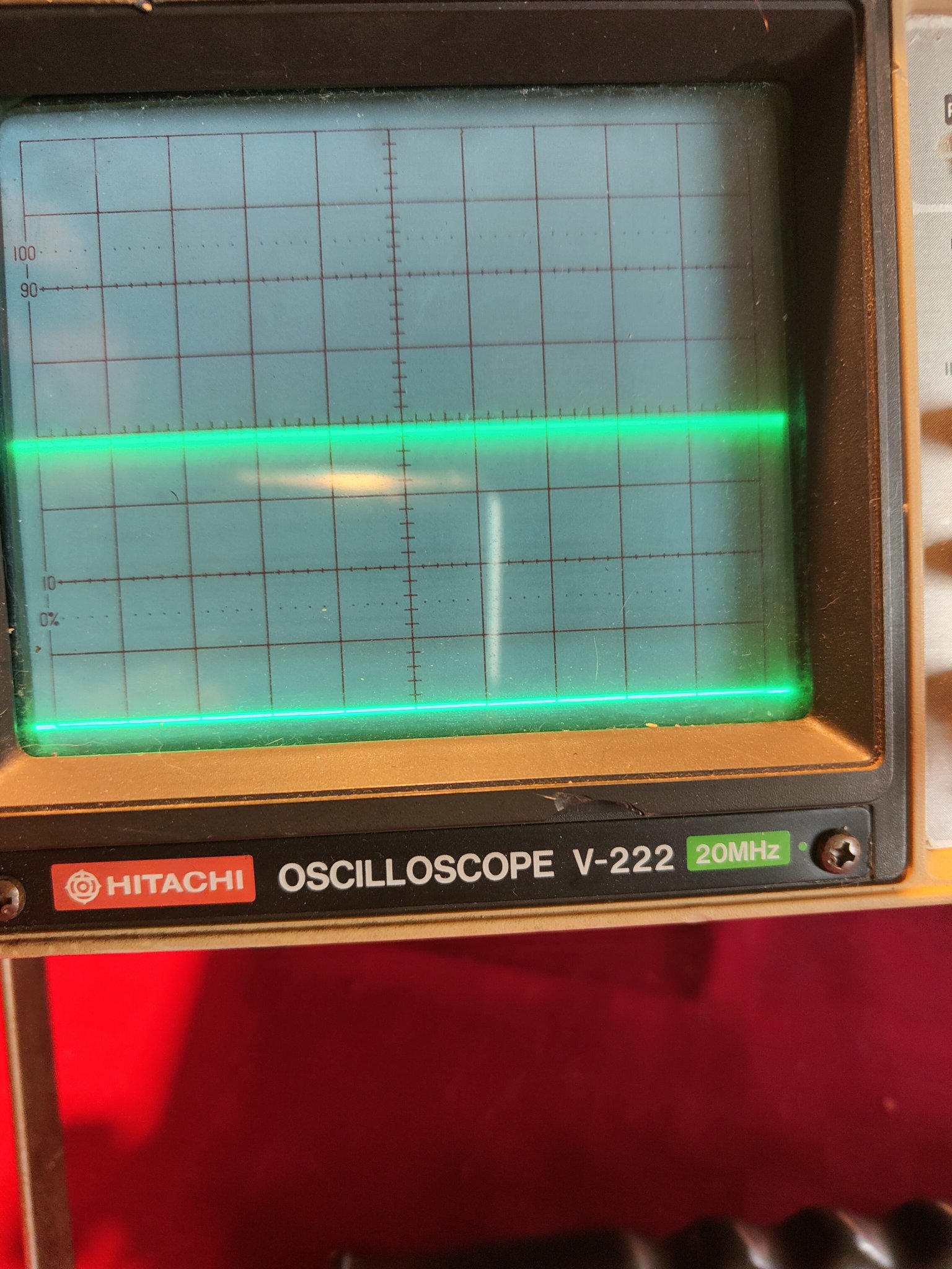

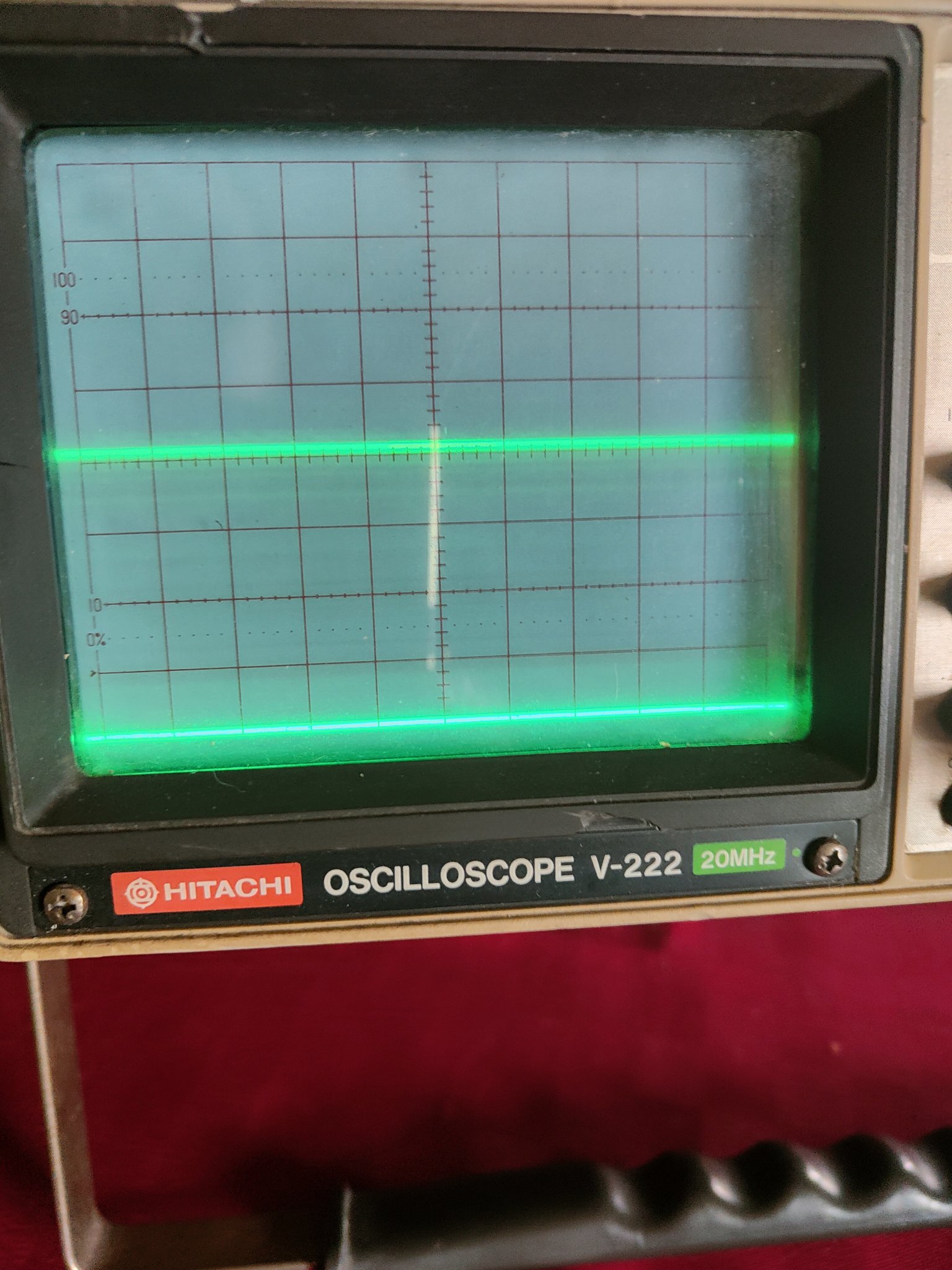

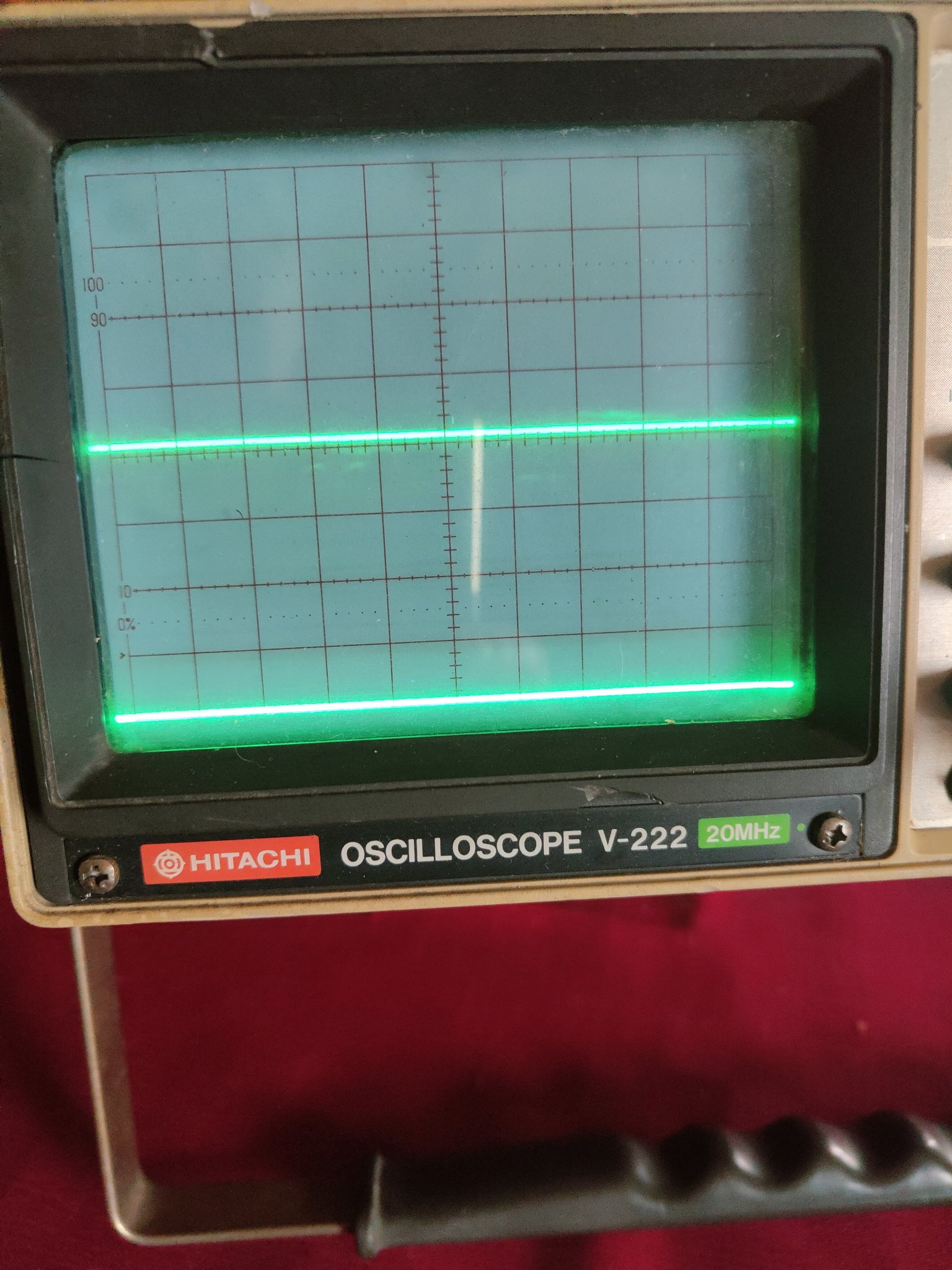

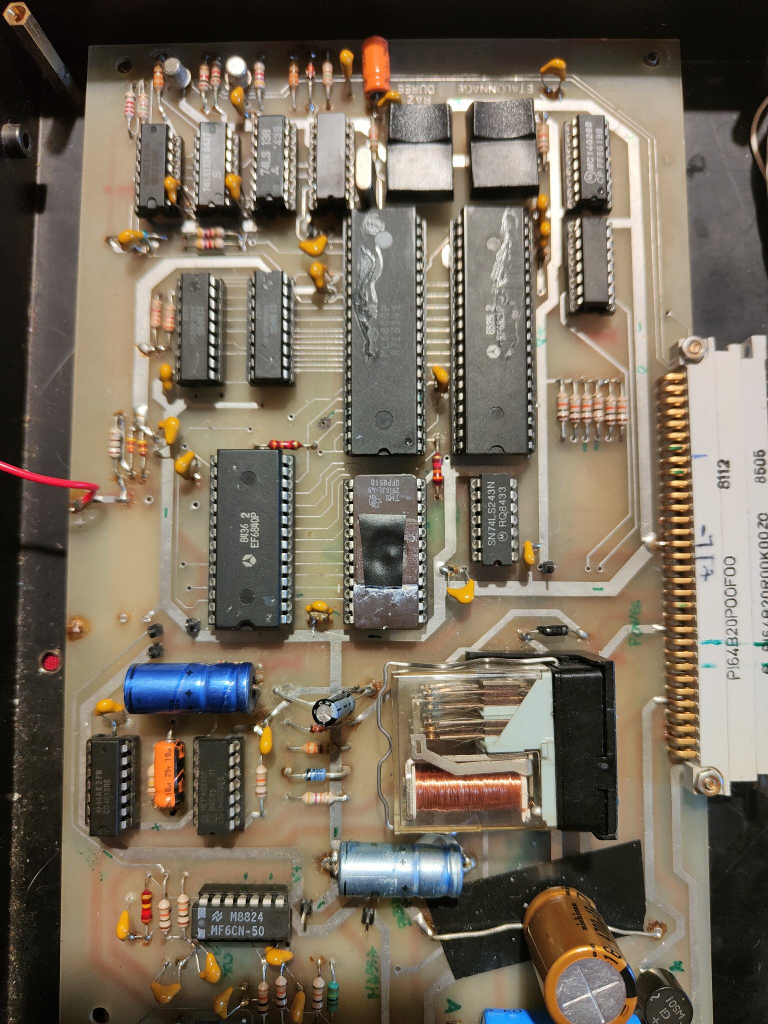

Hi Chris, many thanks for ypour suggestions and your help, here two pictures of the board:
in the next post I show you what I can measured on data and adress bus of the MCU

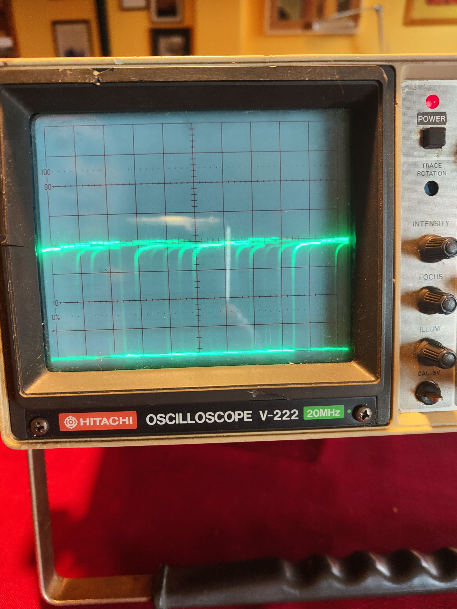

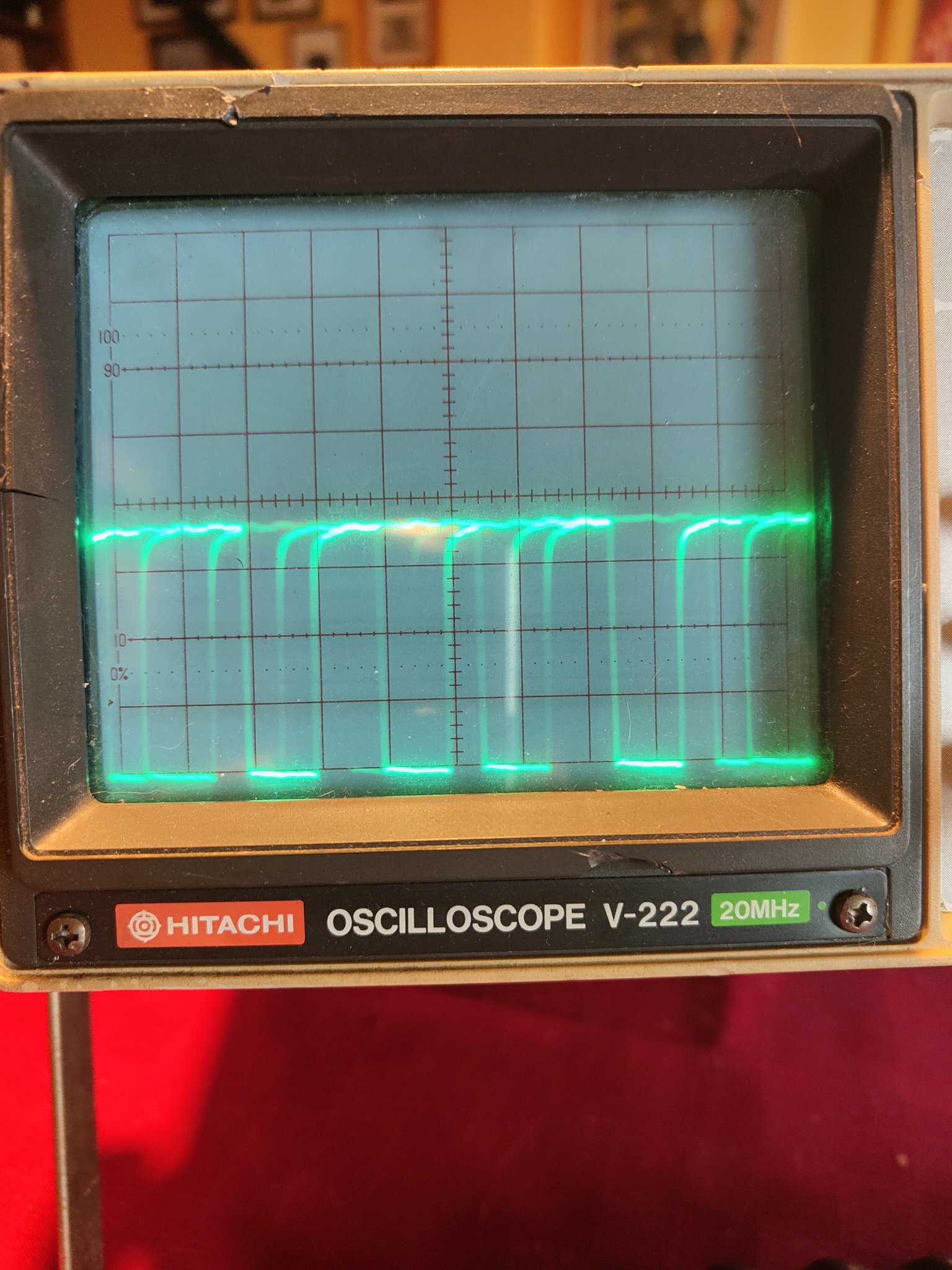

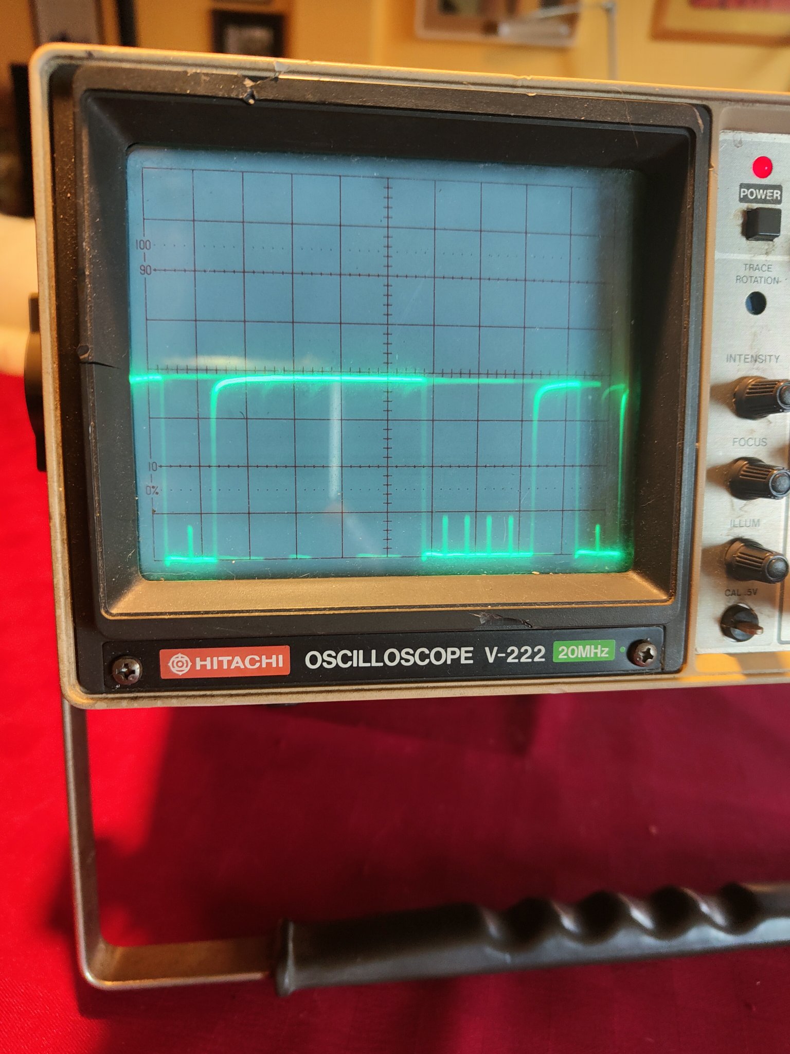

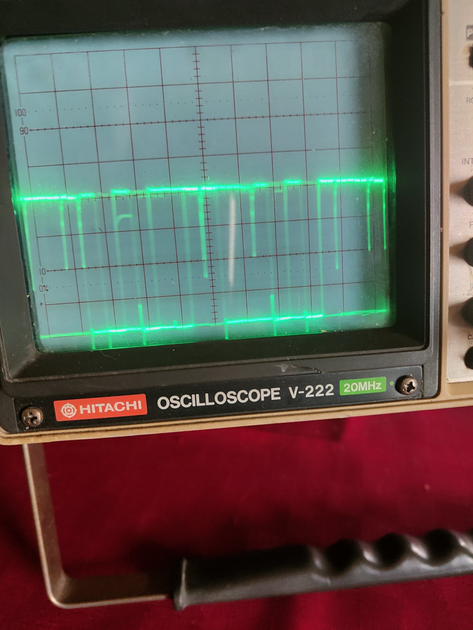

following your suggestions on post #40 I put 0 on the lower line, scope DC coupled, 1 V/div, 2 uS/div (5 is the same:
A0, A1, A2 are quiet the same

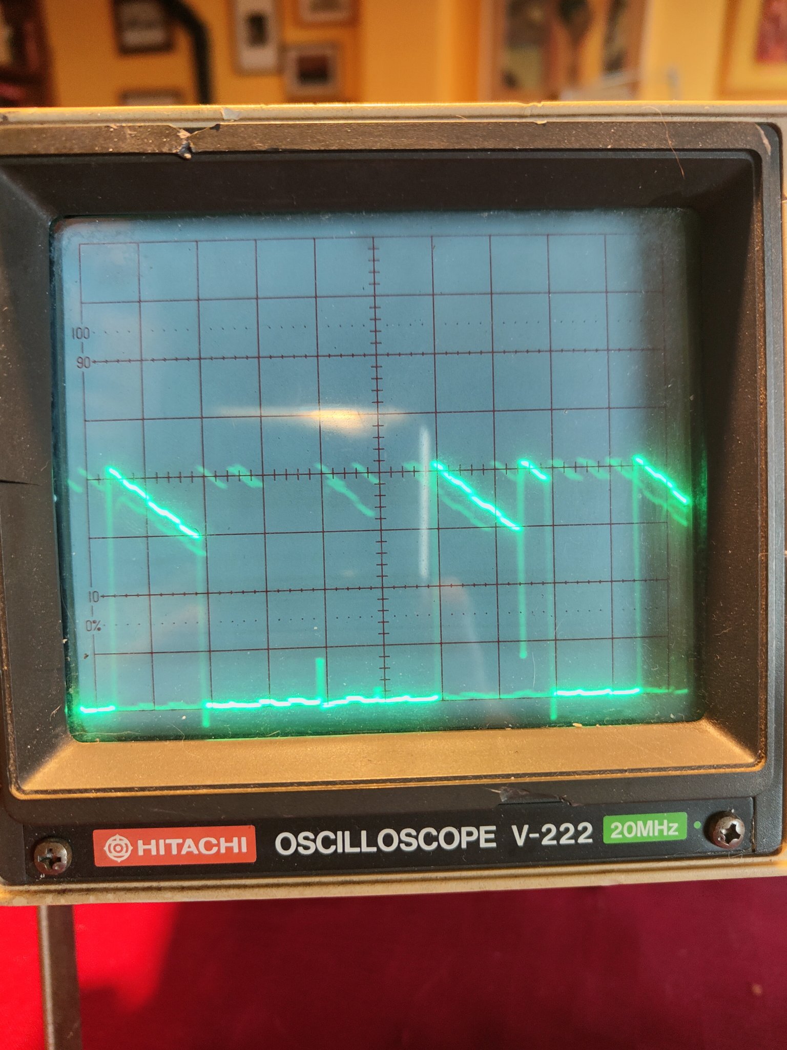

A3, A5, A6
A7, A8, A9

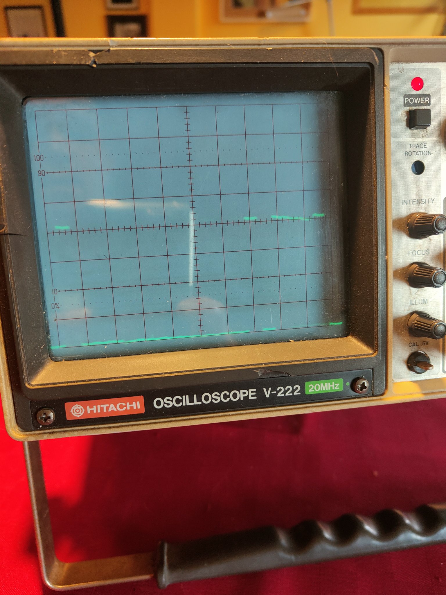

A10
A11 to A15

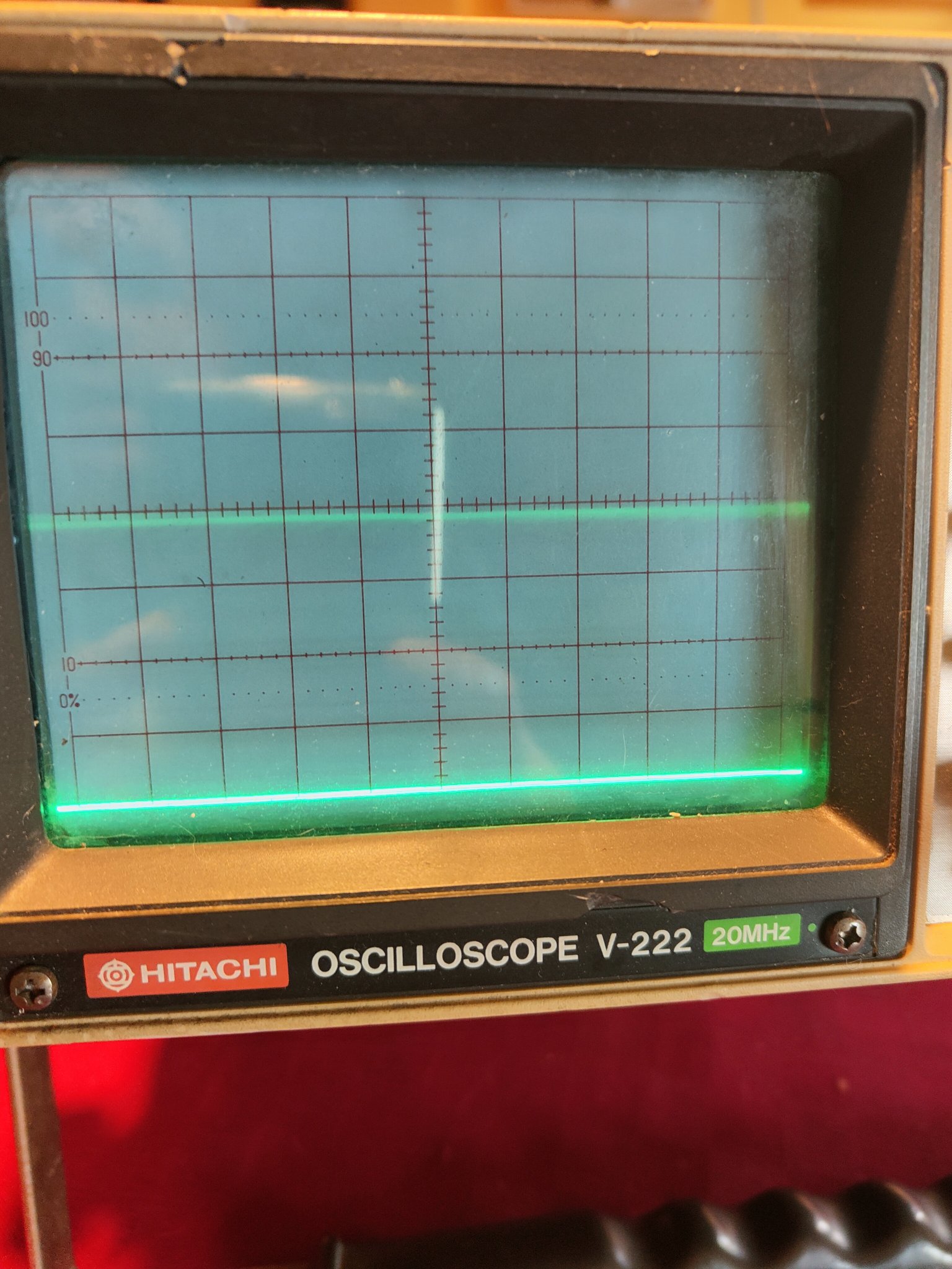

BA
VMA
A3, A5, A6
A7, A8, A9
A10

BA
VMA
There's something weird with these RAMs: following what you suggested about the RAM I measured VCC and from VCC and the ground of the RAMs I can see 0,3/0,4V. It's the same if I measure from the socket without the ICs. If I measure from VCC pins and a ground of the board I can see 4,5/4,6V that looks good because there is a small diode beetween. I'm reading the DS of the RAM and it doesn't look good. I decided to follow the ground line of the two RAM banks

This RAM is CMOS technology because they are used to backup some values ( speed trimming ?) when system off. There's a backup power made of a battery and two diodes. Could you check the two diodes ? When power is on you should have close to 4,4V on RAM VCC pin. This is what you have if I understand your last message. You check the battery and resolder it's gnd wire.
Regarding the screen shots :
- VMA & BA are OK
- A4 missing (check it, no need to post)
- A10 is ok if software is running into the first kilobyte of the EPROM but it should be tested during system startup with analyser
- Other Adress & data lines looks ok

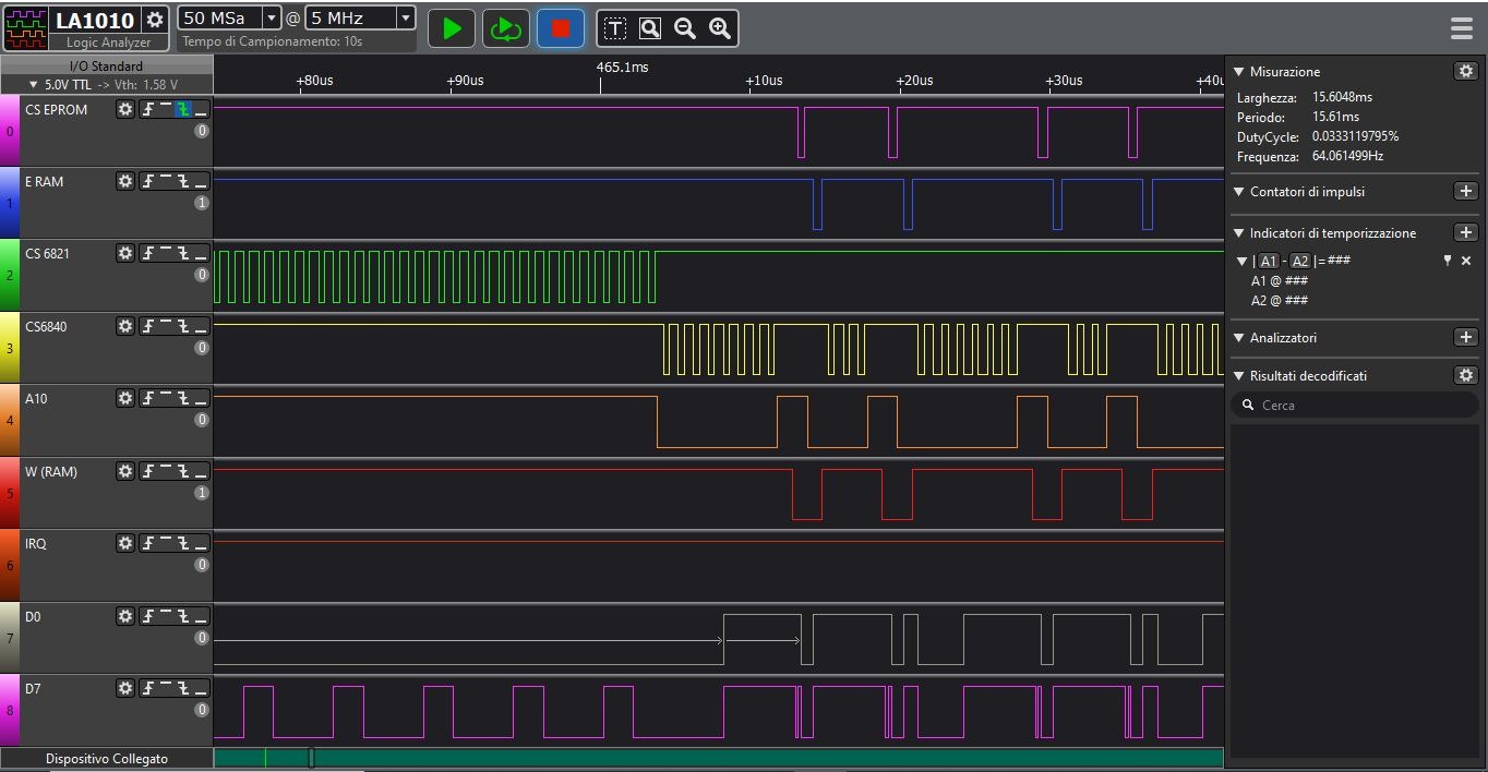

In order to move on can you set up the analyser with :
- CS of EPROM (p20) or Y7 of LS138
- CS of RAM
- CS of 6821 (p23)
- CS of 6840 (p15)
- A10
- R/W (on the RAM, any chip, p16)
- IRQ (on CPU p4)
- One or two databus line if analyser can handle
- Set up the trigger to One shot on falling edge of CS EPROM
- Make a capture at power up (power off system, reset analyser trigger , then power on),
- Adjust sample speed to maximise duration of the capture (not less the 4MHz)
With the results of this last capture will be able to say with some confidence if the circuit around the CPU seems OK and if the CPU run or try to. If yes your assumption regarding sofware and EPROM will remianing plausible as other issues on the board related to surronding circuitry.

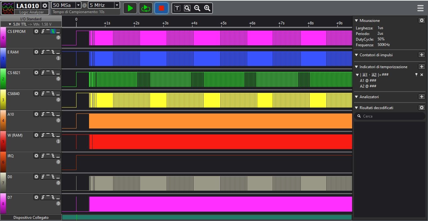

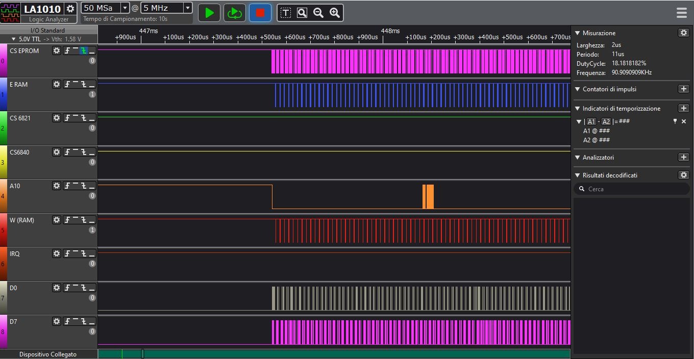

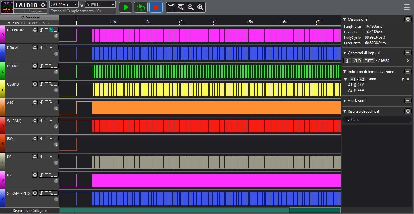

Here the results of the analyzer:

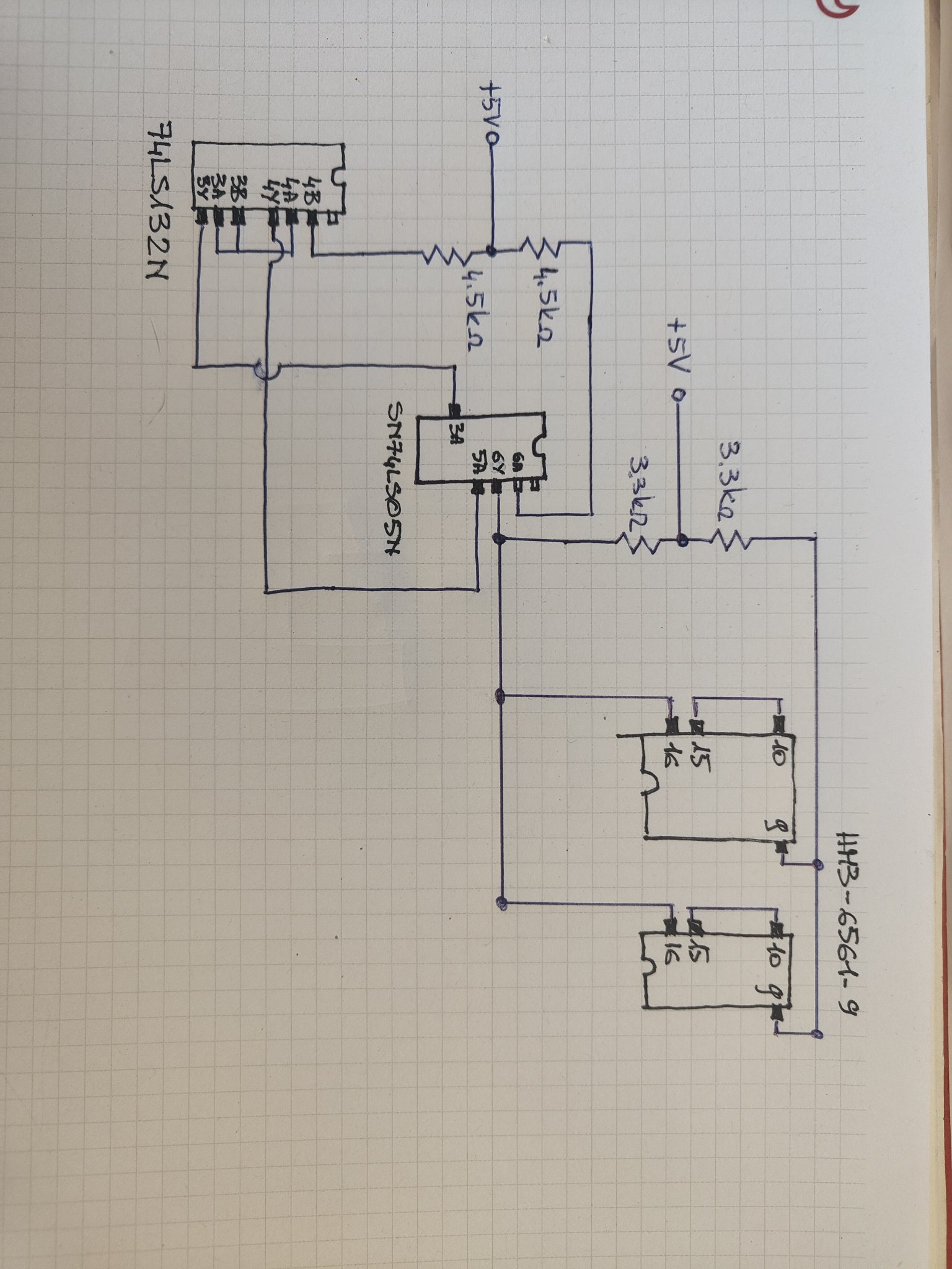

After that I realized that pins 9 and 15 of the rams are connected with all the output of the muliplexer LS138 fromY0 to Y7.
The only thing I can notice is that there isn't an interrupt request even if I push a button trying to start the turntable or to stop it

You mean that 9&15 are connected together to one output of decode, not all ?After that I realized that pins 9 and 15 of the rams are connected with all the output of the muliplexer LS138 fromY0 to Y7.
Globally, even without extensive testing that looks good :
- no signal integrity issue (which cn be cause by a dead chip)
- cpu activity doesn't look abnormal (no steady loop, peripherals are accessed on regular basis, an so on), but...

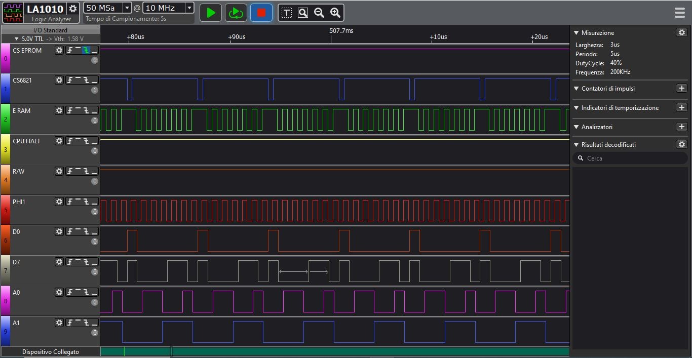

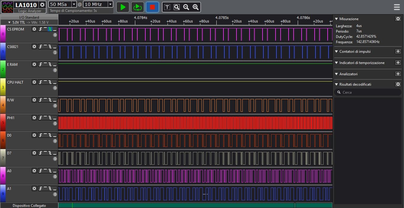

Could you run a new acquisition ?
set sampling speed to 10MHz, in case there's a display issue
Acquire :
CS EPROM and trig on falling edge
CS 6821
CS RAM
CPU Halt (p2)
RW
Ph1
D0
D7
A0
A1
With the scope you can also check if there's activity on the outputs of the 4028. They're probably connected to the ULN2003 close to it.

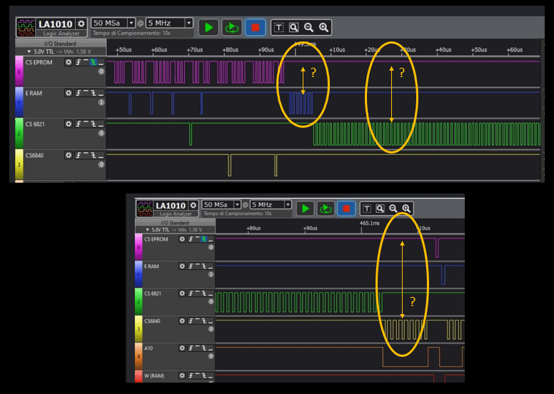

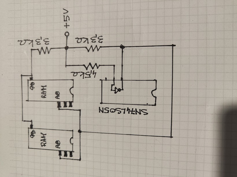

Hi, many thanks for your help. About pins 9 e 15 of the RAM: with a multimeter it seems that are connected to all the ouptut but yesterday I tried to get a schematic from the board and here you can see the vias:
There are other connections on the Schmitt trigger and on the inverter, if it helps I can try to draw all.

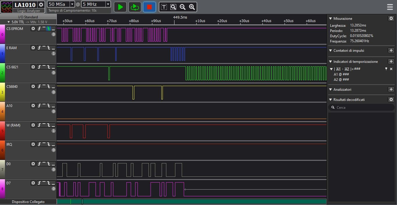

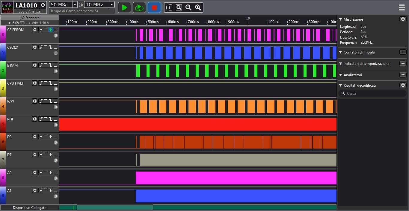

I understood what you are telling me about the CS of the eprom and here you have a new acquisition made with your indication:
here at the start
no CS eprom
At about four seconds from the trigger
There are no outputs from the 4028 and the BCD ouput it's connected to the MC14511BCP BCD to seven segment decoder on the board of the display that normally show the speed of the TT. I remember that sometime ago I replaced the 4028 and the 4511. In the past sometime I saw some segments of the display showing something. About the seven Darlington arrays it seems to me that I've tested it but I'm not sure
here at the start
no CS eprom
