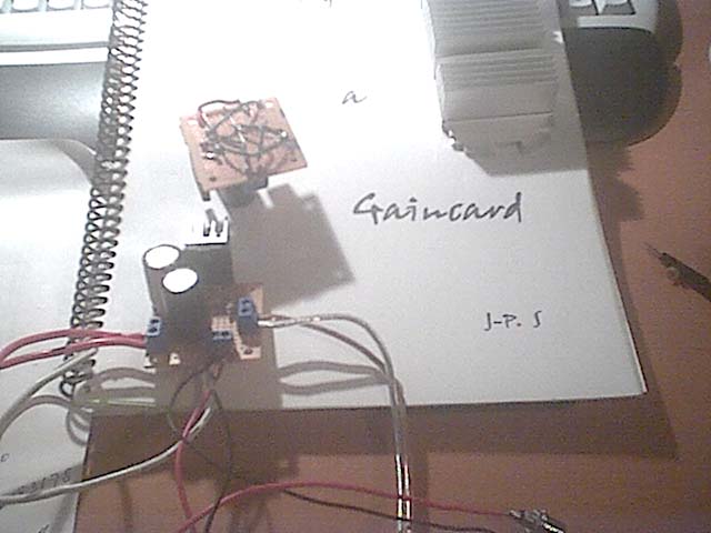

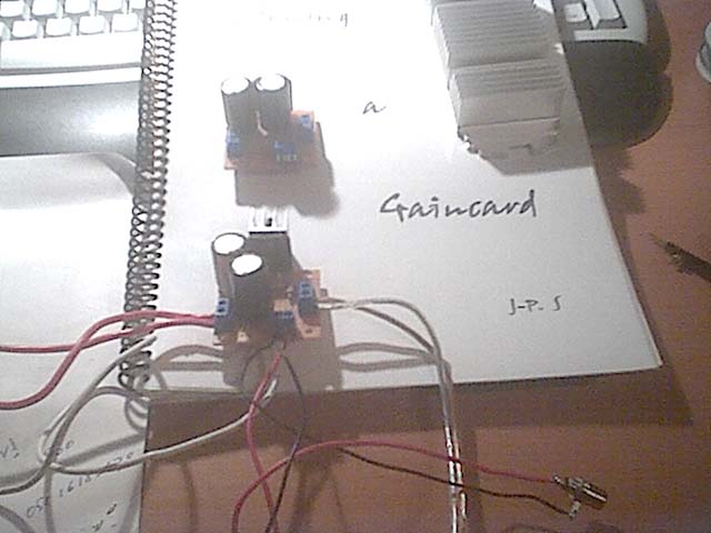

here are some pics from my third pair.....
do not pay attention to the small heatsink, when mounted inside the enclosure, there is one large heatsink that serves for both chips
lm 3875 with the cheapest components available
R's from all electronics
caps from bg micro (panasonic fc's)
to test i use basler transformers 20 v 2 placed in series
and when everything looks, feels and sounds ok, then i use the Abbott 200VA puppies
if requested I can post some gc's in enclosures (unfinished and finished) but my (short term) idea is to make some hi tech enclosure with some 3d look , I am working on it as we speak..
J-P

I think you'll have to optimize the wireing if you don't want some oscillations happening. I'm sure you can have much shorter paths if you do PtoP or PCB.
How's the sound?
/Greg

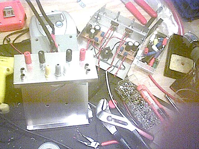

and here is the last pic
from the conventional exnclosuresfor the gc
from now I am going a lot more exotic, something more Baume Mercier ... or better Piaget as long as PD thinks of Patek Philipe I can avoid him!
J-P

humm
my guess it that you just want to stay polite ...
I kept this one very very simple, you notice only bridge rectifier
the trannie is away from the set up, one 200VA.
I wanted to hear for myself the difference with the one that has actually a completely seperated power supply with each channel it's own rectifier
I estimate about 20 watts, maybe a bit more but I can only play at 1/6th of the volume settings, otherwise the blinds start shaking....
I am finishing your schematic Greg, this one will have stepped attenuators (I call them stepped pots because of their rimplicity, and I already have the components laid out on the schematics of Nuuk's Minimized gaunclone layout (with 2 * 432 K R's etc..)
And yes I have taken greater care so that the signal loop is extremely short!!! I did not use ANY piece of wire! not even board.
I will try to post some spec results this time so that it looks more professional to this forum.
J-P
J-P
From what I see, the wiring looks pretty neat, and the sound is up to you to tell us about. As far as the outside look, I can’t see it plus it's really a matter of personal taste. I like my amp, but don't expect others to like it too. Though by posting a picture it may give the people reading the post some ideas they may take advantage of.
One thing I wouldn’t do is use separate pots instead of step attenuators, but I knew that you’d change it as soon as you start using it.
So I second the "Looks good" part.
/Greg
