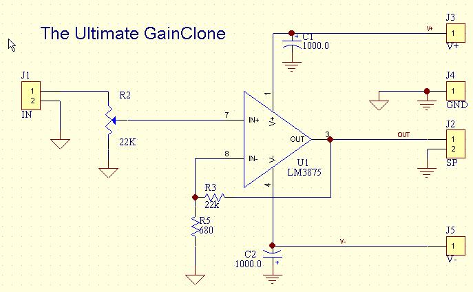

A few weeks ago I followed te schematics of the 'ultimate gainclonce'. It turned out to be a hit and no no 'nasty side effects'.
I could not measure any dc anywhere and the thingies (insulated on an apexjr. heatsink, that was it) played for weeks.
So when my brother in law came by yesterday he took them home after leaving behind some hard earned dollaaaars.
I made one last night, I started well after midnight till about 3 pm.
Same config, same hardware (I have stock for 5 stereo's) same toroid etc...
and every. let's say 45 seconds to one minute i get a non defined noise accompaning the music. Something i would describe as oscillating and sometomes a very present HUMM.
What did I do wrong??? I thought I did exactly the same thing. I use the simple schematic-ultimate gainclone with very few components (2 caps 1000uf, 2 resistors 680 & 22k and one pot 22k)
when there is no disturbing noise, the sound itself is fantastic, even when connected to a portable cd player. hi, mid and bass are, I think, very much perfectly combined...
Jean-Pierre

I would think that that might be external HF noise. Put your DSS cordless phone or the cell phone when it rings next to the amp and listen. I would put an input RC LF filter to cut all the HF nastiness that comes from the input. If your IC is well shielded and the caps are of a low ESR type and close to the IC you should be fine. Didi you change the speaker cable? Is your grounding done the same way as before? Check the wiring again.

Jean-Pierre,
Check the PS also. Measure all the voltages of the PS. Is the shielding as good as the previous one?

Did you try adding a low-pass RC filter at the input. Just to see if that is/isn’t HF coming from the input/source?

http://www.diyaudio.com/forums/showthread.php?postid=279023#post279023
Take a look at R1/C1. That is LF Filter. Use 10k/100pF. Connect them directly ont the RCA connector of the amp.
My concern is that that interference signal was not present before, or if it was, the housing of the amp you had before was doing better job shielding the amp. So if you have different type of housing now, that very well can be the problem.
Try adding R1/C1 to your amp and see if you get some improvement. Another thing to try would be to bypass the 1000uF caps with 47nF. On each 1000uF connect 47nFcap in parallel.
Let see if you get any improvement.

Re: everytime I
Sounds like a capacitor that's bad or backwards. Check if any of them gets warm. Is the problem evident in both chanels at the same time? Do you have input cap?
Does it hapen if there is no input signal. Turn it on donCan you show me the exact sch. of the amp?'t play any music and see an see if the noiseigoing to appear.
Did you mesure the powersupply voltages when no input signal is present (when you first tun the amp on and after it starts making all the noise?
It could be a bad solder joint too.
Measure the voltages please.
Checked them = nothing gets warm, even the LM feels cold!
I started with only one channel this time, so I h cannot answer that one
I used " the ultimate gainclone schematic, second time.
Does it happen if there is no input signal. yes and no, as long as there is no signal everything stays quiet but when the music arrives then after 3 to 5 minutes i get the crackling followed by hummmmmm...
sure, here it is...
toroid power ingoing is 41 volts , after the bridge it is 60.5 volts
I checked them so many times i had to replace the LM because I broke off some tips.....
I will do so and I will also measure the dc offset. now that I found out how to do it ( with a 10 ohm R)
Gee, I must have been very very lucky with the first amp 2 channels, I built it, connected it and it played right away. This time it seems like climbing the Kilimanjaro!
Jean-Pierre
sure, here it is...

I forgot the schematics
sorry, here it is..
the only thing I changed (from the very beginning) is the pot. The value I use is 25 K.
For making the ground stars I use very small copper washers where every wire (cap etc..) is safely soldered onto. I make 2 stars and they are connected to each other.

Thanks for the sch.
Let see what you measure as a DC output and rail voltages as the amp starts making noise.
Does the pot position afect the noise in any way? I'd put a 22k to 47k resistor from +in (pin 7 to gnd) just to make sure that the pot is OK and it provides constant gnd path for +in.

Refined Sch.
Today decided to do some experimenting with values and sch. changes.
Found that removing the cap and keeping the gain just above 20 gave the best results (base and HF balance). More base and the highs are more refined.
The 1k resistor keeps the DC offset at the output to a nice low level when the attenuator is at low levels. With the shown res. values (had to decrease them to 3.3k/68k to keep the offset low) the DC offset is in single digits at all levels but the highest volume setting (it's around 25mV at max. volume).
Found that gain at just above 20 gives more refined highs and deeper base than gain of 30.
C6 was never installed on the first place. Didn't needed. So, the less parts the better.
So, I think, for my taste this is a better performing version of the amp. No DC should be present at the input of the amp though.
