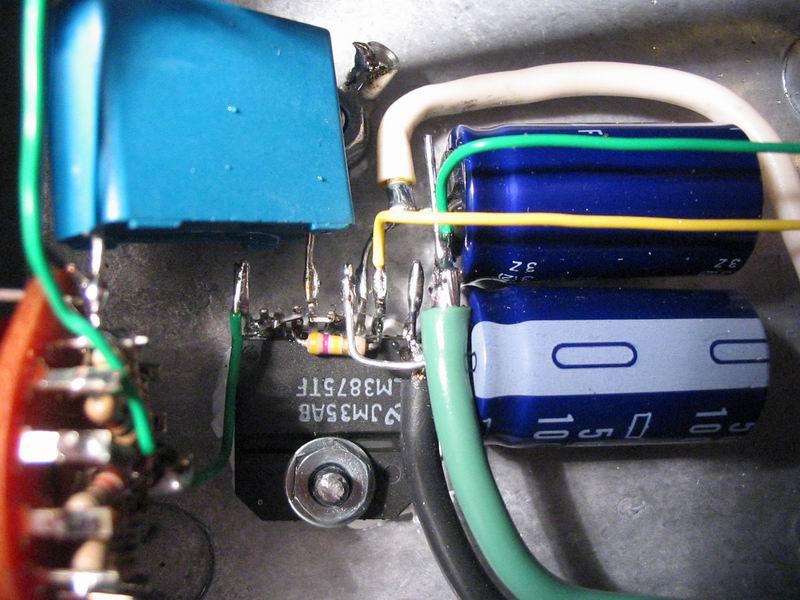

I spent a lot of time to think what the best way for the layout would be in my case, so that I get exact symetry when building the left and the right ch. and the shortest path.
I decided not to use any exotic parts. The power supply caps are Long life High temp. Low ESR United Chemi-Con(equivalent to Pana. FC type if not better). The decoupling cap is Siemens MKT type (4.7uF). The resistors, metal film 1% (I matched them to 0.1%).

Hi Greg,
Really nice, I like it.
My experience with Siemens MKT says that they can sound harsh and thin though, you might try some other coupling caps. Btw, what series are exactly those Chemi-cons?
Pedja

Pedja,
Thanks for the tip. I have also some non-polar electrolytics (10.0uF), but I thought of trying the MKT first. Do you think the non-polar electrolitics would be better in general?
The big caps are LXY type. Compared them to the FC's and they have the same parameters but a bit longer life.

Hi Greg,GregGC said:I have also some non-polar electrolytics (10.0uF), but I thought of trying the MKT first. Do you think the non-polar electrolitics would be better in general?
Generally not unless they are Black Gate NX. I use them for some time now and my findings are positive. But in my opinion it is not any hard to find better caps than those Siemens, I guess any MKP will perform better (there are many low priced good MKPs nowadays). Anyway, I think you can easily swap the caps in your amp and check what is it you like.
Pedja

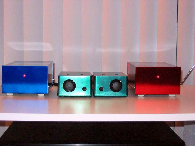

Reporting on the completed NIGC.
Everything is just fine. No oscillations, it doesn't even worm-up at the levels I listen to it. The speakers are 90dB/w/m.
It sounds like one eager to run boy. Fast and detailed, not harsh (to me at least). Base is plenty. Again it will depend on the listening level, but at any reasonable (higher than I could ever listen to) level sounded fine in the base section.
So far I've listen to the type of music like Diana Krall, James Taylor, Sting, Classical. Everything as I said sounds very vibrant. I'll check it on Destiny’s child and see how it goes with more complex music.
Output offset is 2.5 mV on one and -12mV on the other one. I guess I didn't pick well matching IC's but it's not a big deal at all. The noise level is very low. You ear has to be at the speaker to hear tiny hisss.
So far very pleased with the results.

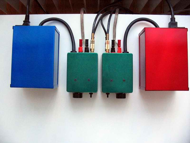

The boxes for the power supply are very thin. The transformers are quite heavy. That’s the only think to consider when buying the boxes. Second is the fact that you’ll have to attach the IC to something a bit stiffer than just a tin box to have a good thermal contact and low thermal resistance. And the last the cables are quite heavy so you’ll need some wall stiffness where the connectors are installed.
That's all I can think of right now.

hi greg,
what kind of speaker cable are you using? on the pic it seems like normal multiple-thin-copper-strands. May i humbly suggest trying a( thin) tnt-audiocat5 cable ?
You'll be surprised with the results.
Hi Mat,
It is the normal speacker cable. I was thinking of trying a single pare of a network cable. I have to see what the cable you sugest looks like.
Thanks for the suggestion.

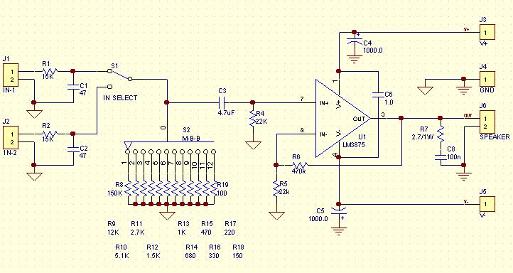

Is the schematic the one you posted under the "Ultimate Gainclone" post two or three weeks ago ? Actually under that post there were about three schematics > Did you choose one of them ?
sandro600 said:excellent news regarding the very low level of noise of any kind.
This is the sch. of it. Haven't made any changes so far. Have been listening to it and don't feel like taking it a part yet. Mind you I don't see why I would've. The clarity is amazing.
