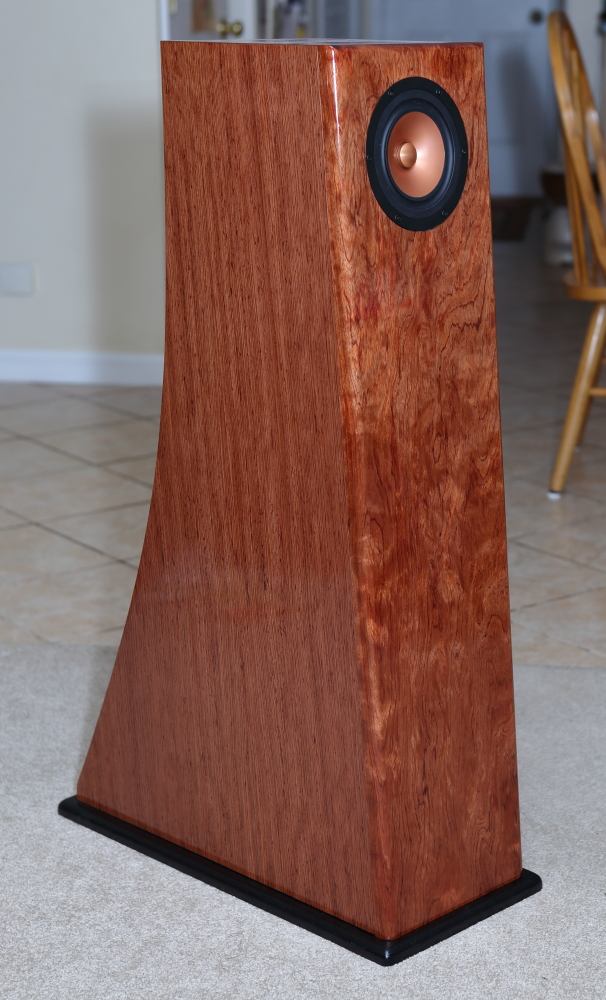

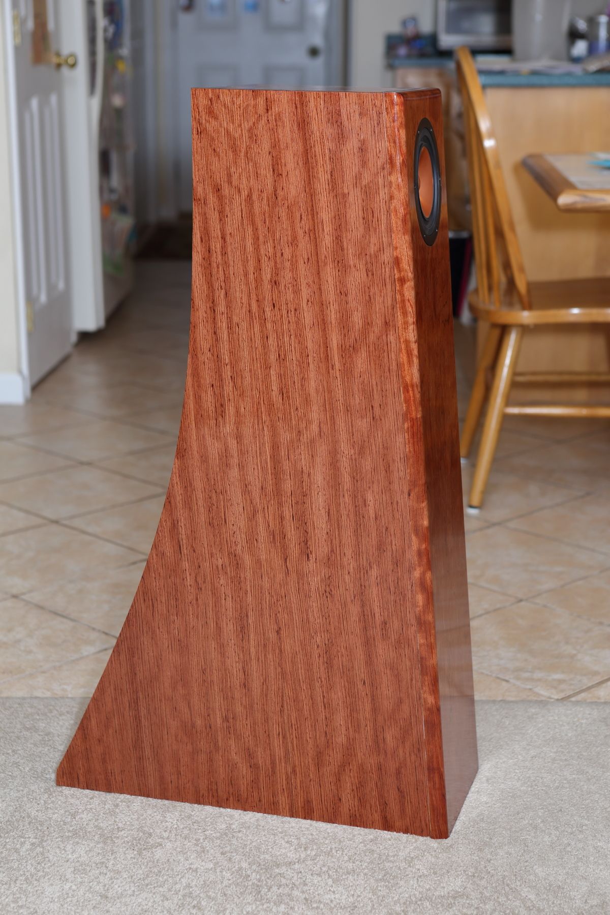

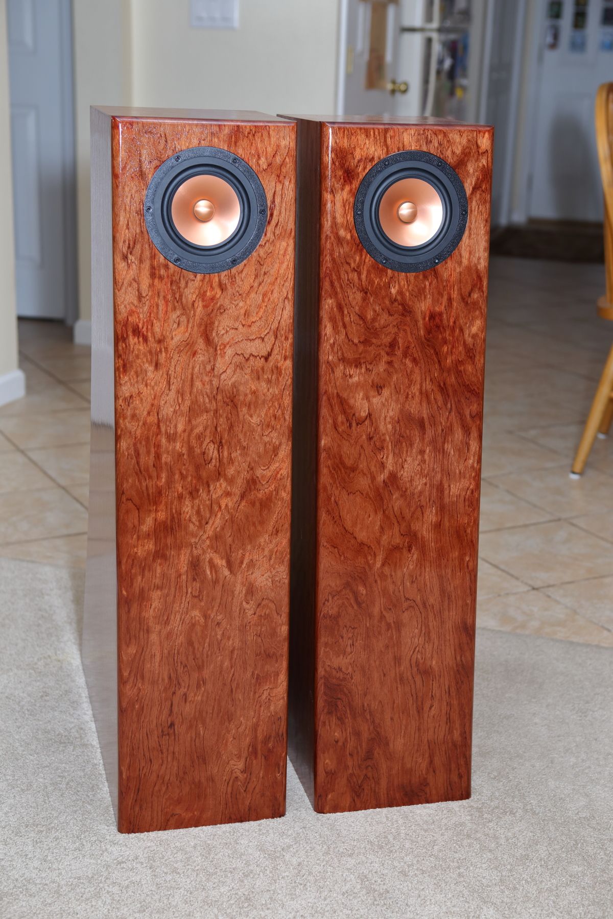

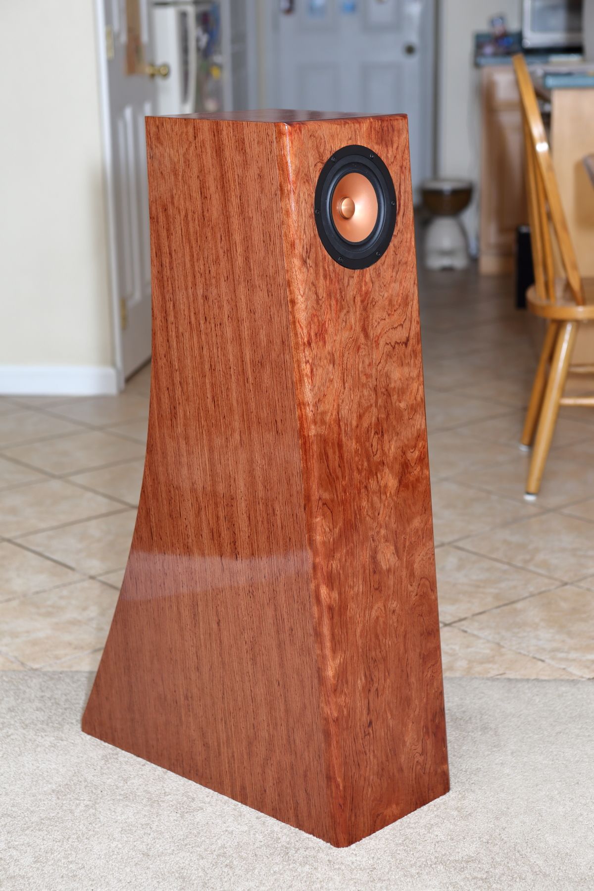

Here are the final glamour shots of mine. The bookmatching on the baffle is easier to see when they are side by side. They sound lovely on music, though something sounds a little strange to my ear when listening to TV voices (like the news) - perhaps a pinch heavy in the midrange - but I would need to do some measurement to be sure. I think they need more break in and then I'll probably start playing with the stuffing level. I don't plan on making any changes until they get a few months on them. My vinyl sounds just awesome!
How are you planning to change the stuffing as the boxes seems to be sealed .. is it by removing the speaker driver ? Will it make the screws loose if we reopen multiple times??
They look beautiful - congratulations on your build!

Thanks, Zman. It was a fun and interesting learning experience. Having never used veneer before, I was a bit apprehensive. But after a little bit of practice, I got the hang of it and managed to lay it down without any bubbles or ripples.

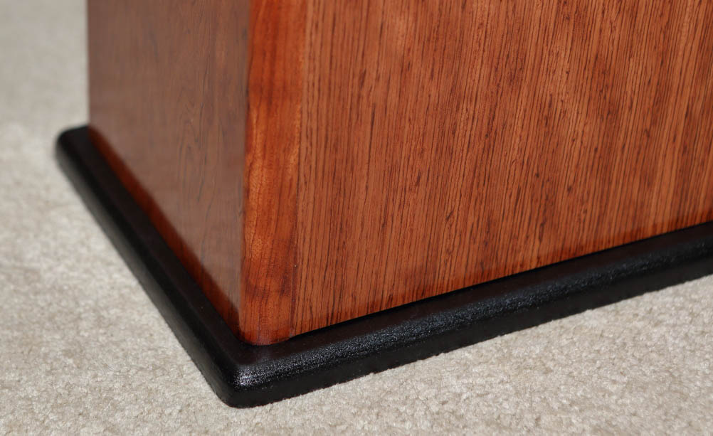

I made one more tweak to my FHXLs - I added a base to keep the vacuum cleaner away from my nicely finished wooden cabinets. I used some glued-together scraps of BB ply, made it extend out about 3/4" on all sides, rounded the corners, hit the top with a 3/4" roundover bit in the router, and finally applied a few coats of textured truck bed liner. The resulting base is screwed to the bottom of the cabinet. It fits nicely with the textured black frame of the driver.
