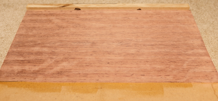

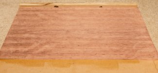

Here are some images of my work so far. My first effort with a small piece of veneer didn't go so well - I ended up with a wide set of ripples. This made me panic a bit and wonder if I made the right choice with 10mil paper backing for my veneer. The 20mil is often called "wrinkle free" veneer. I just figured I was doing something wrong...
So, I took a few of the scraps and tried again, starting with the smallest pieces first. This worked better, but I wasn't sure why. Perhaps I had used less glue, perhaps I had let it dry a little more before I applied the iron. Also, these pieces were just applied to flat wood. My speakers have a small lip caused by the front baffle that I cut larger than needed so I could flush trim after the veneer was installed. So, with some success on smaller pieces, I made a larger piece of wood and added a lip to it so it would more closely approximate the speaker that I'm working on.

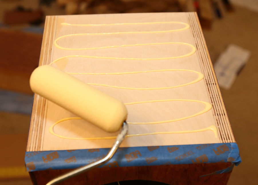

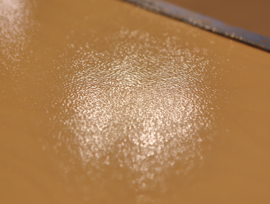

I used a foam roller brush that seemed to work well- it leaves an egg shell pattern behind. I put two coats of glue on the wood, letting the first coat dry first, one coat on the veneer, and let both surfaces dry more thoroughly before applying heat. This seemed to work well.
Chris, as you mentioned, the roller comes with its own plastic bag that fits over the roller end, so I put this on and put the whole thing in a ziplock bag. It has stayed good for over a week now. Should give me enough time to finish the whole project.

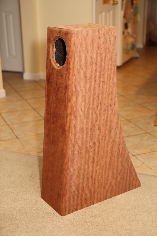

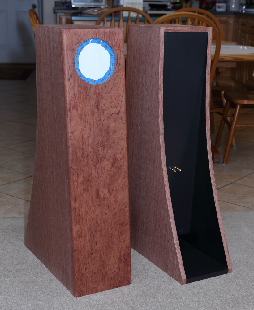

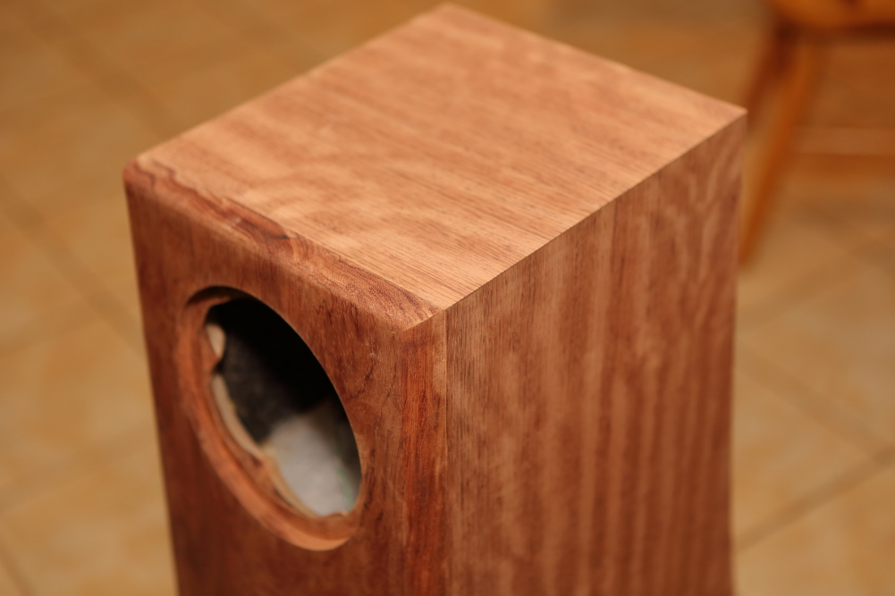

So here are a few images of the completed speaker. Getting the veneer to mate nicely at the seams is a bit of a trick. I presume it would have been a bit cleaner with a brand new flush trim bit, but my bit chewed away the wood and most of the paper, leaving a very thin layer of paper pushed down along the adjacent edge. I also made a bit of a mis-calculation as I tried to flush trim the back of the top plate, forgetting about the 5 degree tilt, so the bit chewed right through the veneer exposing a bit of the paper backer. Oh well, at least my goofs are on the back of the speaker where they will be hidden away. The second speaker is glued and clamped right now and will get veneer in the next day or two. I am really pleased with the match between the color of the veneer and the hardwood. The seam between the two is not perfect if you look closely, but looks nice when you back up just a bit. This is an interesting learning process for sure!
I was not able to match the side veneer to the top veneer - I was trying to keep a larger chunk of left over veneer for a possible center channel build. The third image is also a bit dusty on the back, I had just finished the rough sanding to smooth the edges. Next is sanding with 220, 230, 400 and maybe 600 before I start with the finish.

Planning for a wrap-around / continuous grain pattern on a shape like these is certainly fun, and wasteful of material, but it is what it is.
I don't directly apply the glue to the panels or veneer pieces, but use a small paint tray to load up the roller.
I trim the veneer by sanding through the top layer of overlap with 150G PSA paper on a hard block on the long grain, and trimming with 2" bench chisel or plane blade. In the cross grain direction, I find a careful downward rotational slicing with the chisel followed with the 150G block is less risky than a router trim. If paper backed,this will expose a thin line on the edges, but once finished that's not often an issue.
But of course, we all develop our own methods after a few projects, and whatever works for you
Looking good, and should pop nicely with some finish.
Those look absolutely incredible as they are. I can't wait to see them with the finish applied.
And I'm with chrisb; don't sweat the router "goof". Anyone who'd notice has likely never built a speaker before - and almost certainly not one with a cabinet this complex.

It is surprising how challenging this cabinet is to build. Even after running *ALL* of the "internal" panels (baffle, internal divider, rear panel for both speakers) through the *EXACT* same table saw set up and verifying the precision of the cuts afterward, there were variations in board width that needed to addressed before the second side panel could be glued up. I guess I had uneven pressure from the clamps that squeezed out more glue in some spots and less glue in other spots. I guess the rule for clamps is the same as publications for tenure: you always need "n+1" where "n" is the number you currently have. That sanding drum and my drill have been very useful for making small adjustments to the panels here and there!

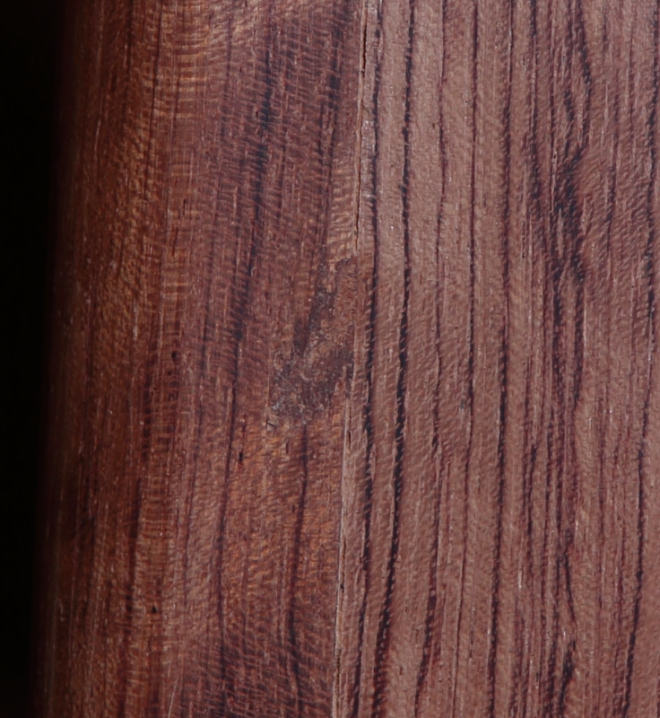

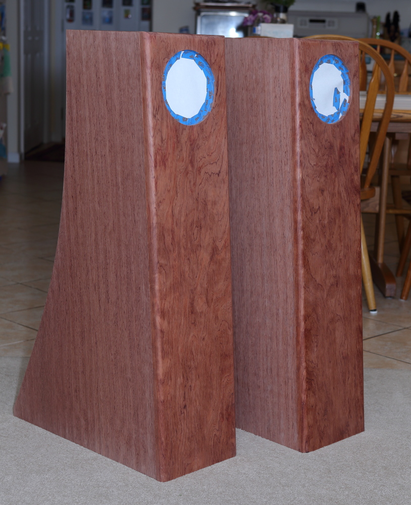

Here are some updated images of my progress. The veneer is completed on both cabinets and turned out fairly well. Like everything else, there is plenty to learn from a project like this.
I probably over-complicated the design of this speaker by laminating a hardwood slab to the front baffle. This means I had to make it a bit over sized so it could be trimmed after the veneer was added and that I had to create a finished cut along the long edge of my veneer before I attached it to the cabinet. Strange as it sounds, cutting a 35 inch perfectly straight line through veneer is a rather challenging task. Making multiple passes works better than a single pass with the razor knife and I found cutting from the front produced a cleaner edge than cutting from the back. After the veneer was mounted, I flush trimmed the baffle, which left me with a rather large tear-out on the side 😱 It took a few rounds of glue and pressing saw dust into the hole in order to fill it sufficiently well. The hole was about 1/2" long 1/4" wide and nearly 1/8" deep 😡 The patch turned out pretty good (see first attached image), but took several iterations to get it there.
After sanding down the veneer, I realized that I probably should have spent more time sanding the surface of the baltic birch plywood as it looks like a few of the ridges show through the veneer a bit. I didn't consider this possibility and am hoping that the finish will help hide some of this.
So here they are before any finish is applied to the cabinets. I managed to avoid the trouble with flush-trimming the rear of the top panel by taping an extra thickness of veneer to the back. I also applied some painters tape around the sides so the flush trim bit wouldn't leave a mark around the perimeter where the bearing rides on the side.

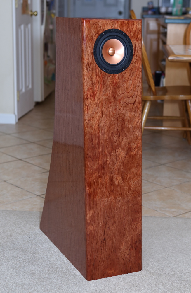

And here they are with two coats of finish on them. The finish is Formby's Tung Oil Finish Low Gloss - not sure if I want them this shiny or not for the final coat. I'll have to play around with how the finish is applied.
I really LOVE how the highlights and figure in Bubinga shifts as you move around and catch the light from different angles. It's really an eye-catching effect.

Here are two shots of the almost-completed speaker. The driver is just being held in place with two screws for the photo. I'm still working on adding layers to the finish. Not sure yet if I'll leave it with its more natural rubbed-on finish look, or if I'll take it down with a grey pad and then buff lightly with a polishing compound. It seems that the cool effect of chatoyance is more subdued with a more matte finish... decisions, decisions...

Thanks, it's turning out better than I thought it would when I started! I knew this wood was special, but you don't really get to appreciate it until the finish goes on. I'll bring them in the house this weekend for an audition - have to wait for the smell to die down a bit so the family stops making the funny faces when I haul them into the house.
