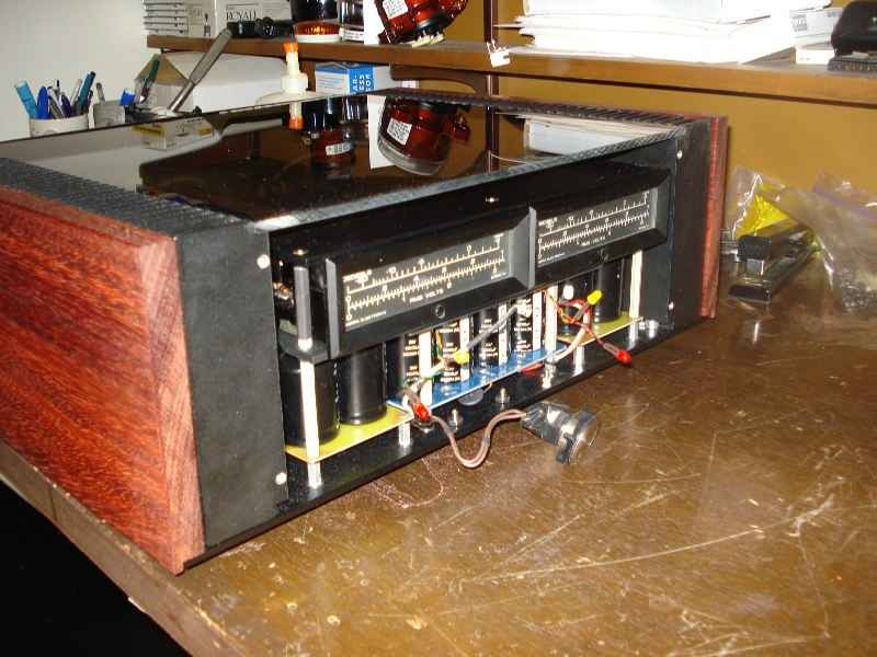

All, some photo updates to my F5 build. In reality, I've been enjoying my F5 in an "open chassis" configuration for the last few weeks, so I've been concentrating on "cabinetry" and a minor mod to my 1970-era Weston VU meters.

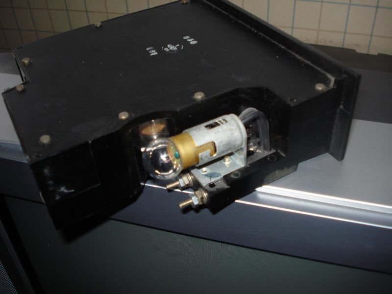

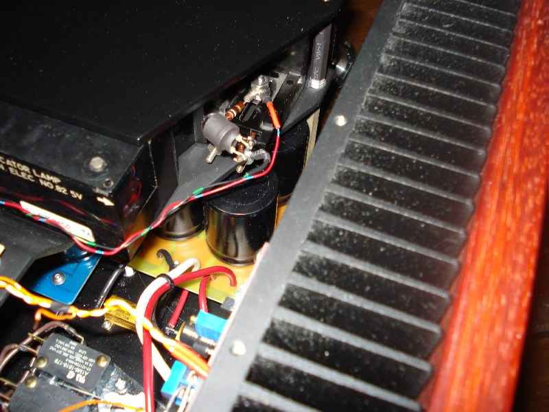

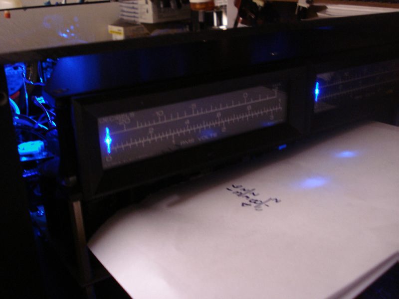

The first pic shows the original 5W incandescent lamp installed in one of the VU meters. This lamp illuminated a slit aperture and lens on the side of the meter case, which in turn hit a small mirror mounted on the meter movement. From there, the lightbeam was projected to the rear of the VU meter face. (Pretty nifty, huh?). In the second pic, I have replaced the lamp with a 0.5W (5 vdc, 100 ma) blue LED and limiting resistor. The LED has roughly the same "directed illumination" as the original lamp, but without the current draw and heat generation. The only tricky part was getting the LED in exact alignment with the slit aperture to maximize the display on the meter face.

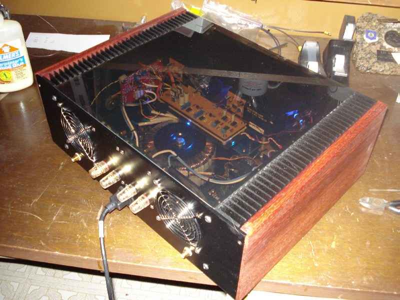

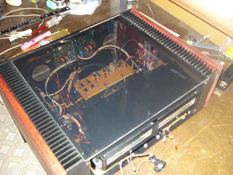

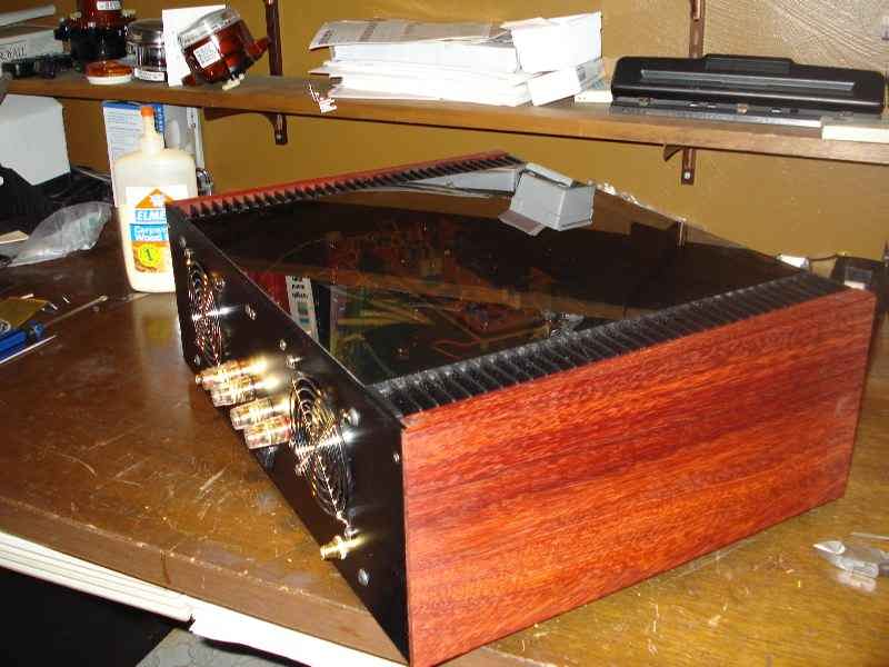

The next photos show the amp side panels. These were made of African padauk hardwood, to closely match the rosewood side panels on my other amps and tuners/pre-amps. I finished these panels with a Watco oil-based cherry wood stain. The top of the cabinetry is a 1/4" thick piece of Bronze acrylic plastic (Plexiglass, by brand); the heatsink baseplates were machined to permit the Plexiglass to installed flush with the heatsink top fins.
Because of the side panels, the heatsinks are recessed inward on the amp chassis. I use two 90mm 120 VAC shaded-pole induction motor fans to create an airflow internal to the main amp chassis, and then the air flows through channels milled into the base of the heatsinks (lower edge of the heatsink baseplates), and then upward between the heatsink fins and side panels. Since my amp heatsink temps (and MOSFET temps) are somewhat dependent upon the fans, I have installed thermistors into the two heatsinks, and constantly monitor temps. I presently have the thermistor "alarms" set for 50 degrees C, and they have yet to trip. The two fans are run off mains voltage, but through a 600 ohm dropping resistor--this drops fan speed measurably, and also significantly reduces fan blade noise. I currently have some minor fan noise, but I suspect once I finish the cabinet (front panel) this will muffle the remaining noise.

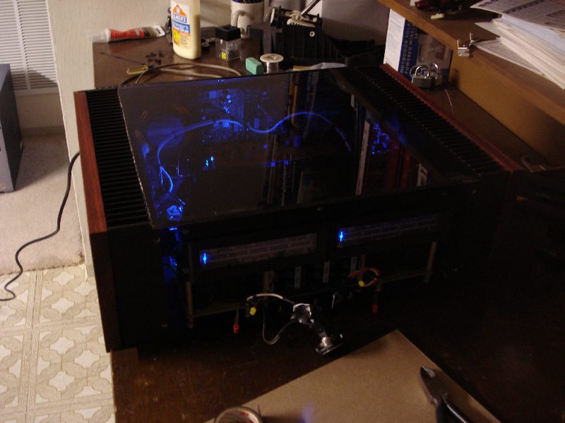

Another pic shows the two VU meters, and the display provided by the 0.5W "projection" LEDs. These displays are easily visible in all lighting conditions, and are kinda spectacular in a dimmed room.

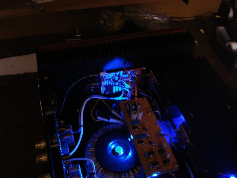

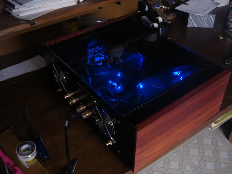

Other pics show the amp "illuminated". I figured to "go for the bling" (for now) and added three small 5MM blue LEDS to the underside of my vector board controller, to highlight the inside of the amp......and besides it justified the use of the Plexiglass top plate.....!
Enjoy. Again, if you have questions or comments, please fire away.
