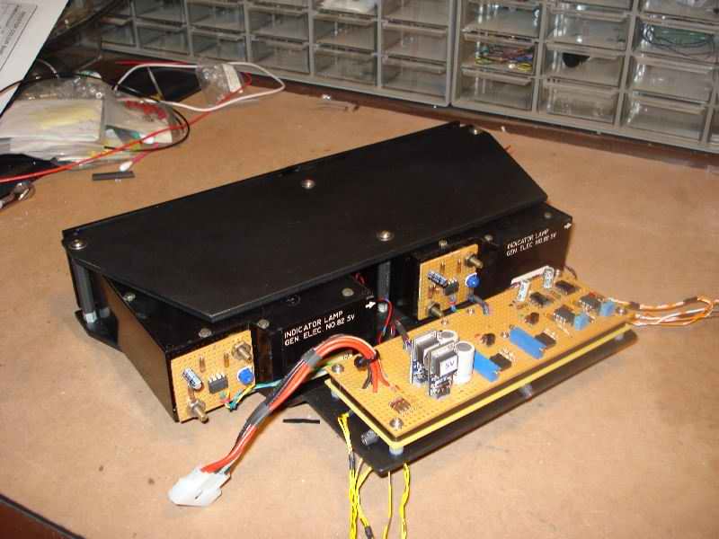

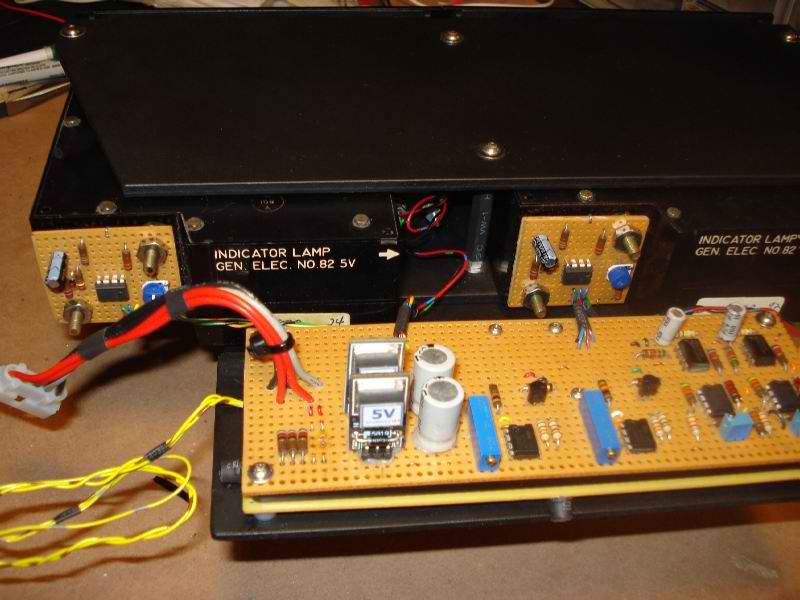

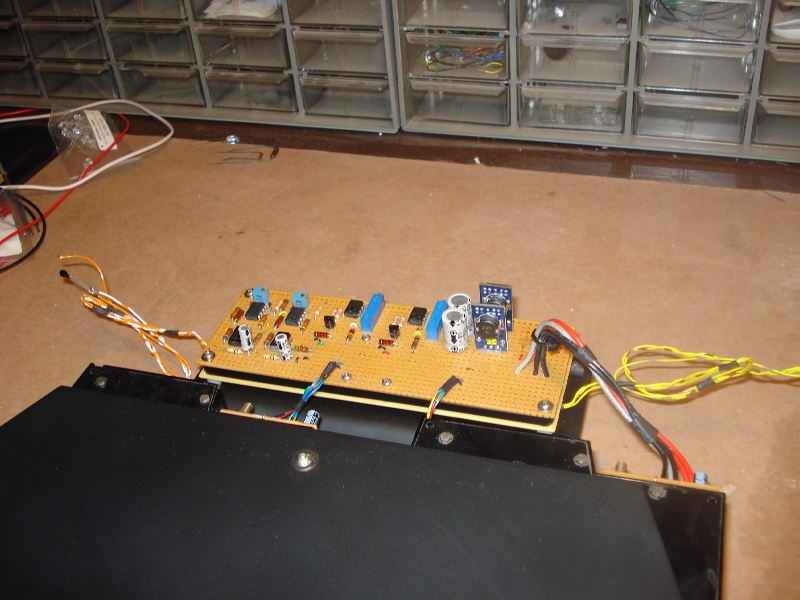

Today I finished the VU meter "subchassis", that includes the VU meters, VU meter log drivers, clipping monitors, and heatsink temp monitors. It also includes the switching regulators (5V and 12V) for the monitor circuits, LEDs, and speaker protection PCBs.
I built this unit as a subassembly to ease construction. It also permitted me to test the "pure" F5 amp (finished today!), and also allows me to strip off the VUs, clip and temp monitors in the future, in case I want to revert back to the basic F5 amp without the "bells and whistles".
Some construction pics attached.

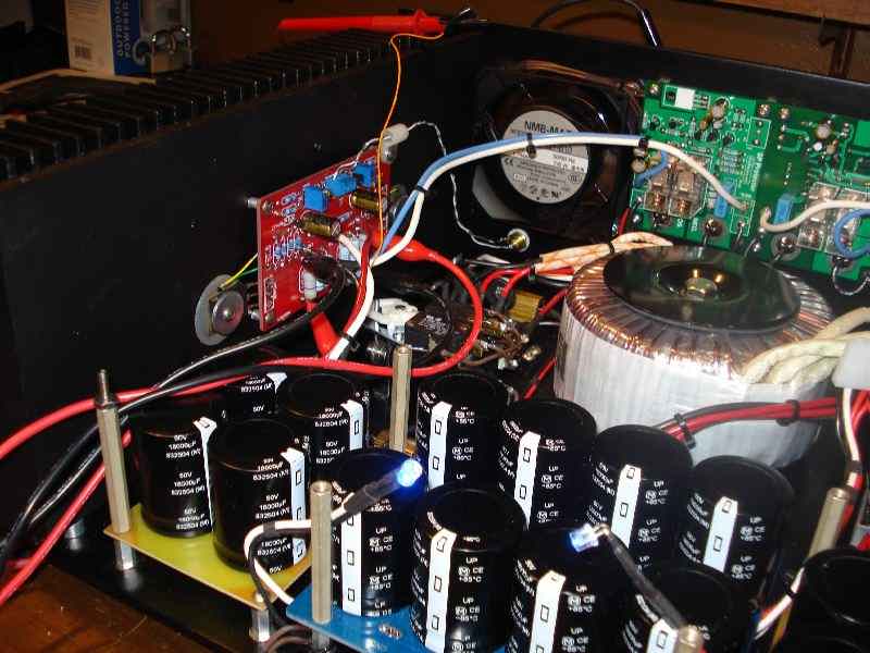

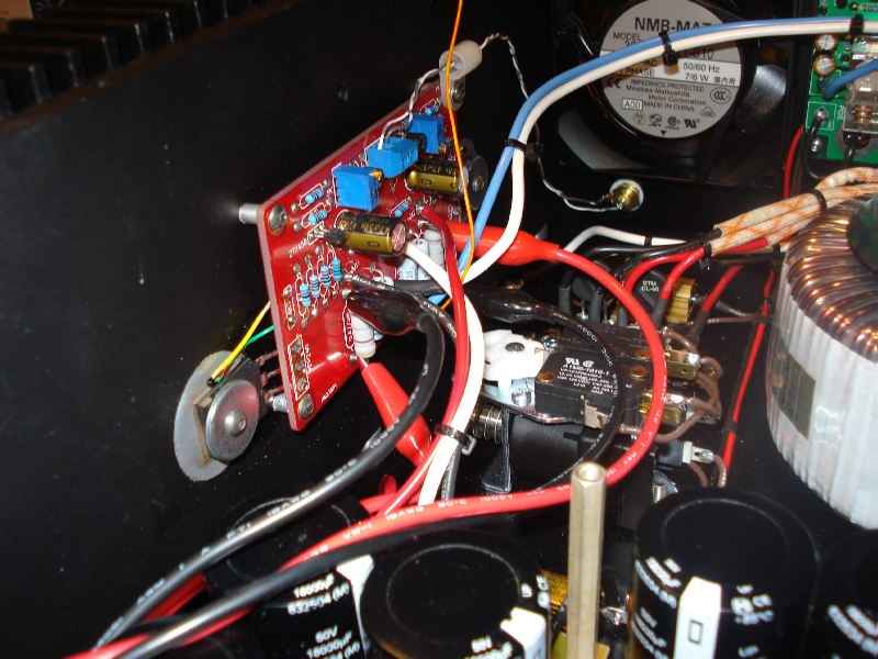

Again, the basis amp is completed and tested. I'm currently burning in the amp modules with 4 volts across R11 and R12. Temps are moderate--between the Conrad heatsinks and cooling fans, there are no cooling concerns. I will check further, as I button up the amp in the final chassis configuration, which places more reliance upon the fan cooling (and less use of traditional convection cooling). The VU subchassis (shown in the attached pics) has also been fully tested as an assembly.
I still have to research and identify an ultra-bright LED (160,000+ mcd) to replace the 5-watt incandescent bulb(s) that are used as the light-sources for the projectors in the VU meters. Might go to surface-mount, heat-sinked SMD 1-watt LEDs to do the job. (I'm open to suggestions!)
All that remains is final integration, resetting bias voltages, and full-up testing.

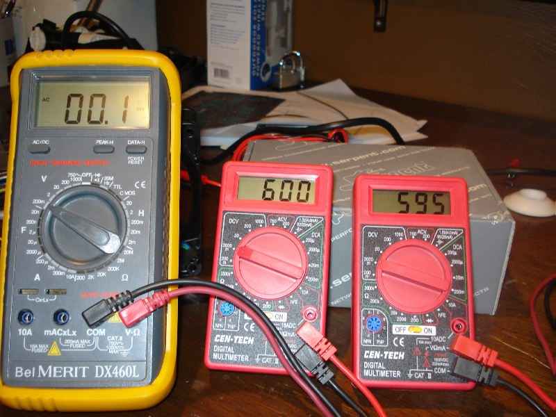

Set the initial biases yesterday (yes, ZM--they were set at 0.4 volts....!)
Brought up to 0.6 volts this evening, and let it idle for two hours. No surprises. Very well behaved. Minimal drift. Heatsinks probably a little too cool (Conrads, currently in an open chassis, with a low-speed muffin fan blowing across the back (flat) side of the heatsink base).
Pics attached.
The two small DMMs are showing the voltages across R11 and R12. (There was some minor variation--by swapping the two DMMs, a few mVs of this deviation was identified as variations in the DMMs themselves, later confirmed when I hooked both DMMs to a common low-voltage (0.7 V) source, and their readings differed by 4 mV. I can live with that.)
The larger DMM shows the output DC offset, which varied between 0.1-0.2 mV over the two hour period. 40-MHz scope showing no oscillations.
