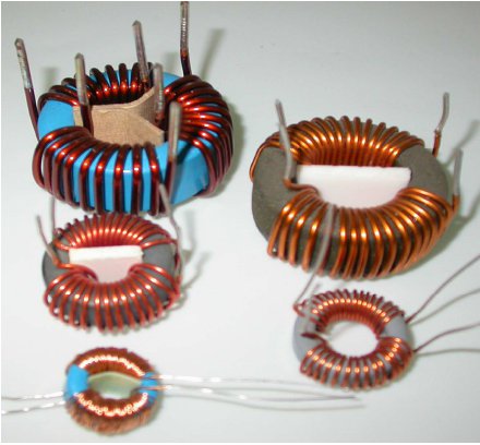

the primary wire 50 turns 0.5 (4 Ohm impendans) second 25-lap pro 0.8 (2 Ohm ribbon). the toroidal size may be anything
0.5 = 24 AWG 0.8 = 20 AWG I THINK YOU HAVE GOT IT RIGHT AWG conversion table
the coils are opposite one another as photo show?thank you🙂can kindly make a pencil drawing?😉
A 2 ohm to 4 ohm impedance conversion will require a Turns ratio of 1:1.414 not 1:2.
Impedance transformation is the square of the winding ratio.
Or "Impedance ratio" = "Turns ratio"^2 . 😉
If you use a 1:2 turns ratio then your reflected impedance will be 8 ohms not 4 ohms, In which would be okay too!! 🙂

Compared to the negatives of using a transformer Jer, resistor evil might not be that bad at all.
It is an even bigger deal when your ribbon is only .1 ohms or so then your losses will 90% with just using a 1 ohm series resistor and it will be 99% using a 10 ohm one.
The biggest issue about using a transformer is choosing the proper material core type and size and then calculating the correct amount of primary turns so that your core doesn't saturate at the lowest frequency of operation for whatever your peak operating voltage level would be.
This is only a concern for the lowest frequency of operation and does not apply as the frequency goes up.
As ribbons don't have any significant amount to inductive and/or capacitive reactance they are considered to be purely resistance.
Because of this there aren't any real complications of resonance peaks and such as compared to ESL with transformer+panel capacitance's and transformer leakage inductance.
To do the nature of such a design any of the resonate peaks that there are will be much much higher than that of the audio band.
This is true even for the common Torrid power transformer cores I have tested so far that have a large amount of self capacitance.
Resonance's are typically above 50Khz to 100Khz and even as high as 600khz for some of the ones I have on hand.
For frequency's above 1Khz have a hard time detecting any added THD due to the transformers core at low to moderate power levels with my 24bit sound card that is rated to at least .005% to .002% THD.

Here is a Great chart that I just found on some of the more common Toriods that you find that are color coded.
http://skory.z-net.hu/alkatresz/porvas_gyurumagok.pdf
The Yellow/White on in post #780 should be a Material type 52 and is one of the highest permeability types in the list and this is what you want to use as #26 is another one as well.
I haven't experimented with these types of cores for the audio range very much yet, But I did use a Yellow/White core (#52?) for my homemade magnetometer and it worked Great!!

If you make the transformers right, the loss is very low, and they can be wound so have flat frequency response.
One thing, never put the windings opposite each other. That can cause high frequency loss. Interleave the windings on toroid's for audio use!
