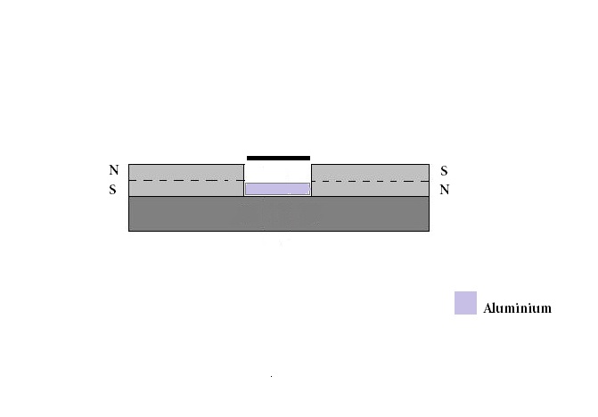

try simulate this one
might have some advantage to use wider magnet, instead of squared.... like 0.5" x 1.5" (magnetised through thickness)
I don't get that model going too well? The Bl drops when the ribbon moves forward, and increases when it moves backwards, not good when designing for low XO and high-ish SPL... Side-to-side Bl-linearity also not as good as with basic model, the sides of the ribbon get considerably more driving force than the center. Correct me if I have simulated wrong.
Also that is not dipolar model, which I would like my ribbons to be. I might make them convertible between cardioid (forward firing) and dipolar with detachable steel-ish back chamber that would also redirect magnetic field. Or then I just damp the rear wave with some resistance/damping material, much simpler and might be more transparent acoustically/sound quality -wise.
Mentioned model with 1.5" x 0.5" (magnetization direction 90 and 270):
Basic model with 1" x 1":

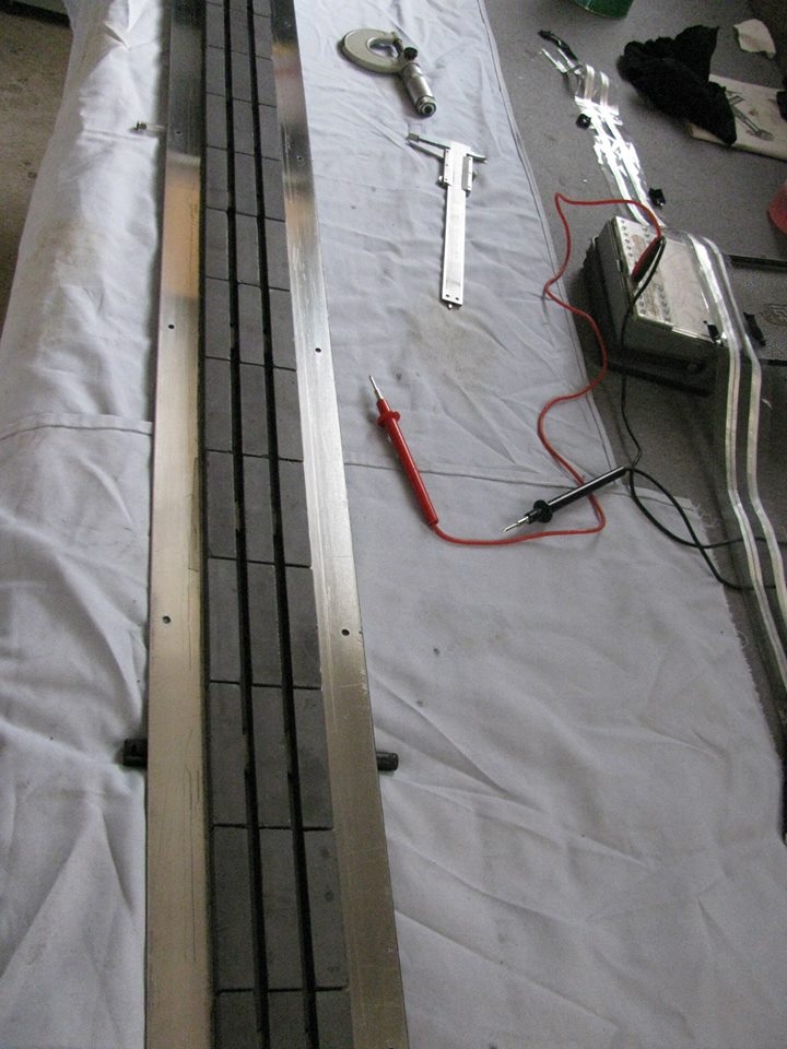

I'm hesitating about the gap between between the magnets.. as you can see in the pictures I'm trying to move them together. Anyway, they seem to work fine.
http://dsl.mine.nu/galleri/misc/band1.jpg
http://dsl.mine.nu/band.jpg

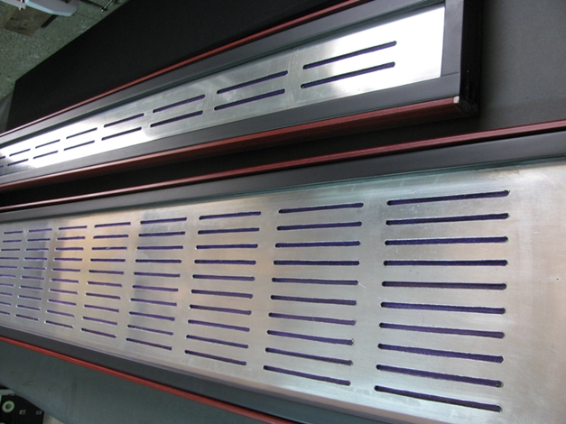

How did you attach the magnets to the U-bar? Did you dare to drill holes in them?
I have a Swedish 50cm long ribbon/1" wide ribbon transmission audio true ribbon driver, and I think he glued the nd magnets to aluminum front and backplates. It is open on both sides so they can
Sensitivity is low compared to TPL-150, maybe just 90dB. But sounds much clearer, but not as powerful sound below 3kHz, so I cut it off above that and use it as a supertweeter.

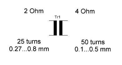

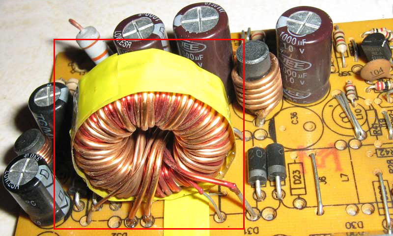

Which is the desired frequency range?can anyone help me? I need to transform from 2 ohm to 4 ohm ribbon in my tw I need some scheme of transformer thanks
