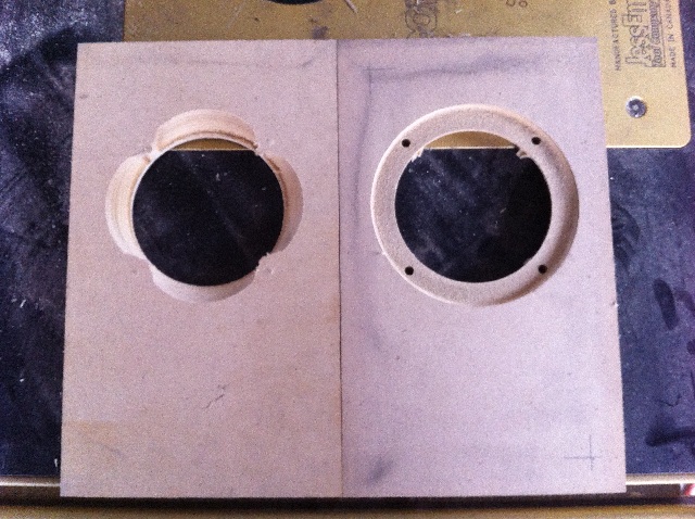

I have a decent wood shop and have ,by luck, a small CNC machine (Roland PC-3000 ) that I have made a tool path to cut the front/back for the 125's. I was hoping to spend a little time and come out with something nice for the great room with money already spent for the most part.

Oneof the originalimpetus for thebipolar-bipoles was tobeabletocompare WR125 with supertweeter (small audax from ApexJr in a waveguide the thickness of the panels, and the FR125, so we had one on one side and te other on the other. You could likely get away without the tweeter.
Since that design we had more experience. Sealed, so the shape has little or no effect on the bass alignment. The original was 20 litres (10/per driver), but i'd now reduce that to 7 litres or a bit less. Also if you increase the width compared to the depth you get less bipole dip (and it decreases in frequency. One can also roll off the back driver below the dip. Note: the dip decreases as you move off axis until dissappearing when the drivers are side firing (from your pov)
dave

7 per driver for a total of 14 (or less) is what you mean here ?
Jim -- I found your original plans in my archive of notes after this post ( Like a squirrel with lost nuts ). In light of your reply it seems like adding the tweeter is the better end result. What did you use ? Same as Dave suggests or different ? and filter specs.
Dave just made it harder to decide since 14L can get me into very good WAF territory 🙂
