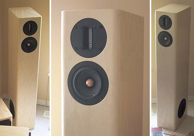

Here is the pic i missed attaching earlier. The above map will be updated to reflect the wider baffle as soon as i get a chance.
dave
maxro said:is that a passive radiator on the side? I didn't see any mention of it?
Those are a picture of the RAW HT3. That is an Adire Extremis on the side. The purpose of posting was to show what a 7" wide baffle with 3/4" roundover looks like -- the drivers on the front are WR125 + a AC 2Gsi

maxro said:pretty pictures
Chris just sent me some. I'll get a comp up later to-night.
