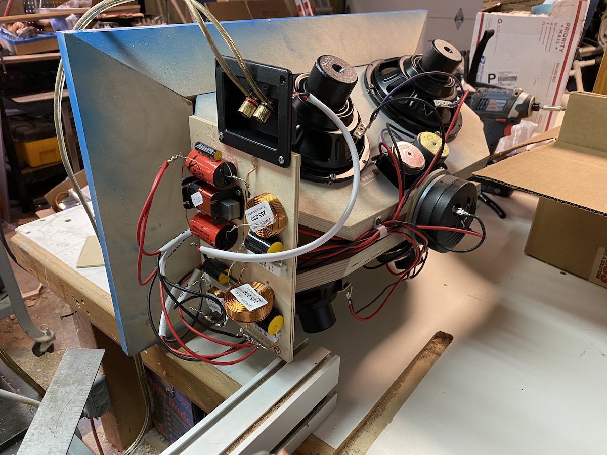

I have been test fitting drivers. the cone drivers are straight forward but the CD is giving me trouble. The Celestion has blind threaded holes facing the horn flange. I had assumed incorrectly that the CD housing would have through holes - that would have allowed me to put long screws through the driver housing into the flange.
I can align the driver so that two of the screw holes are accessible - I would be able to fit socket cap screws in there between the mid drivers. would two screws be enough?
Two studs are enough.
Progress has been slow - I haven't had as much free time as I thought :-\
I have three primed cones built and ready for final paint but have not started cabinets yet.
I decided to wire one up yesterday and take it for a spin - sound is really great! even with the open baffle.

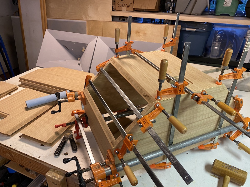

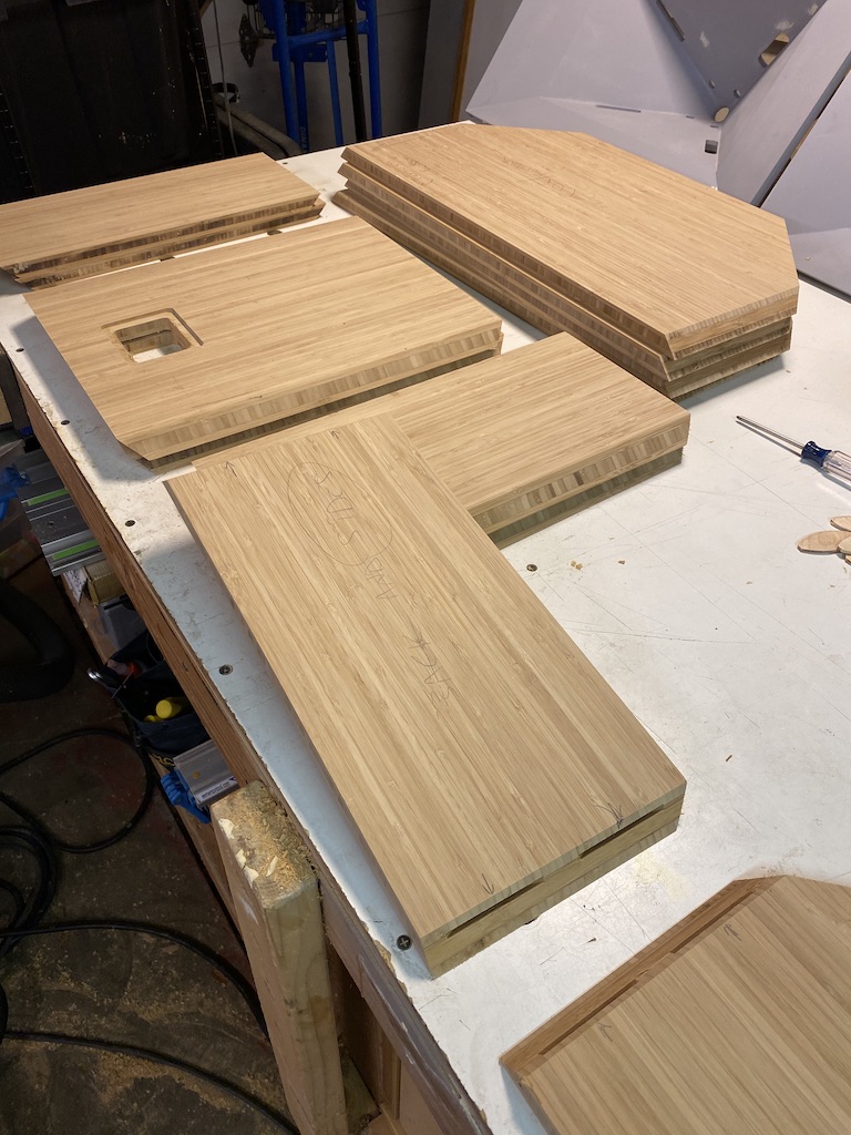

Just got back to my synergy project!
I'm making cabinets out of bamboo. they're based on "tony's cab" design but I've tweaked the dimensions a little
I have the first cabinet (of three) gluing up.
Very nice !
Synergy's redefine number of clamps needed, huh ?
