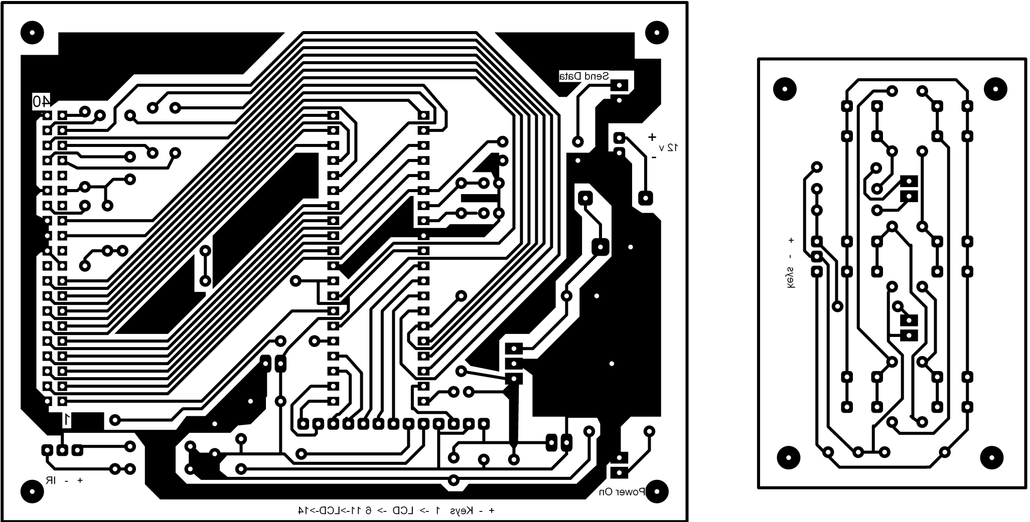

I checked the eagle files. The files as posted need
major cleanup/corrections.
I did fix some of the issues in my local copy, but
you (Holmes81) probably did all that already.

Also I've uploaded created another set of schematics, and separate PCBs due to using the free version of eagle cad. The idea behind separate schematics and pcbs is that you could leave out various parts, eg the IR part or mount the switch part futerher away etc.
As before they need to be verified by someone who has not spent ages looking at them!

Ok ignore the schematic and pcb in post 149.
I've checked the schematic and tidyed the schematic up and added a few annotations.
Now I will start work on the pcb.
Use the schematic attached here.
thanks to quadtech for verifying the V4. If someone could check V5. (Should be final)
Thanks.
Thanks.
Still working on this board. It is a little more complicated than I though (well that's my excuse for being a bit rubbish at pcb layout!)
Watch this space as they say!

Quick update,
I've moved away from eagle to DesignSpark.
I now have the completed pcb layout in gerber form, which I am attempting to prototype!
Double sided diy pcb etching is a little tricky!
Keep watching this space!
For the ones who are interested, here are my PCBs.
One for the controller, the other for the keyboard.
My project is fully working.
cabest, nice work.
What s.w did you use for the PCB? Can you
publish the PCB files? Or at least the pdf version and the
component layout?
component layout?
