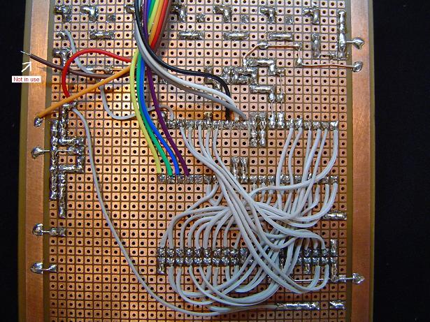

problem
hi Mr. Pradit
your project is nice
i build it from your PDF file on a vera board, but i have a problem
pls help me
the circuit is not work
1- i checked connections
2- i checked wiering
3- i checked pic programming process
pls say your pic programming parameters
example osc. type , watchdog timer , power up time , Brown out reset & .....

Hello,
What 's problem?
Does the LCD screen show any thing?
What your programming method ( low volt programing or high volt programming? for my program need to use high voltage programming.
Do you change CDROM pin to Master?
For setting already declare on beginnig of program.
Check wiring carefully?
Pradit
What 's problem?

Hello,
The lcd shows nothing ( only in line 1 blank characters ) .
I use a Melab programmer in high volt programming .
My CDROM brand is A Open 52x in Master mode .
For Programmin i use this setting :
Osc XT
Watchdog timer Dis.
Power Up timer En.
Brown-out Reset Dis.
Low Voltage Programming Dis.
Flash Program Memory Write All
Code Not protected
Data EEPROM protected
I checked point voltage & wiring carefully .
when i finished programming the programmer shows ( programming OK & Verify OK ) .
I don`t know what happened .

Hello
If programming is OK.
Wiring is OK.
At least LCD must show
Initialize..
Loading..
If not,so please check wiring and solder point again.
Check your procedure to program PIC with simple program and circuit that verify that you still can program this PIC.
Can you take photo of your board with Macro Front Side & Back Side.
Pradit
