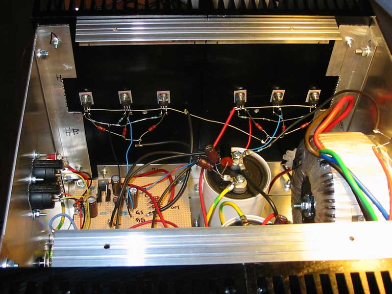

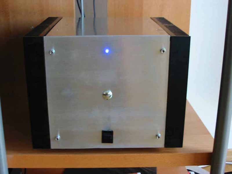

How warm gets your amp while leaving it running for about an hour?
I'm asking you this because I'm currently building a chassis for an stereo aleph 60. (each heatsink an aleph 60)
See link:
My amp..:-S
The size of each sink is 320x300x40
Hope this is enough to let it run warm..NOT hot😡
Thanks a lot.

After 1 hour it is pretty hot... Varm to the touch, but it is no problem to leave my hand on top of the sinks. I haven't actually measured the temp, but I bet it's somwhere around 50'C. After 6 hours it is a little hotter. Notice I have openings about 1 inch on the front of the bottom plate, and on the top of the back plate to get air flow through the case. I also driled some holes in the top plate, which helped some more. The temp inside the case isn't much higher than the sinks.

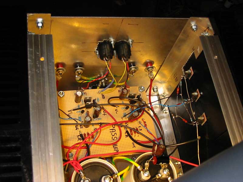

Anyway, for Remco: Here is some real measurements I made on the Aleph30. My sink dimensions are: 130 x 400 x 30 (h l w)
http://diyaudio.com/forums/showthread.php?s=&threadid=7610&perpage=15&highlight=jdev&pagenumber=1
These temperatures was before I decided to fit fans, I think it was O.K., but now I sleep better 😉
