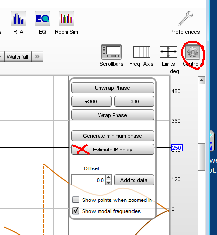

I am still getting unexpected and inconsistent results. I started using the built in acoustic timing with REW that led to more uniform results.
This tells me that you aren't getting the window around the impulse properly. For now, or any time you just need a response plot you can use the function shown in the attached image. This removes all normal delay from the impulse which lines it up with the left edge of the window but also includes some time before it. You then only need to ensure there is enough right window.

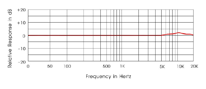

Looking at your DBX microphone, if the frequency response chart it shows is accurate then things are even more odd. It actually shows rising response from 5K looking like about +4db at 10Khz...
Is it possible the tweeters are faulty? Do you have any other speakers with extended high frequency response that you could measure as a comparison?

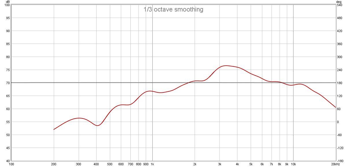

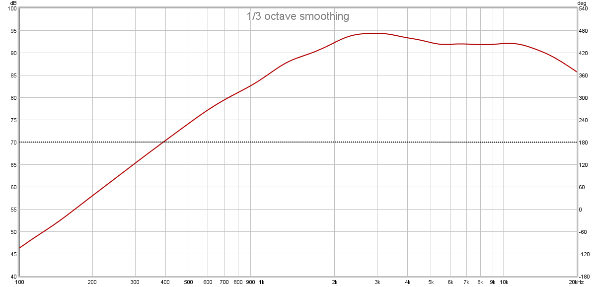

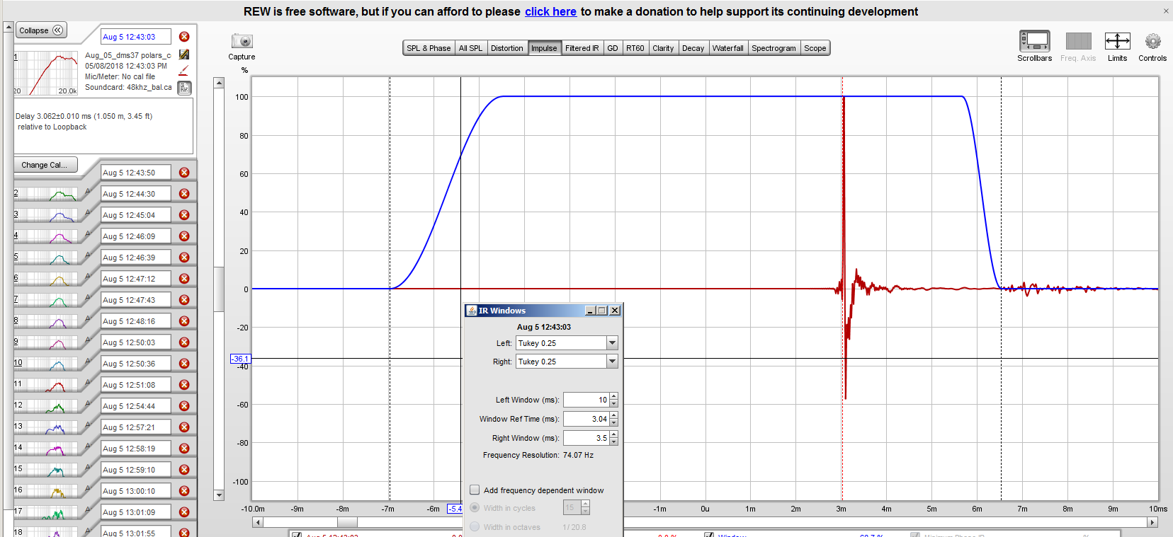

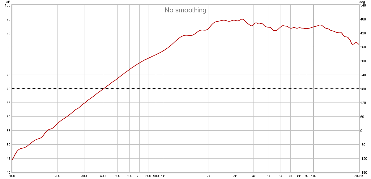

Just on what Allen said about the windows. Below are images of firstly incorrect and then correct windowing for my DMS37 tweeter. Note this is semi horn loaded so the increase at lower frequencies is normal. I had to use 1/3 octave smoothing to get something even close to the smoothness of your measurement, but the third one is with correct window and no smoothing..
Fourth image shows how I have the window set. Note that these measurements were done with a reference channel and the 3.04 ms was the baseline for all of the off axis measurements.
Tony.

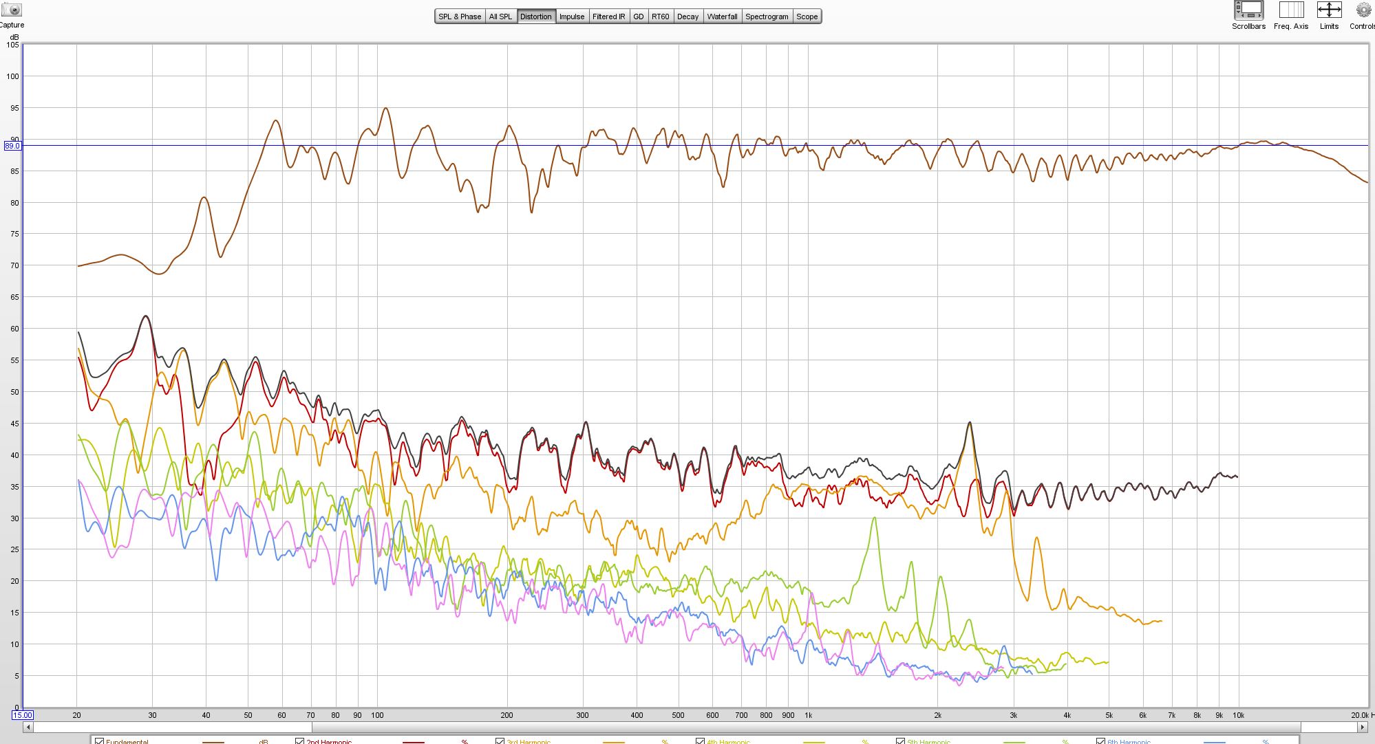

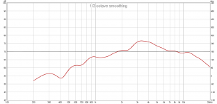

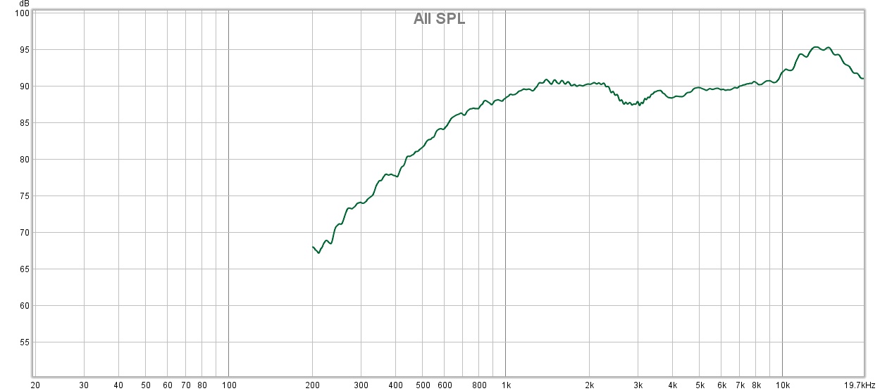

When I was new to REW I never gated or smoothed my measurements. I didn't know better.
This is an example of such a measurement with a correct calibration file and a decent input system. I was using a Dayton EMM-86 with a Behringer mixer and a e-Mu 1212m PCI.
The speaker in the measurement is this one: Zaph|Audio
The image is unsmoothed, ungated response which is why you see so much ripple. The average FR though is reasonably flat with a slight dip in the mid-treble region, which is in the middle of the tweeter's passband. You should have had something similar, but uncalibrated microphones and poor converters can get you some strange looking results. You should first do a loopback to establish baseline converter performance, and then a known speaker to establish microphone performance. REW can add or subtract results and arrive at actual performance of your design once these baselines are established.

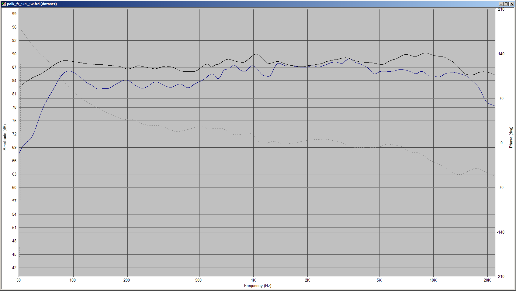

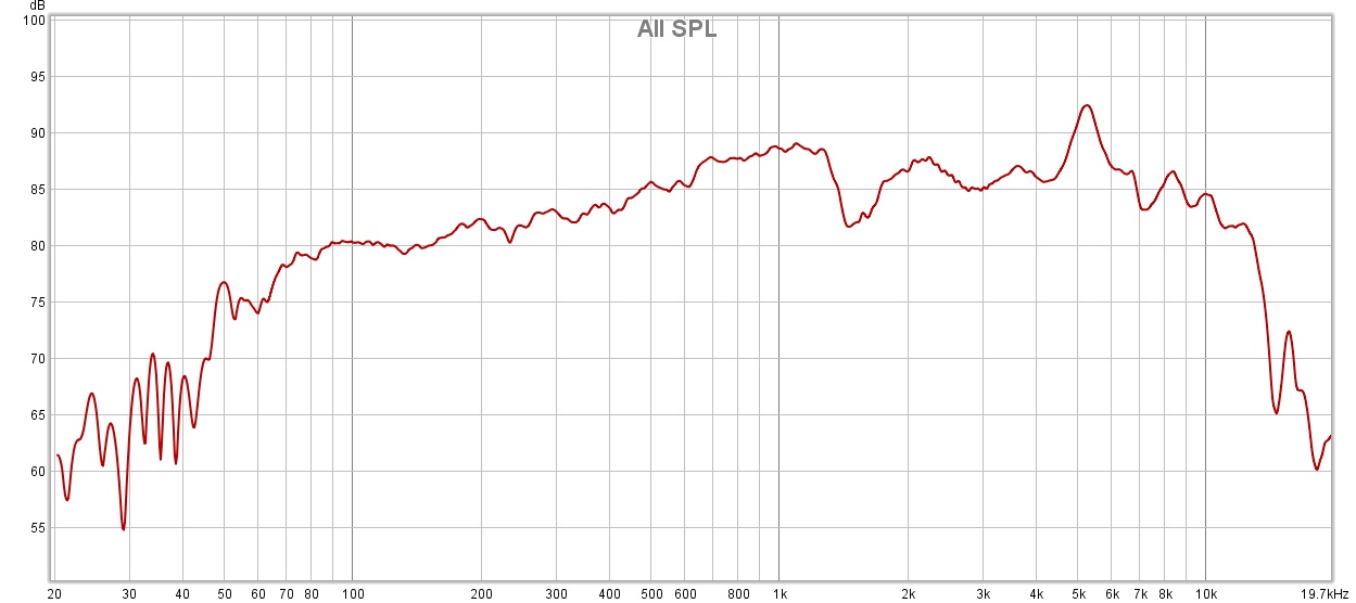

I only see the measurement of the polk in the file. It doesn't seem to have as much of a rollof in the high frequencies, but comparing it to measurements I found online Polk LSi9 surround speaker system Measurements | Sound & Vision
It definitely is showing the same trend as your other measurements when compared, in that the measurement above is tapering up in the higher frequencies and yours is tapering down.
I spl traced both and superimposed them in speaker workshop and you can see there is quite a difference.
Blue is your measurement and black is the sound and vision one.
Your measurement was very clean, no sign of major reflections at all, but I suspect that you are getting some interference from the ladder itself as it was hard to get gating that gave a smooth response. what I used for the comparison was actually 1/12 octave smoothed rather than gated.

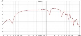

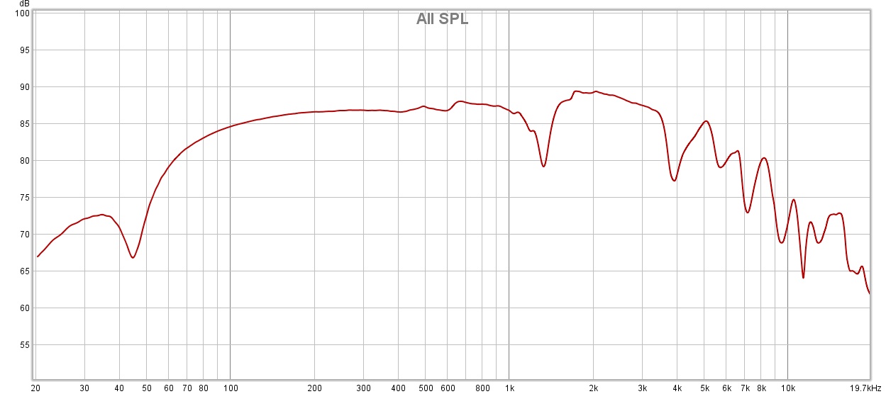

Here are the measurements with the new Focusrite Scarlet 2i2. I am still waiting on the new microphone and calibration file. It looks like I am getting decent results now. Thank you for the help!
Now I am turning my attention to crossover design and how to address some issues I find in these measurements.
I plugged these measurements into VituixCAD and I am concerned with the big dip in the woofer around 1.5K! It looks like I would have to take the tweeter very low to help fill in that hole. This hole doesn't seem to be there in the manufacturer's specs.
Do I need to break these in before measuring again?
How low would you take this tweeter? It's resonance frequency is about 500Hz so I should be able to push it down to 1.5K without a lot of issues... right?

Here are the jpegs of the measurements the previous files are from REW if that helps. Thanks for having a look.
It would also help if you had some rough values of components I could start with...
