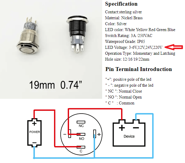

I gathered from your previous posts that you want a switch to control the AC mains input to a transformer. This switch is not suitable. Both the LED and the switch contacts are rated for 12V DC. This is worse than the first one. At least that one had contacts rated for 230V AC.
It may work at first if you wire it correctly but it is likely to break down later and it's not safe.

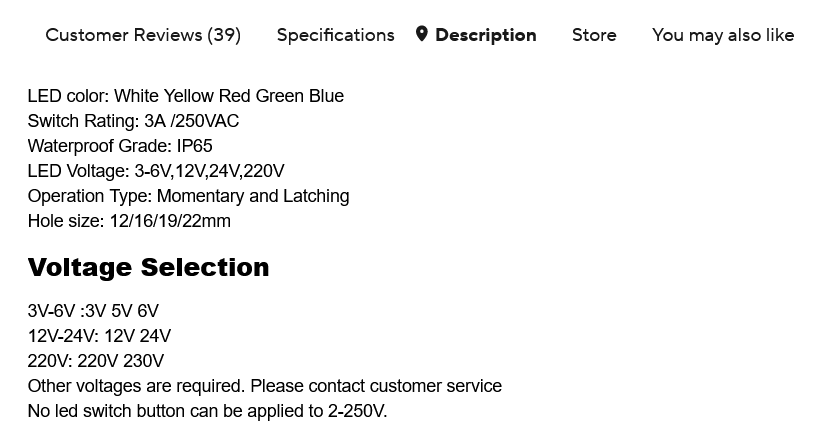

Check further down on the linked page in the OP's first post. It says LED and shows + and - marks on the terminals. It also says "12V diode".
The page is poorly organised but the info is there if you look carefully. The photo and the drawings don't match either.

But...... Audiophonics states 12 volt diode.
The manufacturer states lamp with no difference of + & - terminals. Who to believe??
Indeed pooly organized.

It states clearly: "The + and - are lamp terminals". LAMP..... Not LED.
It further says: "The terminals have NO difference of anode and cathode".
These illuminated push button switches are typically 250VAC rated and come with several LED lighting voltages of 12VDC, 24VDC, 110VAC/DC and 220VAC/DC.
For 12VDC and 24VDC types, the polarity needs to be connected accordingly. For 110VAC/DC and 220VAC/DC types, there is no difference between the anode and cathode on the terminals since two LEDs of different polarities are connected in parallel internally.

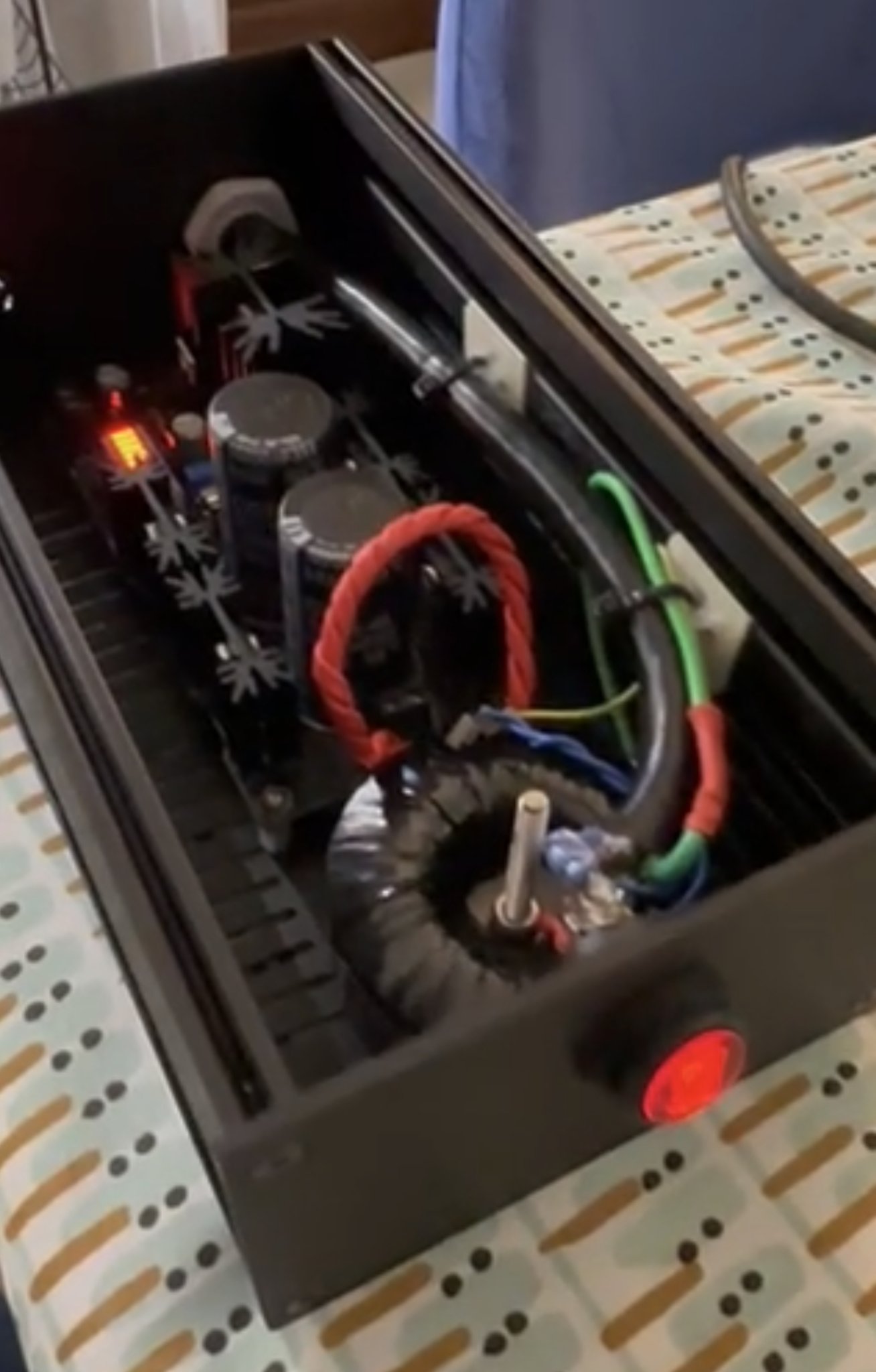

@Pimpom To be honest, I went to the local shop to buy a switch, and that one was the right one. I didn't check the brand but I looked on the internet to find it and this is the one that it matches. Check the attached file you may find it .

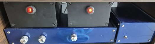

@Chymist
Nice DIY pieces of equipment (I guess a preamp + ext power supply + 2 mono power amps), just a bit raw-style (I like it), but I don't mind orienting most of the work (and money) towards substance and saving something on aesthetics.
The most important thing is that they sound good, as I'm sure they will.
Oh, the switches are nice too! 😉

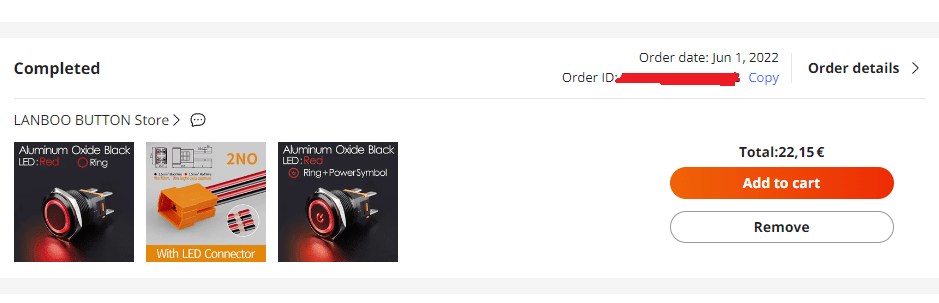

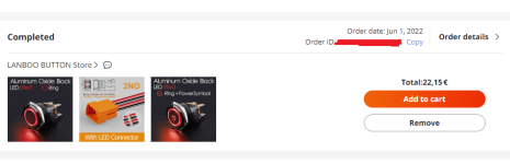

someone can help me to find a power switch with led as the ones on the posts but with double switch on ac line to isolate competely
Really, they're not too easy to find.
However, I've to thank you because thanks to your post I remembered having bought it two years ago, even though I no longer used it again (and at the moment I no longer know where I put them).
https://it.aliexpress.com/item/33055445497.html

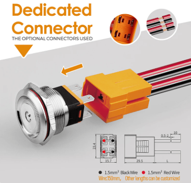

It is a quality switch, nice, short (because I needed it very short), with LED and doubled pins (2NO).
This model in particular can use a dedicated connector which is convenient and functional and in fact I also bought a series of wired connectors.
Furthermore, it does not have pins dedicated to the LED because the LED connection is internal.
I remember that that seller (with whom I have no tie, neither with him nor with anyone else) is also very open to custom built.
Please also note that its current price is ridiculously low (look how much I paid for 2 units with 4 wired connectors).
Reactions: waltube
