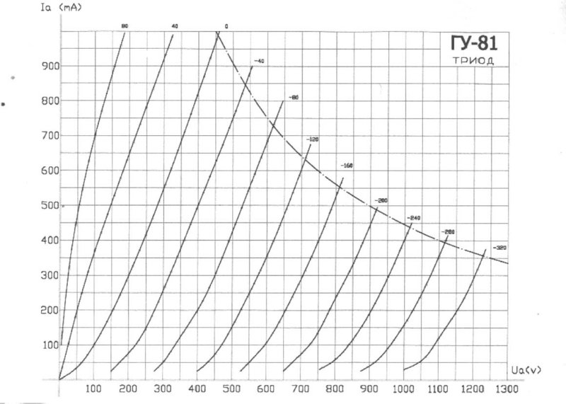

It's not really clear but the needle is placed across a 100ohm cathode resistor, didnt want to have 600volt on one side of my meter, It's on the horrible schematics on the bottom right side 🙂

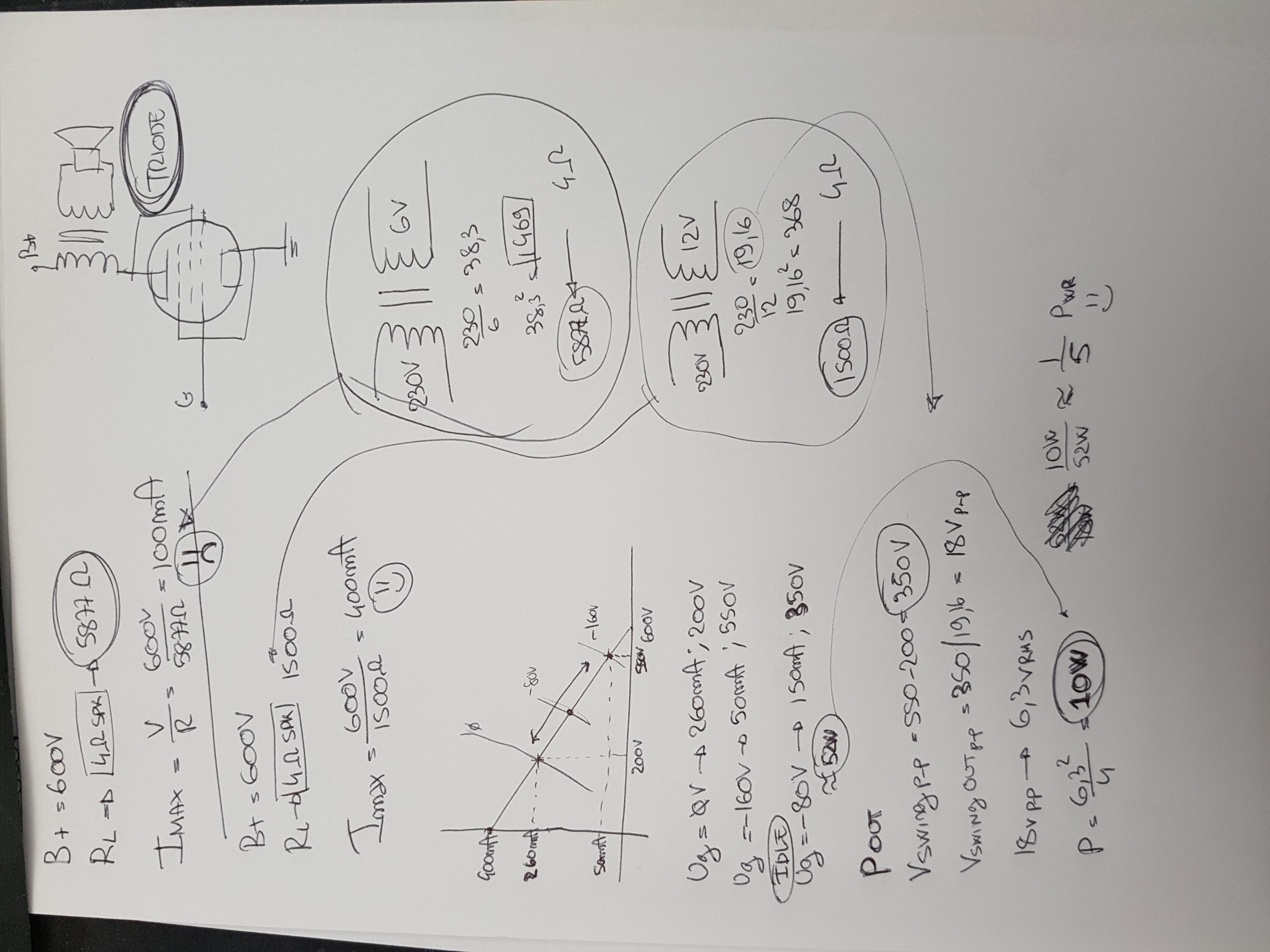

update
Sorry for the long wait had a few holidays and exams, 2 still to go...
I hadn't time to play with the spooky lamp but did some math, am I completely off or not?
I'm doing the same math with pentode curves, hoping for something more than 10w, will update later!

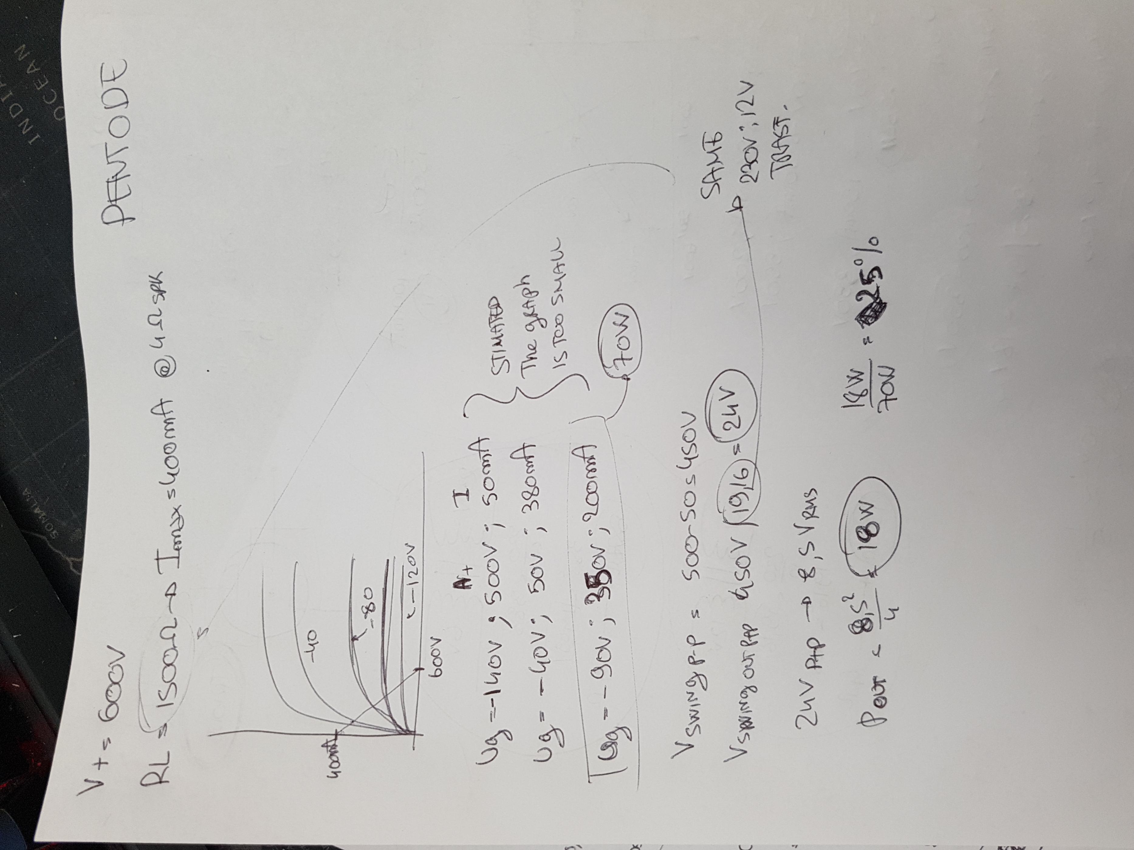

update2
Pentode curves, pretty rough, scale too small on the datasheet.
I'll take real world measurements as I remember different currents at various Ug1, with those I'll redo the math if is somehow correct the one thing that screws me up is the RL of the transformer :/

I may have goofed the math tho, as I've blindly assumed a voltage transfert on the OT to speaker without calculating the current on the primary AC resistance and then that converted to the speaker, am I right?
