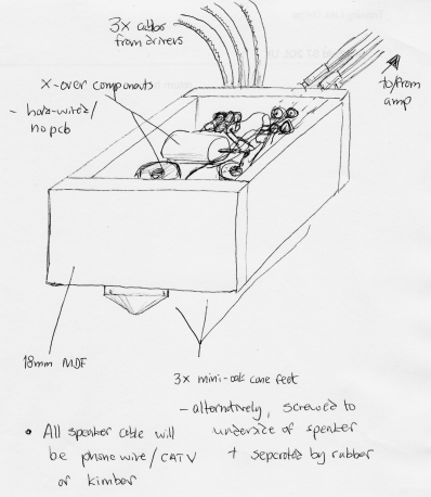

There are 10 individual pairs inside the sheath.SimontY said:Looks cool! How are the wires arranged wthin the jacket?
-Simon
Terminating involves fanning out all the pairs, seperating all the wires into two groups of coloureds and whites, marking the strip lengths and stripping the individual insulations, and then twisting all the wires in each group so as to make two conductors.
This can take a little practice to get it right and neat looking.
20-pair takes twice as much time but is sonically better again, and gives more than enough copper.

Hi Simon,
If you decide to go the telephone cable route (and I strongly recomend it), you only need to drill two holes through the back of the cabinets to get the cables into the box, and these can be easily plugged if you later refit the crossovers internally.
If you shock mount the crossover section on rubber o-rings or rubber strips or something, you can reduce microphonic effects.
Is the crossover section on a pcb and are you able to send me a layout diagram ?.

Hi Eric,
If and when (hopefully soon) I go external I will simply remove the 4-pole Speakon socket and use that hole, it will probably be large enough for 3 sets of wire (one per driver). I will solder the cables directly to the x-over, I don't want an extra connection messing things up.
The x-over is on a PCB with large, thick copper sections, but I'd like to take it all off and resolder it point-to-point - as it is I'm adding connections for no reason other than because they gave me these boards! The kit came with a photocopied sheet of the layout (for idiots like me!), but I will need to track it down, no idea where it is.
I'm thinking of making some simple boxes to rest on the plinths or be screwed under the cabinet 'crotch' area (please see earlier pictures to understand!). I like the idea of 'isolating' them with rubber. I have some spare 18mm MDF sheet, so that's what I'll use for the boxes. Guess I'll make 'em nearly as wide and deep as the cabinet, that way I'll have room to space the components away from each other, and will have room to upgrade the remaining metal film and electrolytic caps. The only serious cap at the moment is the series tweeter, which is a lovely Maplins pp one (the one in my avatar actually!).
I think the inductors will remain the same for a while (all fat air-cored beauties), but with a large, accessible box, I can toy around with impedance correcting circuits or whatever I choose to add in the near future!
I guess I ideally need to decide on better/apt. speaker cable before doing all this, as I want to 'hard-wire' it all.

Hi Simon,
My reason for asking about layout that this is mega mission critical, and most crossover pcbs that I have seen (and improved) are hopelessly wrong.
If not done correctly, sonically nasty resonance and IMD products can result.
Perfect star grounding and star input distribution is absolutely required, and most crossovers fall sadly short of this.
Also compensation networks need to be fitted directly across the driver at the driver connections, and not back at the crossover section.
I have a very nice pair of Canton 12", dome mid, dome HF, 3 way cabinets that in factory condition are pretty good sounding, but get a touch raucous/shouty when pushed overly hard.
A momentary glance at the crossover pcb layout reveals stupid layout errors.
Once corrected (layout and RC networks) these now go louder and stay markedly cleaner, cross between drivers better (12dB slopes) and none of those little transient and mids/highs nasties that they used to have.
I know I said it already, but make sure that all cable runs are in the same direction for good coherence across the whole audio band.
