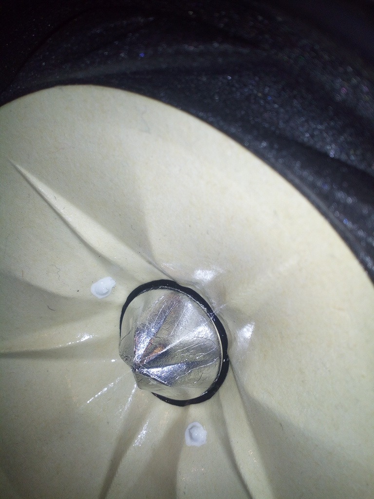

I think that much too seldom the structure is used to reinforce the material.
JBL used origami embossed titanium for their tweeters making stiffness much better.
Some car Hifi diaphragms for woofers use structures making a cone much stiffer.
Ribbed cone helps to lessen radial break up.
Fostex did it for the fe208 sigma driver
But also sandwich materials can help but rarely are used.
