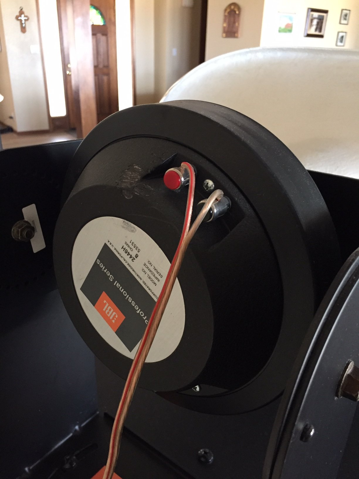

I really wish I could hear the difference between a aluminum/beryllium compression driver versus a aluminum alloy compression driver. But I can't. Even though I have Al/Be compression drivers.

In this paper the Al diaphragm is very close in performance (In my opinion) to the Be apart from in HF output where the Be has a clear advantage. The Al diaphragm drivers I have heard in real life all sounded great.
The CDX series from Celestion (3 of them) also are Aluminum alloy w/ poly surround, but they aren’t large format drivers with extended lower freq. response. Still, they might work very well in this (Unity) context.AFAIK, Radian is the only manufacturer who makes aluminum compression drivers.

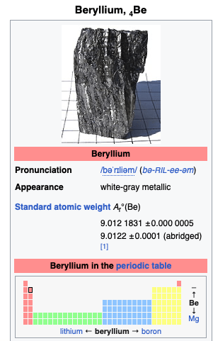

You can't form/machine/press/weld elemental beryllium and use it for a speaker diaphragm.
It is an alloying ingredient.
My opinion- no one is going to definitively define how a Be-Cu diaphragm sounds to me or anybody else. Just like nobody is going to solve fundamental physics problems on a diy audio website, solve world wide problems or imagine swirled peas. Okay, you can imagine whatever you want.

You can't? https://audioxpress.com/article/test-bench-eighteen-sound-nd4015be-beryllium-compression-driverYou can't form/machine/press/weld elemental beryllium and use it for a speaker diaphragm.
