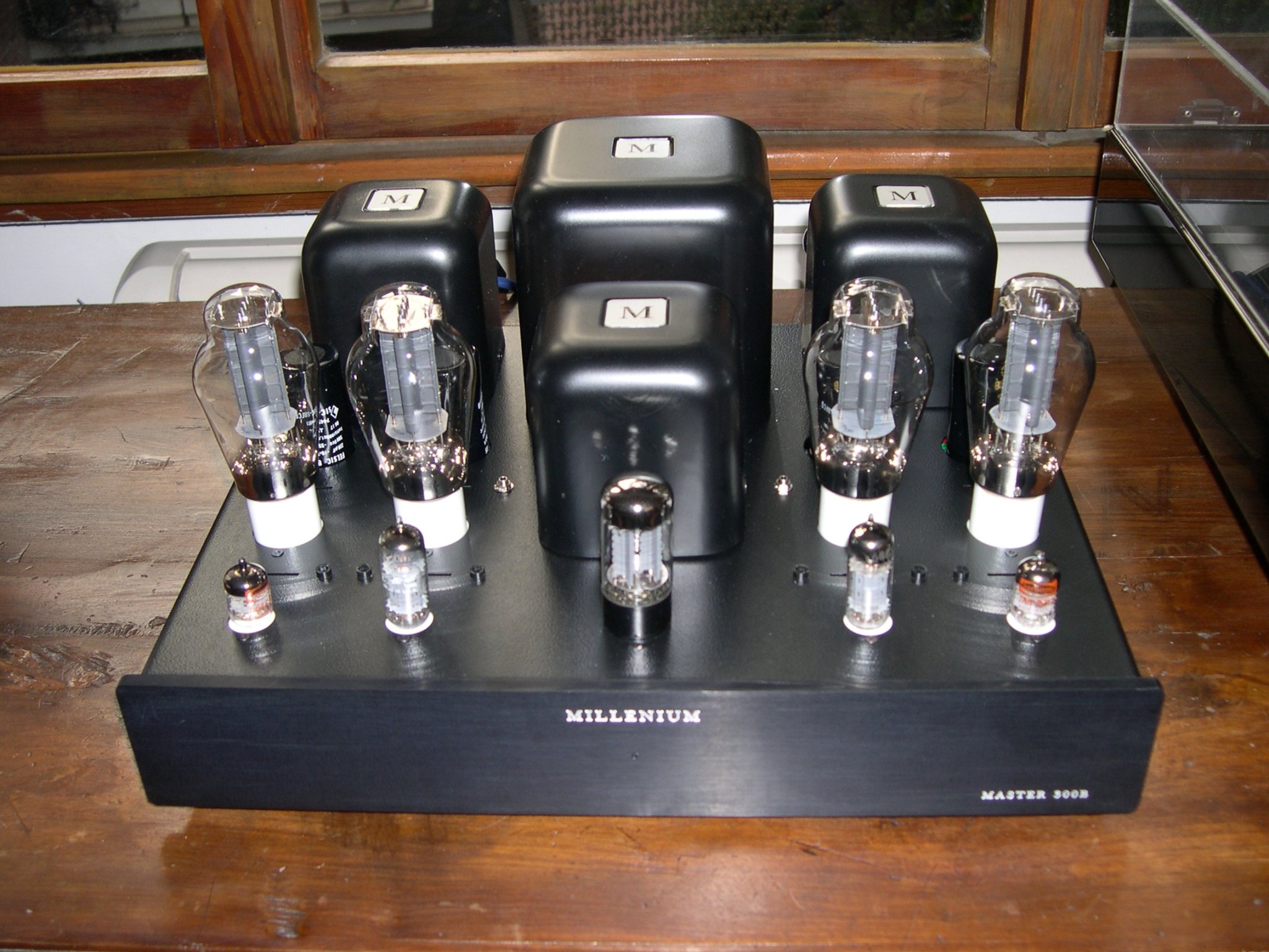

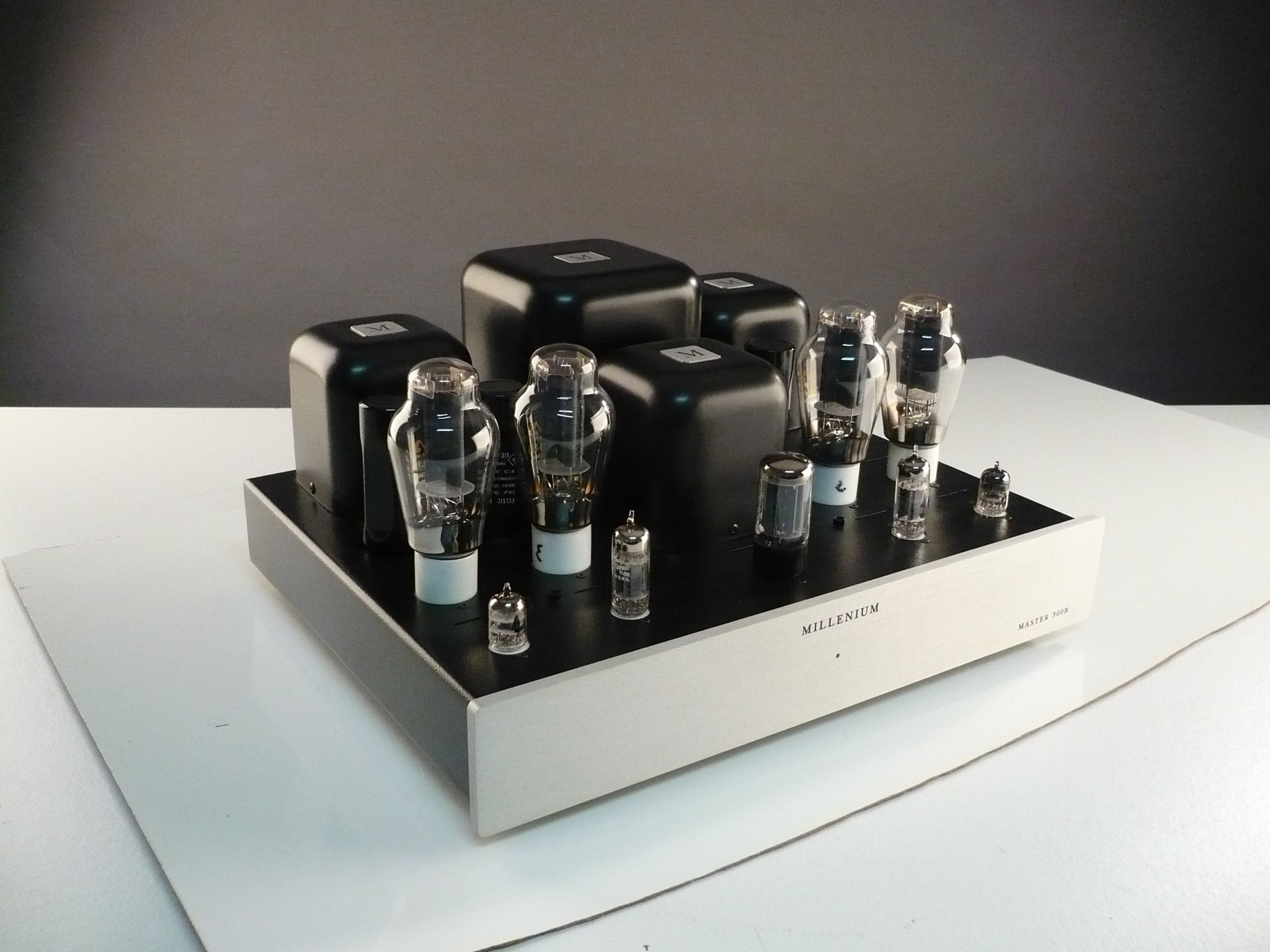

It is much better to build a p-p of 300B instead
with a good trnsformers, the results will be more interesting for different reason.
This is one my old stuff done years ago.
Walter

It is called P4 and these are monstrous boxes. I have them
There are OK; in the past was named Kit three, very good stuff.

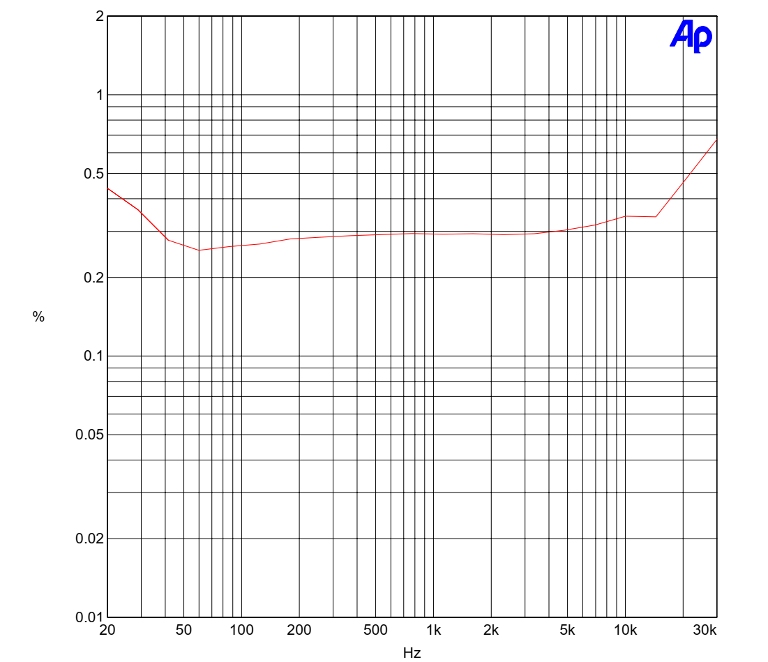

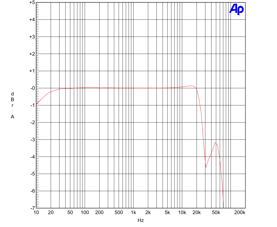

Some test done
the freq response at 3 Vout/8 ohm, there are some indecision around 50 kHz but non very important; the response on bass i good.
Very interesting is the THD vs Freq
It is costant and reach the 0,5 % at more of 20 kHz; It is good results.
