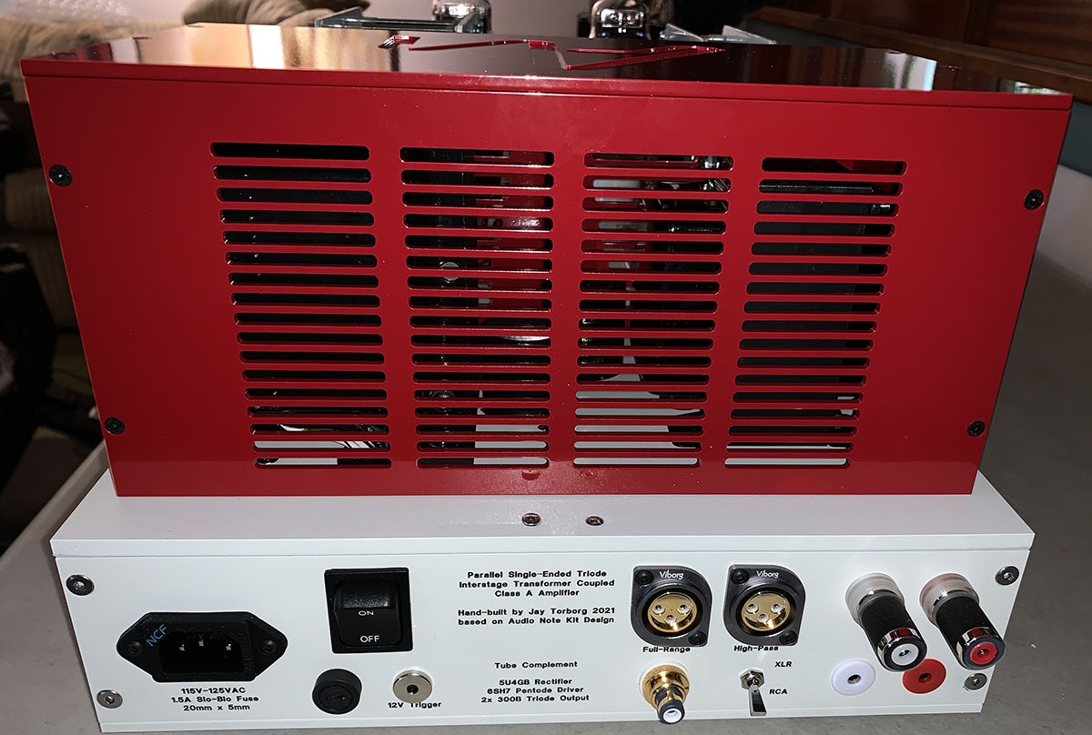

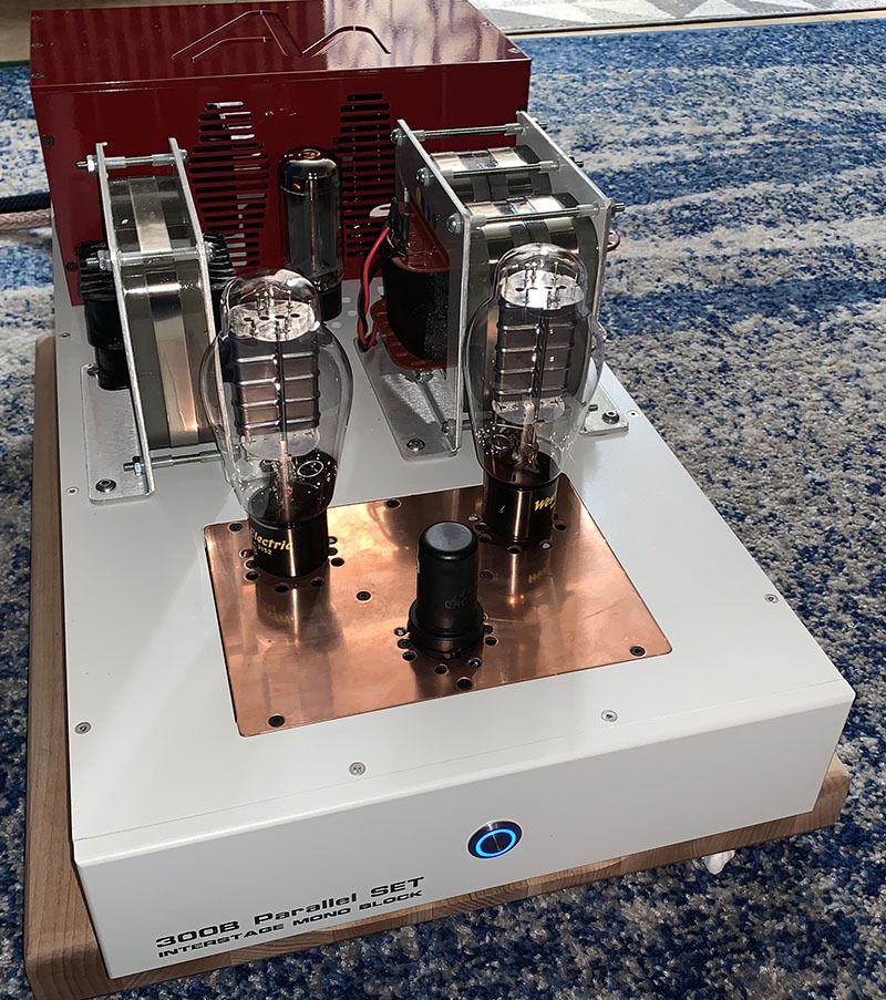

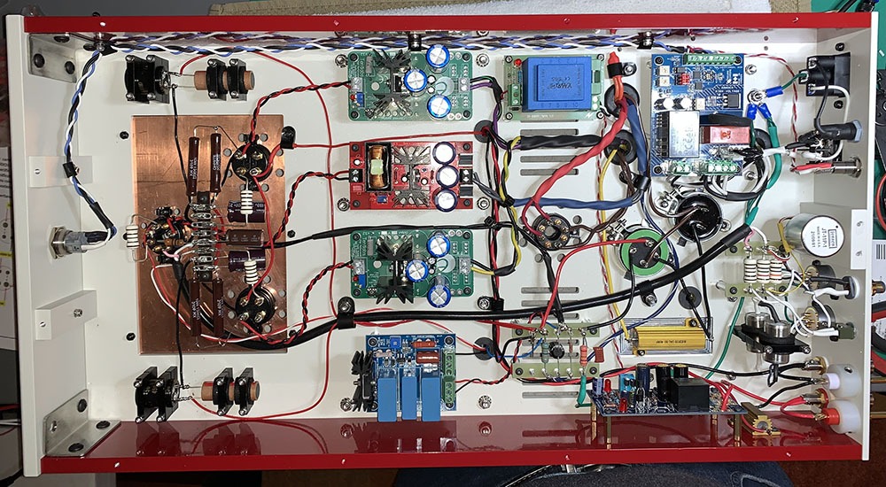

When I was building my first tube-based component, I decided to start with the ANK 300B P-SET C-Core Interstage monoblocks. I ended up making a lot of modifications - mostly to the power supply, filament regulators, etc. and ended up building my own chassis to provide a bit more space, move the connections to the back, etc. But I am using the ANK transformers.
I'm using these amps to drive fairly efficient speakers (~98db/w) with separately powered woofers, so the 300B amps are only used for ~180Hz on up. I'm pretty pleased with the way they sound - they replaced a pair of Pass XA60.8 monoblocks. I haven't compared them with other tube amps in my system (yet), but I think the ANK kits are a good place to start if you are looking for a fairly nice design that is easy to build.

Jaytor described the situation I was referring to very well. He bought the kit and ended up modifying the whole thing to the point he got a different amp altogether. I was trying to suggest you might want to avoid doing that. 🙂
