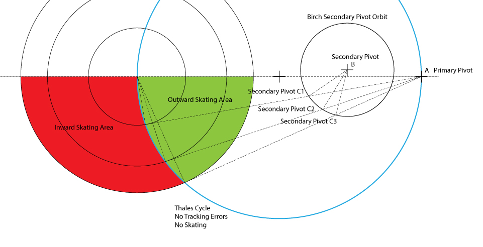

If stylus moves along Thales cycle, there are no skating and no tracking errors. In all other areas, both tracking errors and skating exist. Please see the drawing.
I call pivot A as primary pivot. A primary pivot can be a physical pivot or it can be a imaginary pivot. As long as there is only one primary pivot, stylus must move along Thales cycle in order to achieve free of skating and zero tracking errors. I call all other pivots, B, C1, C2 and C3 as secondary pivots.
If a tangential pivot tonearm is linear tracking, I am not going to discuss here.
If a tangential pivot tonearm makes curved tracking and has multiple primary pivots, the stylus doesn’t necessarily need to move along Thales cycle. As long as the cantilever is tangent to the radius of the LP, there will be no skating and no tracking errors.

super10018,If stylus moves along Thales cycle, there are no skating and no tracking errors. In all other areas, both tracking errors and skating exist. Please see the drawing.
I don't contest anything you say about tracking errors, but I disagree about skating. It is natural to want to assume that if tracking error is zero then so is skating, but this is not the case. Primary pivot A may very well serve as the virtual pivot that satisfies the math for zero tracking error. However, the drag force on the stylus acts on a real pivot, in this case a linkage comprised of pivots B and C. If the stylus drag force vector does not line up with pivot B, then the drag force will resolve into some component of skating force. You can have tangency and zero tracking error yet still have skating. The red and green zones in your drawing show regions of positive or negative tracking error, but don't correlate with skating characteristics.
Ray K
super10018,
Ray K
Ray,
You are right. Even before your post, I realized that my statement was not strict. I took Birch geometry to illustrate my so called secondary pivots. But I didn't mean there are no skating for arms based on Birch geometry as my drawing.
Jim
Ray is correct, irrespective of the geometry that the arm is based on. The key is to take secondary pivot B "out of the equation". If the (only) force vectors are congruent with the line: stylus - primary pivot A, and identical in length, there won't be any skating force(permanent tangential position a prerequisite).

Frank,
Yes. If there is no pivot B, but pivot C's do exist, the stylus will follow Thales cycle and there are no skating and tracking errors.
Jim
Jim
Here are my additional comments.
Congruent with the line. Yes.
Identical in length. No. From A to C's, the distance can't be identical in order to meet Thales Theorem. In other words, they can't be identical to achieve zero skating and zero tracking errors. If you mean from blue line to C, yes. They are identical.
Jim
Jim
That's what I meant to say: Stylus position = blue line.
So, to take B out, vector C-A and Vector C - blue line have to be of equal length. If B is fixed/rigid for any given moment in time(as it is in the serve-controlled Reed pivoted linear tracker), then there is no second vector.

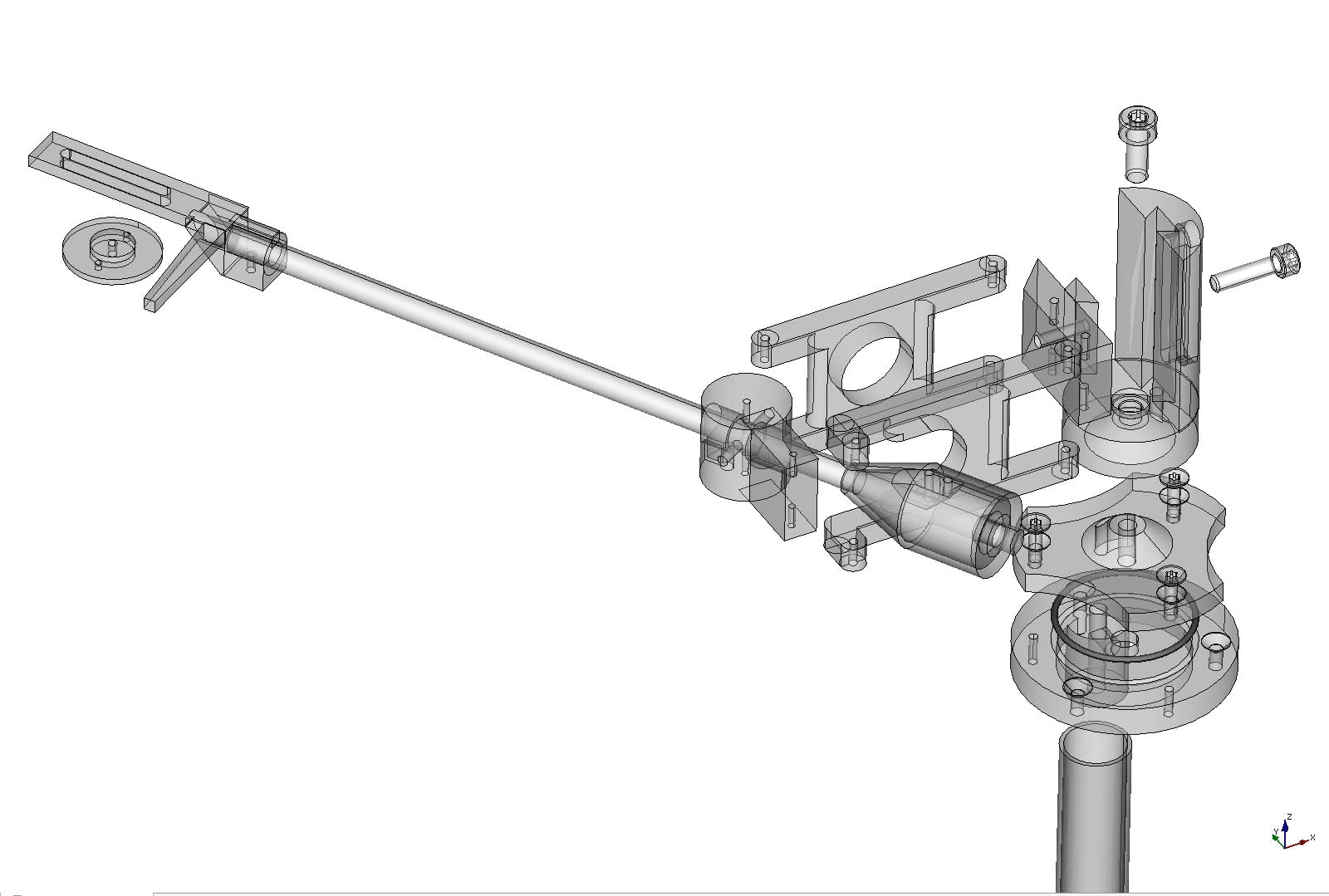

3DTOY PLT - how to do
attachnents
geometry (download the free program "Linkage 3. ")
STL mesh files of the individual parts, to be printed
bill of materials
wand - 6x5 mm tube (carbon or aluminum)
screws: 6 - 3x12 mm; 1 - 4x12 mm; 1 - 5x12 mm
grains: 2 - 3x4 mm steel
bearing's grains: 10 - 2,5x5mm brass (make a conical seat with a 2mm centerdrill)
ballpen tips: 10 - 2x10 mm refills
O-ring: 1 - 30x2mm
CW - 100 gr - 2mm lead shots
advice - try to get the best possible printing, with nozzle < 0.3 - A better finish is obtainable with SLA printing, or with boring post processing - but this unusual toyish appearence, for a tonearm with such sofisticated geometry (Birch-Dtut doublearm), is not so bad, imho.
Parts are designed with no clearance to get a tight fit, so deburring and adapting are needed. Pilot holes must be accurately reamed or threaded to size - this arm is all in his articulations, which is up to you.
disclaimer - this is not a kit, just a non-commercial project for lazy diyers. Mine works fine, smoothly and with no chattering, and the same must do yours, if you'll use a bit of your skill.
carlo
P.S a special thank to my friend's advices and patience, since printing takes much more time than making by hands.

Hello nocdplz, working means you intalled it on a turntable, and played LPs with it? There is no skating force indeed? How did you realize the bearings? Nice work BTW, a GB is on the horizon 🙂
