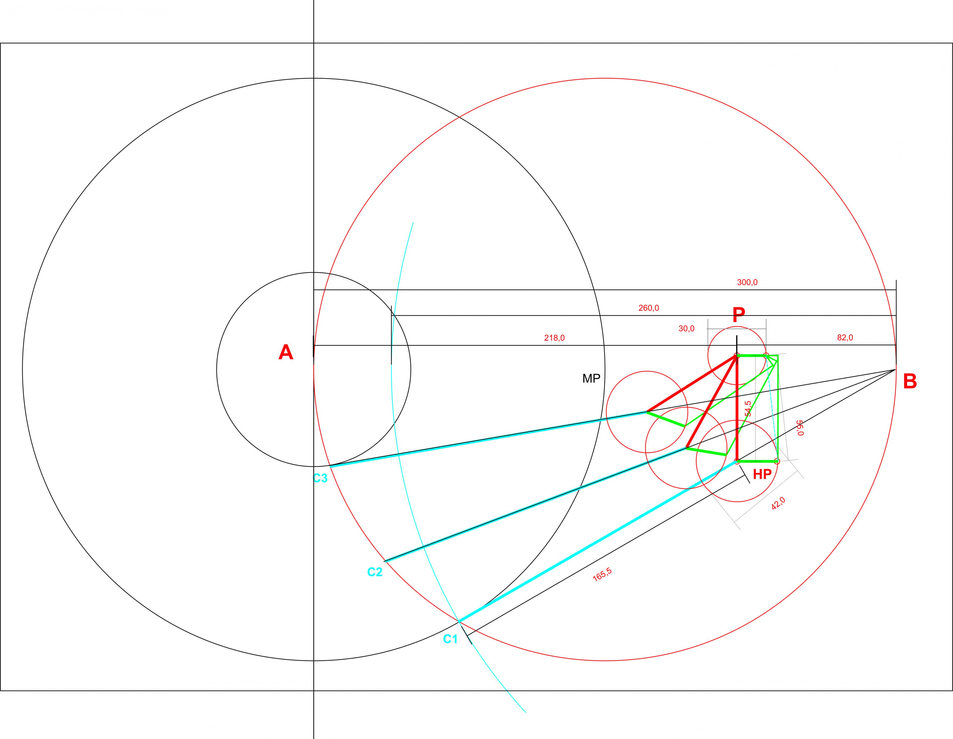

Thanks, but it's not a new project, Doug: it's exactly your dual pivot.
What I wanted to do was to avoid the use of ball bearings that never brought me to really good sounding results: so slowly I went back where I started from to invent the Rabbit's pulleys.
The model is only a first sketch and this is the geometry (attachment)

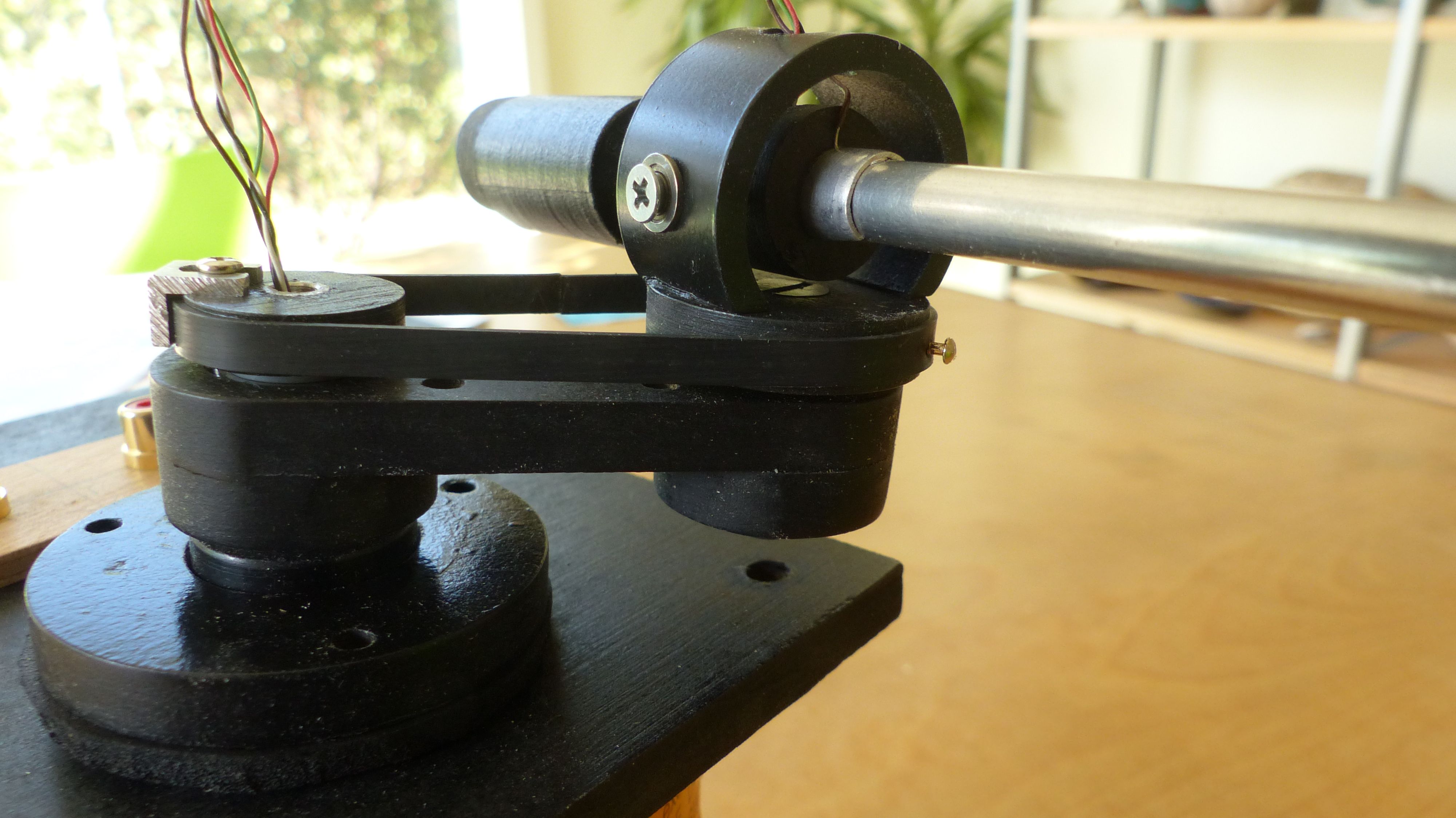

Pardon me. From pictures it looks like you have already done that.Hi Doug,
if you dont want to make hole in belt to keep it in place you can make tiny 'L' shaped clamp (Like this) to keep it in place and if seen from above it will also indicate position of pulleys.

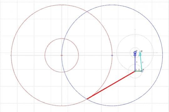

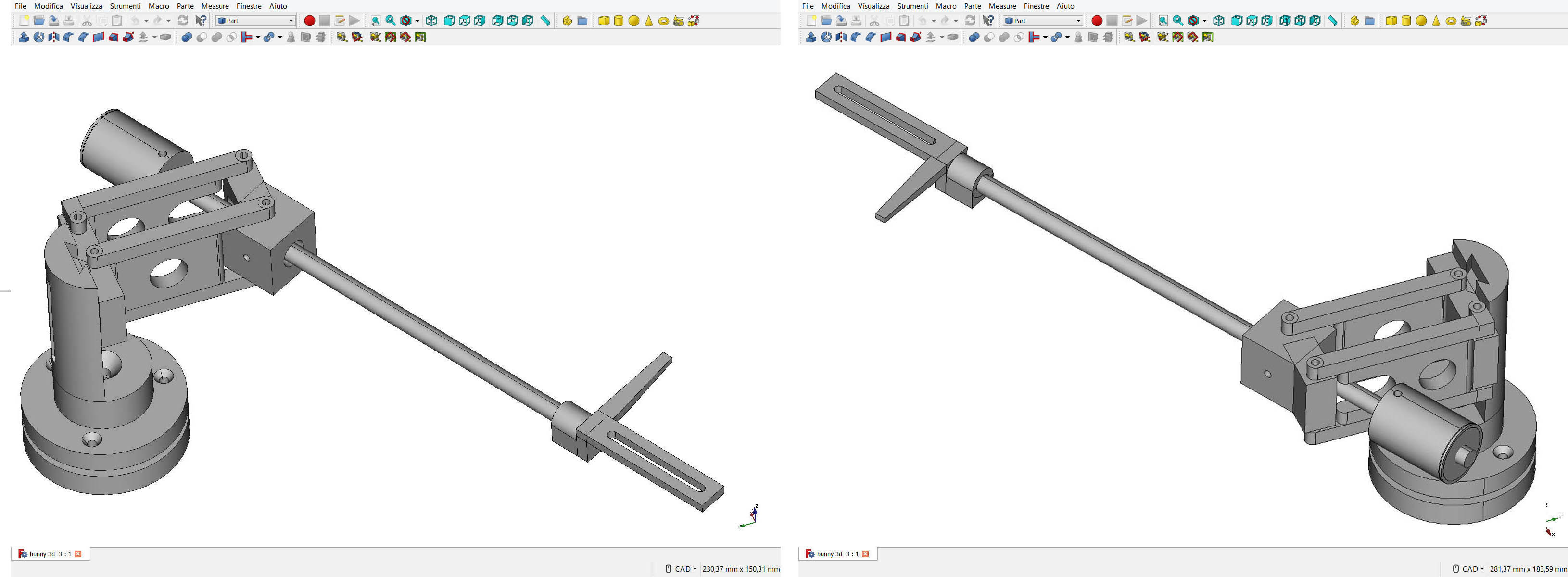

Printable Twin P - some steps
*.gif - geometry verified with linkage2, not so bad.
*.zip - Freecad 3d model converted to *.step format - editable with many free 3dcads and viewers.
problem: too rigid horizontal articulation (eccentric LPs)
next steps:
1 - compensations for shrinking? beveling?
2 - conversion to mesh, slicing, print settings .....test printing
completely unknown territory, for me
carlo

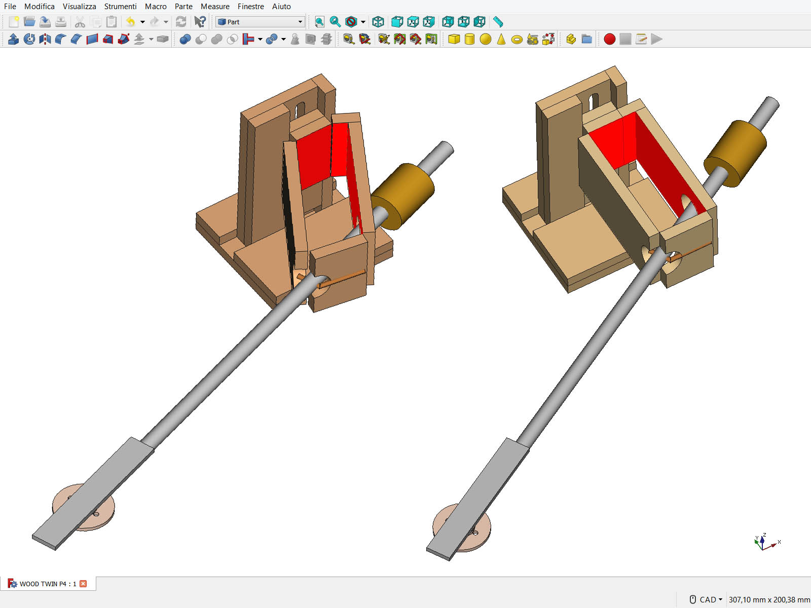

It could also be done this way, old-style: all wood. with articulations made with a ribbon of thin fabric glued with vinyl. (highlighted in red). Hoping that my friend Doug will like it, and Nanook too...
Simplifying is the real fun.
